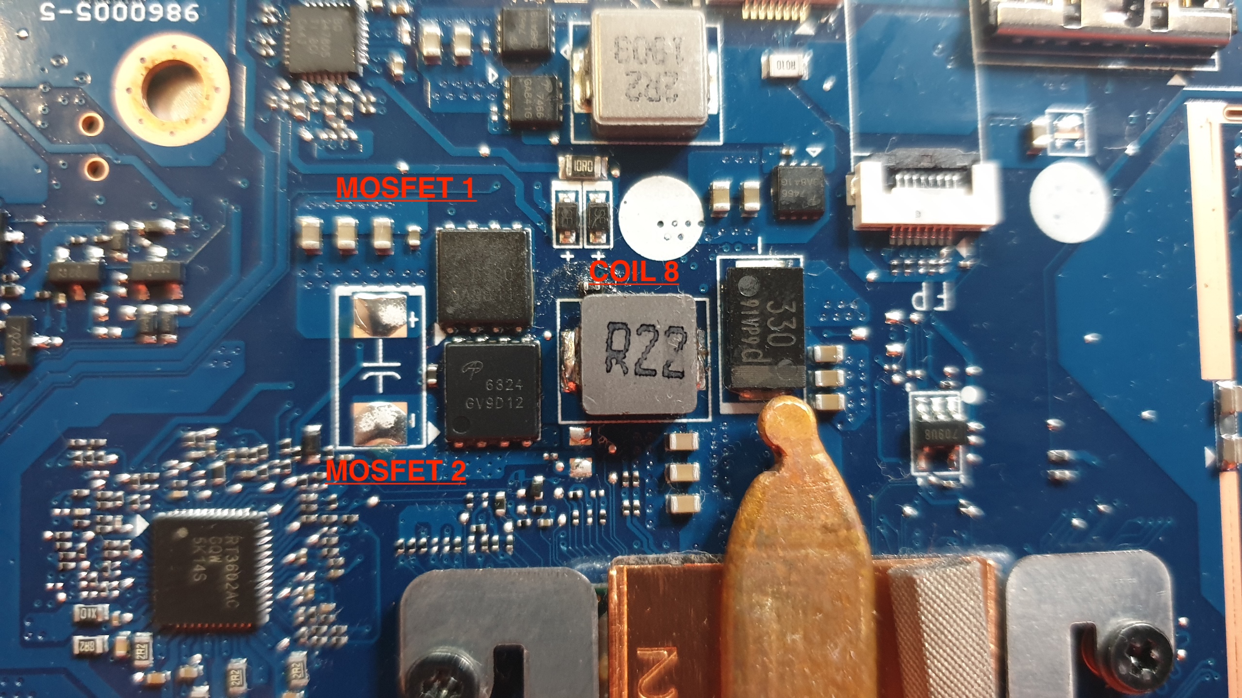

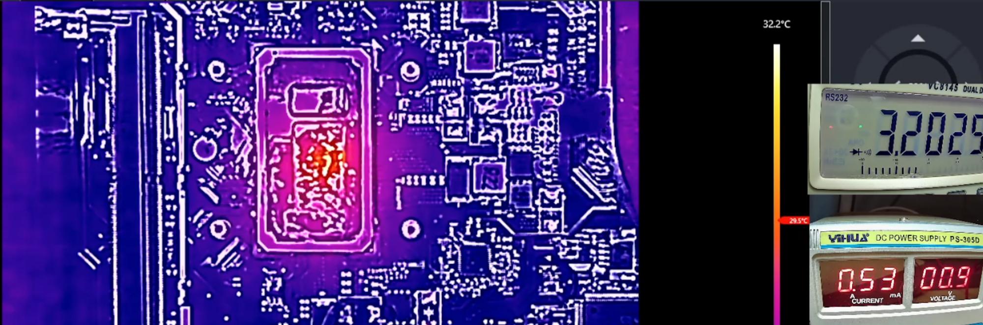

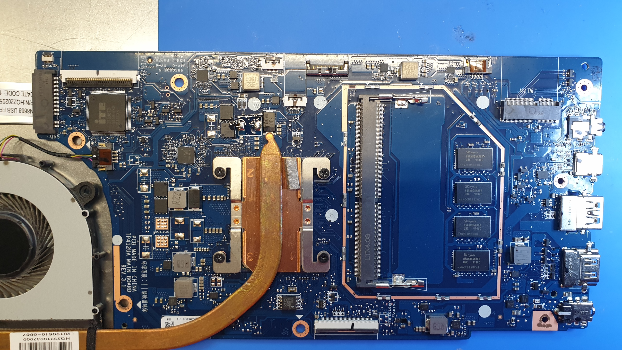

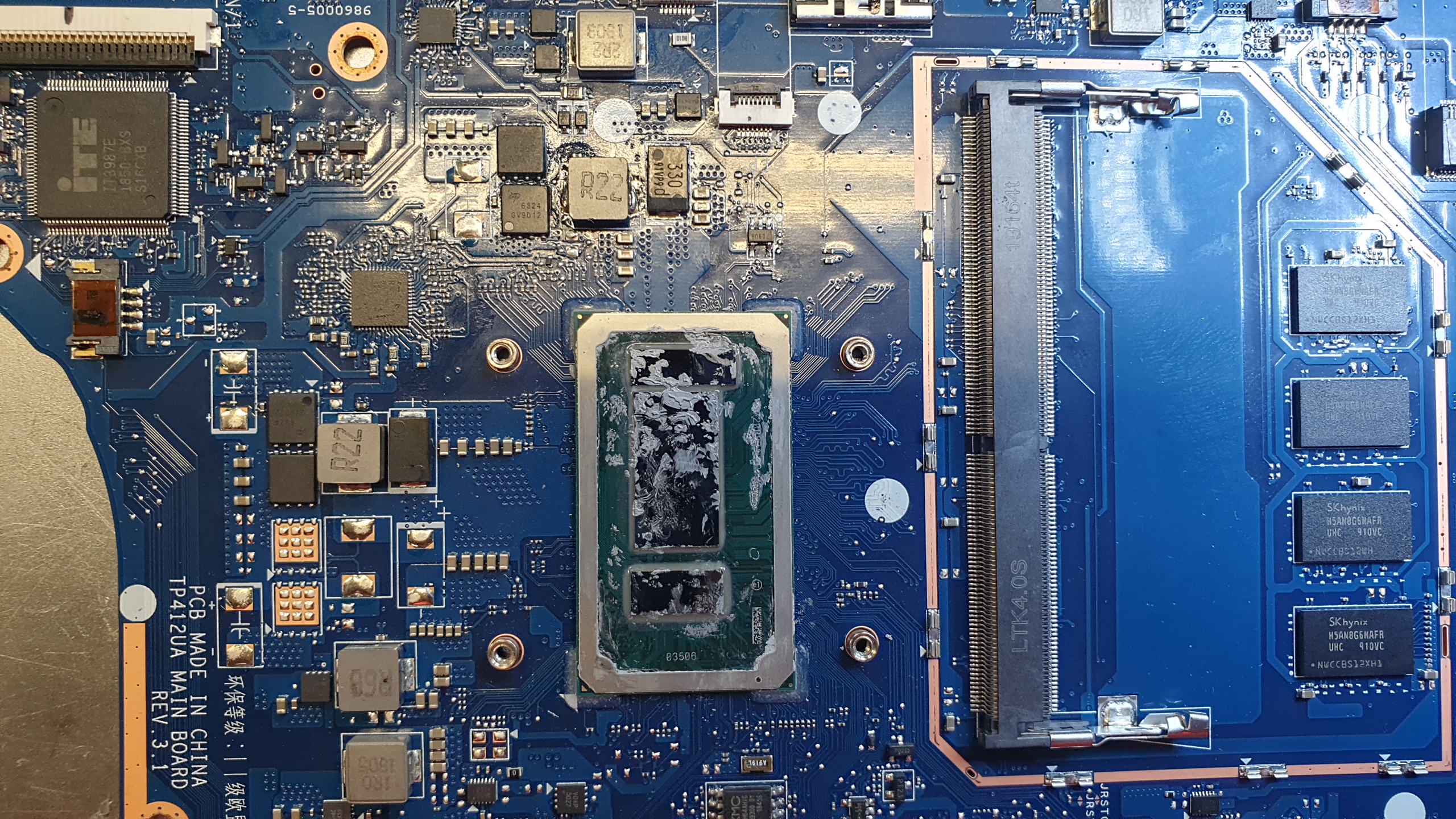

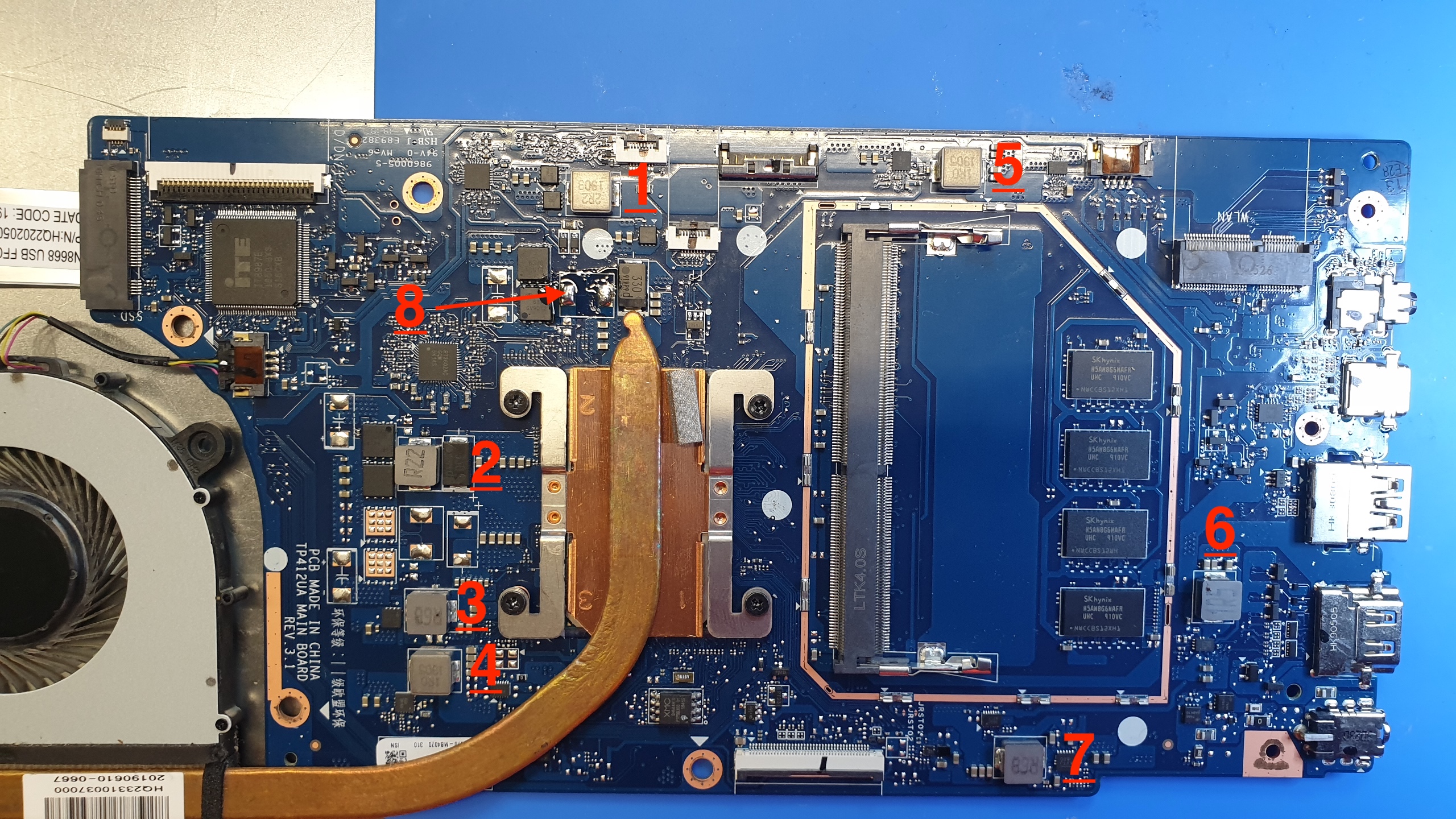

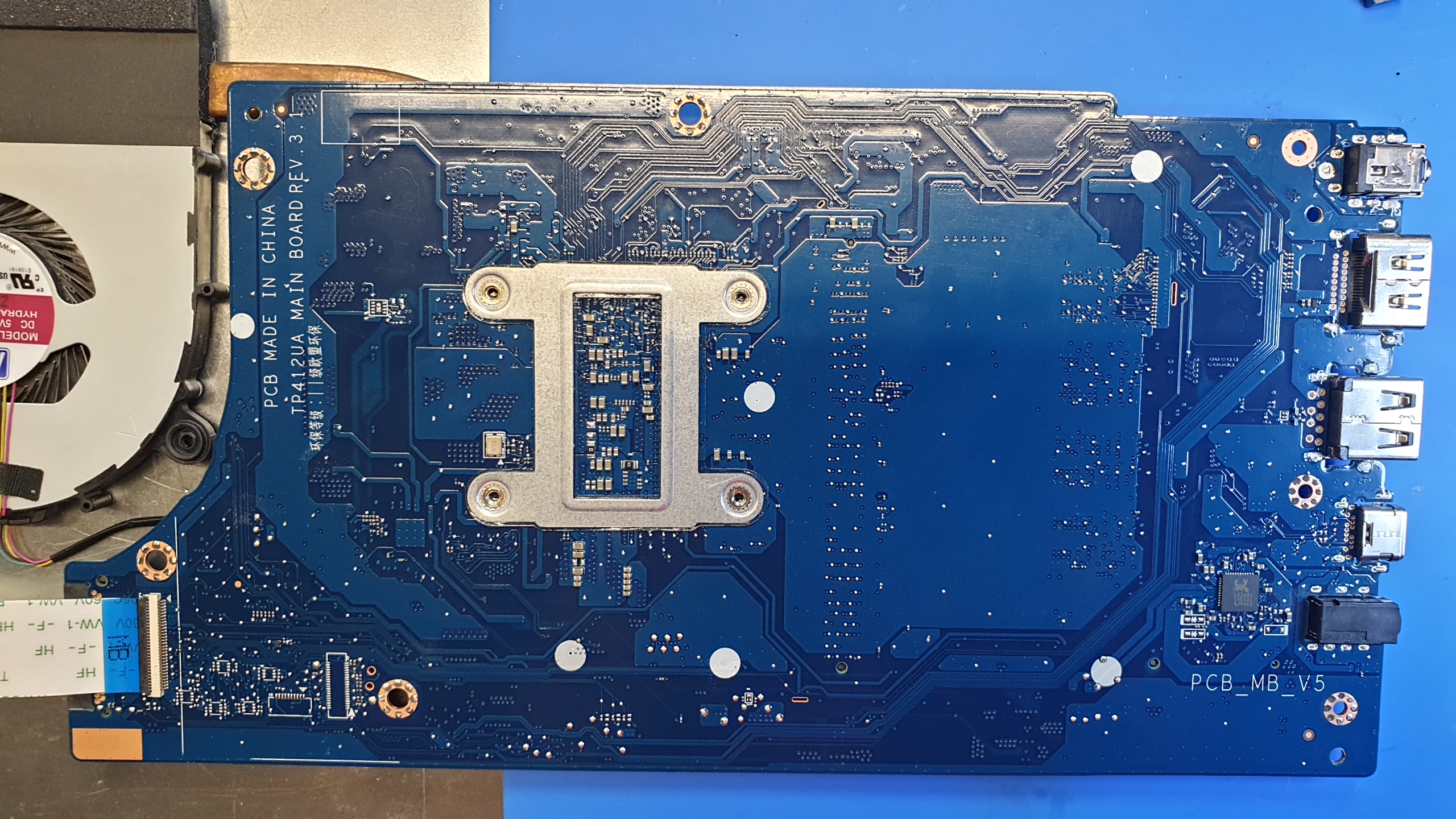

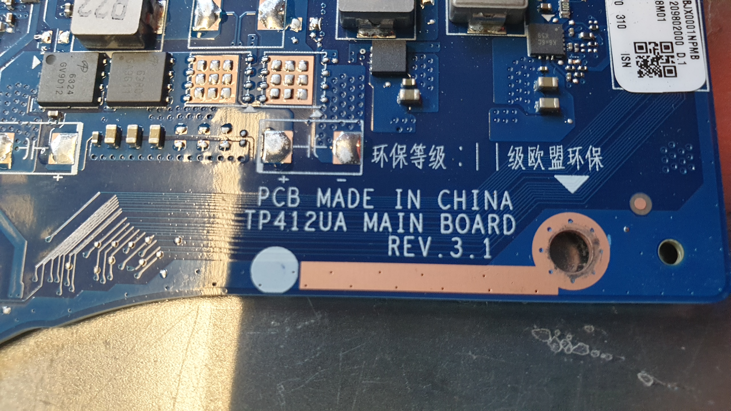

ASUS TP412UA GPU or CPU not turning ON
  • sikocan
    • Oct 2019
    • 344
    ASUS TP412UA GPU or CPU not turning ON
    Hi all this relates to the issue where the computer turns on but nothing else. The only coil not getting power is COIL Numbered 8. I have provided as much details as possible and images as well and also link to the post where initially I thought it's a BIOS problem, maybe it is, the last COIL is not being turned on.
    Original post to BIOS with full details are on this link:
    https://www.badcaps.net/forum/showthread.php?t=93187
    NO Power or Battery os CMOS Battery
    COIL Ohms
    1 179k
    2 5.95
    3 8.2
    4 58
    5 19.17k
    6 70k
    7 273
    8 1.85
    DC Jack in Turned Off No Battery
    COIL Voltage
    1 0
    2 0
    3 0
    4 0.999v
    5 3.33
    6 5.15
    7 0
    8 0
    DC Jack in Turned On No Battery
    COIL Voltage
    1 8.4
    2 0.94
    3 0.78
    4 0.997
    5 3.33
    6 5.15
    7 1.2
    8 0
    COIL 8
    Leg left 4.35k
    Leg right 3.22
    COIL 8's MOSFETS OHM Readings
    MOSFET 1
    Gate to Source 2.93
    Gate to Drain 1.74M
    Drain to Source 80K+
    MOSFET 2
    Gate to Source 4M
    Gate to Drain 4M
    COIL 8's MOSFETS V DC Jack In Not Turned ON
    MOSFET 1
    Drain 19.17
    Source 0
    Gate 0
    MOSFET 2
    Gate to Source 0
    Gate to Drain 0
    Power injected to LEG 2 of COIL 8 and middle section of the GPU/CPU gets hot which I suspect is normal as that's where the power is going and connected to.
  • sikocan
    • Oct 2019
    • 344
    Re: ASUS TP412UA GPU or CPU not turning ON
    More pictures uploaded.
    • paulo66
      • Dec 2020
      • 88
      • Portugal
      Re: ASUS TP412UA GPU or CPU not turning ON
      Hello, are you sure about the resistance readings re left right legs to ground? Looks like coil 8 might be open.
      • sikocan
        • Oct 2019
        • 344
        Re: ASUS TP412UA GPU or CPU not turning ON
        Another member on Discord forum of Electronic Repair School, Seeker, pointed out that the Gate to Source on High Side Mosfet 1 is not normal. I pulled them both out, although they work well for example when I put my finger on it to reset, they reset, I apply positive V to gate and Drain and the Drain to Source opens however when I attempt to get Resistance readings it's all random and most times I can not get a reading for both of them and mainly for Source and Gate. I do get readings for Source to Drain in closed position of 2.8M ohms but never a reading for the GS on either of them or Gate to Drain.
        I'll have a go at replacing them tomorrow.
        COIL 8
        Leg left 4.35k - This goes to the Mosfet
        Leg right 3.22 - This goes to the CPU/GPU area.
        • sikocan
          • Oct 2019
          • 344
          Re: ASUS TP412UA GPU or CPU not turning ON
          MOSFET 1 and 2 are reading O.L in 200ohms range for all legs, G>S G>D D>S
          Source to gate on the motherboard for MOSFET 1 location is 2.26k
          Last edited by sikocan; 02-22-2021, 06:32 AM.
          • paulo66
            • Dec 2020
            • 88
            • Portugal
            Re: ASUS TP412UA GPU or CPU not turning ON
            Look, a coil is nothing but a piece of enameled wire wrapped around an iron core. So it's basically a short-circuit for DC. The DVM ought to read continuity between both ends of the coil. Measuring their resistance to ground gives the same result as measuring two resistances in parallel. Unless of course there are two distinct grounds.
            • paulo66
              • Dec 2020
              • 88
              • Portugal
              Re: ASUS TP412UA GPU or CPU not turning ON
              OH I can see now in the first picture, you removed the coil prior to the readings. Sorry if I sounded patronizing.
              • paulo66
                • Dec 2020
                • 88
                • Portugal
                Re: ASUS TP412UA GPU or CPU not turning ON
                Are there any PWM signals at pins 4 of the fets?
                • sikocan
                  • Oct 2019
                  • 344
                  Re: ASUS TP412UA GPU or CPU not turning ON
                  Hi Paulo,
                  I'm sorry I made it look confusing, at time of deciding to take more measurements I had the coil out, I did it put it back. Pin 4 does not have a voltage hence the mosfet not turning on, if it did, MOSFETs would work well as they do outside the circuit. I don't know where this Pin 4 of the MOSFET goes, I'm assuming your pointing to Gate. I don't really want to run a wire source to drain as that would push 19v through from the Drain.
                  • paulo66
                    • Dec 2020
                    • 88
                    • Portugal
                    Re: ASUS TP412UA GPU or CPU not turning ON
                    Yes, pin 4 = gate. I believe these fets are not being used here where Vin = Vout. Instead, they are switching on and off at very fast rates to convert the 19V at the drain of MOSFET1 to a much lower voltage. The coil reacts to AC, the higher the frequency, or the rate at the voltage changes, the higher the reactance. This AC is a series of pulses. You have to use an oscilloscope or a logic probe to detect their presence. If the pulse trains are arriving at the gates, most likely one or both fets are faulty. If not, maybe there´s a fault in the controller that sends the pulses, or a cut in the tracks or, maybe it´s the BIOS that is not sending the right commands to the controller, or some "EC ready" is not arriving at the controller.
                    • sikocan
                      • Oct 2019
                      • 344
                      Re: ASUS TP412UA GPU or CPU not turning ON
                      Hi Paulo, I do have a logic analyser but not sure if it can handle voltage arriving to gate? I assume it's less then 5V? I'll check using logic analser today and take a risk and if it is arriving as you said, and mosfets are not working, then I'll replace them.
                      This style mosfet is new to me. Maybe before that in continuety mode find out where the gate is going on the board and see if there is a fault there.
                      • sikocan
                        • Oct 2019
                        • 344
                        Re: ASUS TP412UA GPU or CPU not turning ON
                        So I figured out that the High Side Gate is connected to Pin 25 of Richtek RT3602AC a triple channel PWM controller with integrated driver for the Mobile CPU Power Supply.
                        https://datasheetspdf.com/pdf/141224...tek/RT3602AC/1
                        I'll check with logic analyser today see what's going on.
                        • sikocan
                          • Oct 2019
                          • 344
                          Re: ASUS TP412UA GPU or CPU not turning ON
                          I have monitored the activity of the Gate with logic analyser, you are right sir, I did see pulses very very fast but only for a brief time when mosfets were OFF the system. I did replace the 2 mosfets with the exact same model from another laptop and the reaction is same no change. Only 2 options left which I still think it's a BIOS issue No. 1. or worse case is the Richtek RT3602AC which I doubt at this stage as it's a very busy chip and it's doing other things at the same time correctly hence it's able to turn and work with other mosfets in the system.
                          I have started uploading all my work so far onto Youtube and I'll update the link so you can see and have a better idea. Any other options?
                          It could even be the onboard RAM but I have no way of knowing how to disable it.
                          Last edited by sikocan; 02-22-2021, 07:12 PM.
                          • sikocan
                            • Oct 2019
                            • 344
                            Re: ASUS TP412UA GPU or CPU not turning ON
                            The video is now live:
                            https://youtu.be/SCqTQkvmqas
                            I suspect ram or bios.
                            • piernov
                              • Jan 2016
                              • 4439
                              • France
                              Re: ASUS TP412UA GPU or CPU not turning ON
                              https://logi.wiki/index.php/User:Pie..._I_solve_it.3F
                              The iGPU core voltage is almost never relevant. It typically only comes up when there's a significant load on the iGPU. It can often be seen spiking a couple of times on the oscilloscope when POSTing.
                              In other words, it's generally normal that it's missing. If you have some kind of issue with the machine, the cause is most likely elsewhere.
                              • sikocan
                                • Oct 2019
                                • 344
                                Re: ASUS TP412UA GPU or CPU not turning ON
                                Then it's the ram last resort.
                                • sikocan
                                  • Oct 2019
                                  • 344
                                  Re: ASUS TP412UA GPU or CPU not turning ON
                                  I did see the spike/initial working stage using Logic Analyzer, the PWM controller was sending rapid pulses, this happens at turn on time very briefly, not detectable using multi Meter. It's Also in the video.
                                  • piernov
                                    • Jan 2016
                                    • 4439
                                    • France
                                    Re: ASUS TP412UA GPU or CPU not turning ON
                                    If it's not POSTing (caps lock key not triggering caps lock LED for example), I'd try a few BIOS as usual. Not that the vietnamese website is a reliable source but it has a good bunch of dumps.
                                    • sikocan
                                      • Oct 2019
                                      • 344
                                      Re: ASUS TP412UA GPU or CPU not turning ON
                                      I've tried 1 here and 1 of my with cleaning. I've got same model working coming on Wednesday next week, but until then I wish to be able to fix this.
                                      • sikocan
                                        • Oct 2019
                                        • 344
                                        Re: ASUS TP412UA GPU or CPU not turning ON
                                        Bios flashing fixed. Found one on the net, it worked but 30 sec delay and didn't detect ram. I have fixed those in the attached cleaned me region for others to use.
                                        Bios moved to "Bios requests ONLY!" section - https://www.badcaps.net/forum/showpo...85&postcount=6
                                        Last edited by SMDFlea; 02-23-2021, 07:48 AM. Reason: Bios moved to "Bios requests ONLY!" section
                                        • tofik
                                          MOSFET equivalent K8A60DA
                                          by tofik
                                          Hello guys,
                                          I have a shorted MOSFET K8A60DA with the following characteristics:
                                          Type Designator: TK8A60DA
                                          Marking Code: K8A60DA
                                          Type of Transistor: MOSFET
                                          Type of Control Channel: N -Channel
                                          Maximum Power Dissipation (Pd): 45 W
                                          Maximum Drain-Source Voltage |Vds|: 600 V
                                          Maximum Gate-Source Voltage |Vgs|: 30 V
                                          Maximum Gate-Threshold Voltage |Vgs(th)|: 4 V
                                          Maximum Drain Current |Id|: 7.5 A
                                          Maximum Junction Temperature (Tj): 150 °C
                                          Total Gate Charge (Qg): 20 nC
                                          Rise Time (tr): 25 nS
                                          Drain-Source
                                          07-19-2023, 05:18 AM
                                        • Jane
                                          How do you test MOSFET in laptops ?
                                          by Jane
                                          I tried to use this method:
                                          Testing an N-channel MOSFET:
                                          Step 1: Discharge the Gate (turn off the MOSFET)
                                          Place the black probe (COM) on the Source (S) and the red probe on the Drain (D). The multimeter should show no continuity (high resistance or "OL" – open line).
                                          Then, touch the black probe to the Source (S) and the red probe to the Gate (G). This discharges any stored charge in the Gate, turning the MOSFET off.
                                          Step 2: Charge the Gate (turn on the MOSFET)
                                          Now, place the red probe on the Gate (G) and the black probe on the
                                          09-27-2024, 03:31 AM
                                          ASUS VivoBook TP412UA-EC056T Hybrid (2-in-1) Flip Specification for Upgrade or Repair
                                          This specification for the ASUS VivoBook TP412UA-EC056T Hybrid (2-in-1) can be useful for upgrading or repairing a laptop that is not working. As a community we are working through our specifications to add valuable data like the TP412UA-EC056T boardview and TP412UA-EC056T schematic. Our users have donated over 1 million documents which are being added to the site. This page will be updated soon with additional information. Alternatively you can request additional help from our users directly on the relevant badcaps forum. Please note that we offer no warranties that any specification, datasheet,...
                                          09-06-2024, 12:36 PM
                                          ASUS VivoBook TP412UA-EC193T Hybrid (2-in-1) Flip Specification for Upgrade or Repair
                                          This specification for the ASUS VivoBook TP412UA-EC193T Hybrid (2-in-1) can be useful for upgrading or repairing a laptop that is not working. As a community we are working through our specifications to add valuable data like the TP412UA-EC193T boardview and TP412UA-EC193T schematic. Our users have donated over 1 million documents which are being added to the site. This page will be updated soon with additional information. Alternatively you can request additional help from our users directly on the relevant badcaps forum. Please note that we offer no warranties that any specification, datasheet,...
                                          09-06-2024, 11:35 AM
                                          ASUS VivoBook TP412UA-EC064T Hybrid (2-in-1) Flip Specification for Upgrade or Repair
                                          This specification for the ASUS VivoBook TP412UA-EC064T Hybrid (2-in-1) can be useful for upgrading or repairing a laptop that is not working. As a community we are working through our specifications to add valuable data like the TP412UA-EC064T boardview and TP412UA-EC064T schematic. Our users have donated over 1 million documents which are being added to the site. This page will be updated soon with additional information. Alternatively you can request additional help from our users directly on the relevant badcaps forum. Please note that we offer no warranties that any specification, datasheet,...
                                          09-06-2024, 09:32 AM
