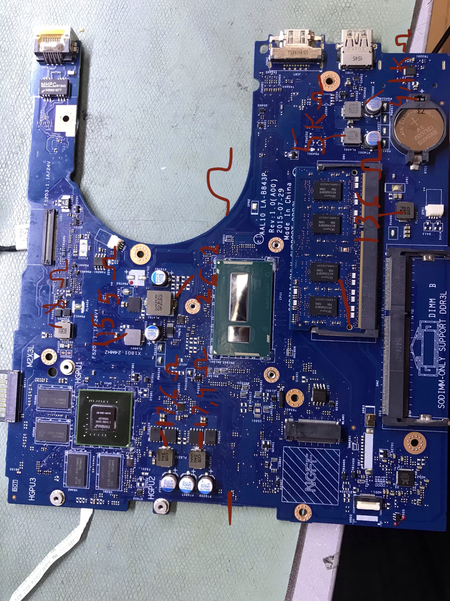

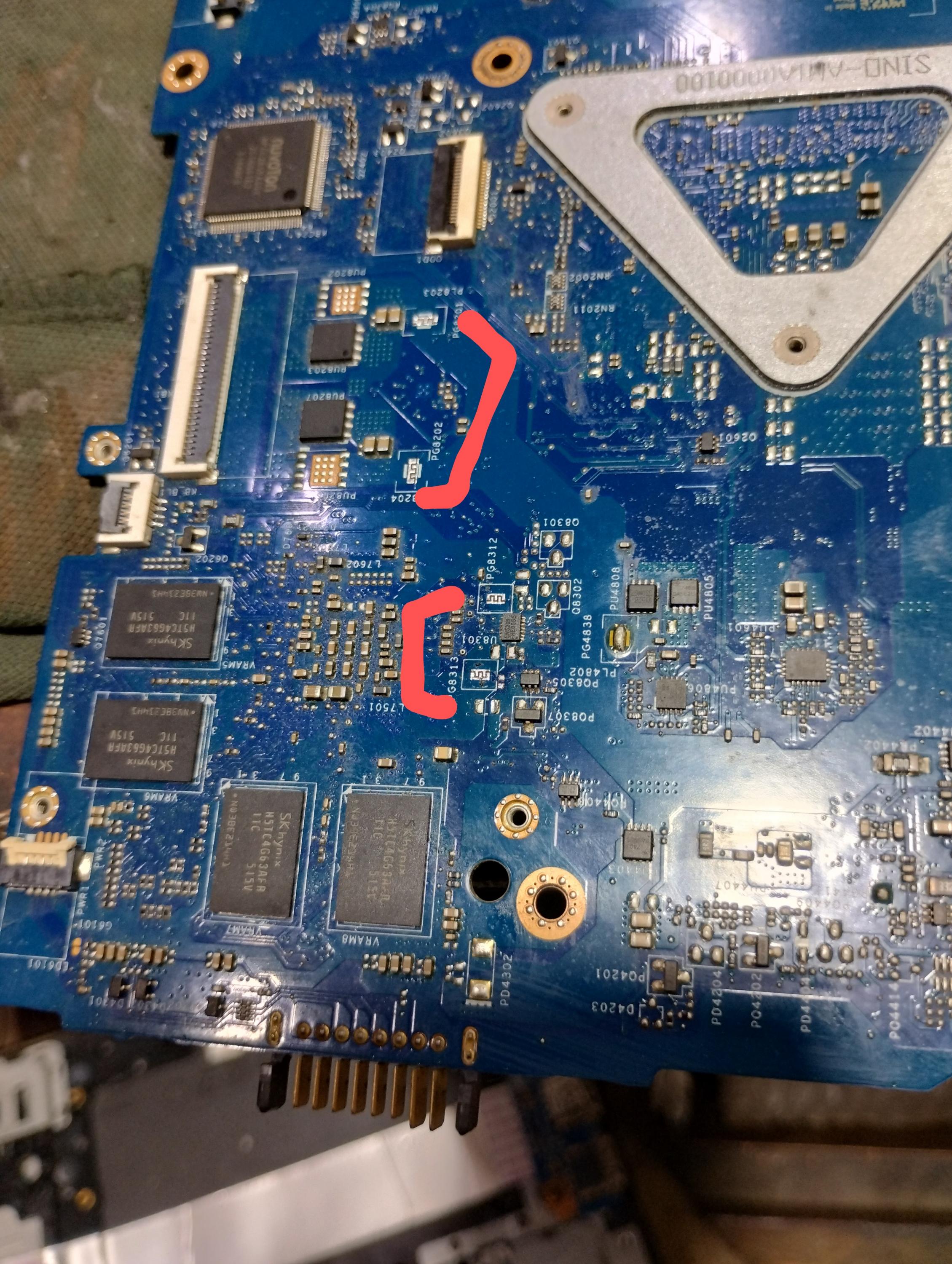

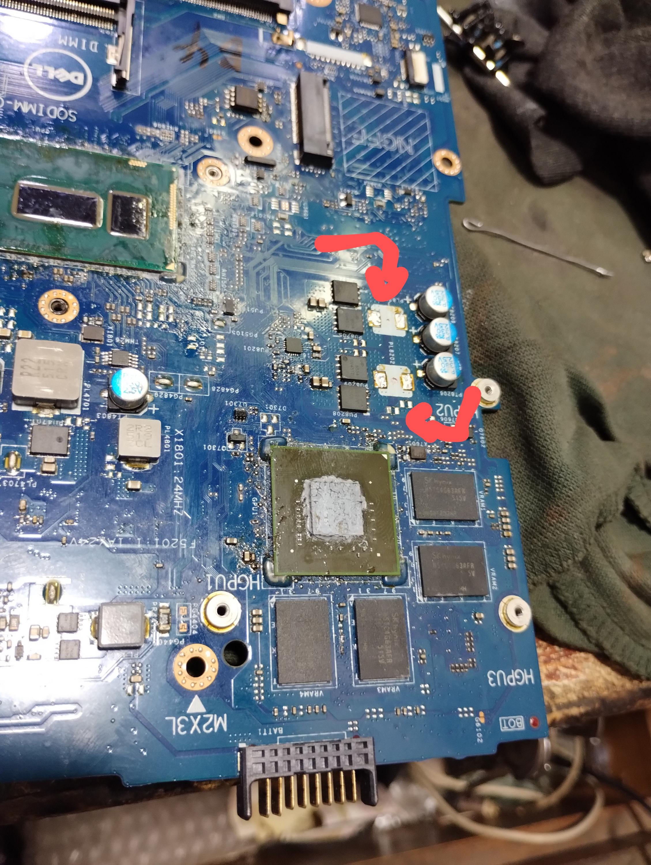

                                  • davidfrank77
                                    • Sep 2017
                                    • 21
                                    Re: Dell Inspiron 5558 AAL10 LA-B843P dis to uma
                                    Finally on this ways I got my problem resolved dis to uma display.
                                    Remove two coil one capacitor near to coil and four jumpers on back side.

                                      • teokarafou
                                        • Feb 2018
                                        • 32
                                        • Greece
                                        HELLO MY FRIEND,CAN YOU SHARE WHAT EXACTLY YOU DID TO USE DISAMBLE THE CPU?
                                        I DONT UNDERSTAND FROM THE PHOTO THE JYMPER YOU USED
