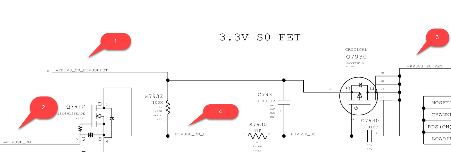

    Schematics PP3V3_S0 identifies the mosfet Q7930 6 Pin should have 4 legs 1,2,5,6 at 3.3 volts.
    Measuring zero volts on these legs
    Legs 3,4 are powered and measure 3.3 volts from the PP3V3_S5 and PP3V3S0_SS.
    Am I able to conclude that the mosfet is faulty and is the source of the problem.

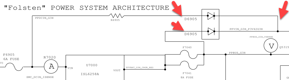

    What are the readings on each leg D6905?
    Also post the values for the 2nd attached graphic.

      Thanks Mon,I edited the post as I was stupidly reading the wrong schematic the rail PP5V_S0 at pin 1 on the fan connector reads zero volts..Will look at your thumbnail and come back...thank you
      • Joandaz
        • Feb 2021
        • 10
        Re: Macbook Pro A1297 Unibody 2009..No Power
        Originally posted by mon2
        Welcome.

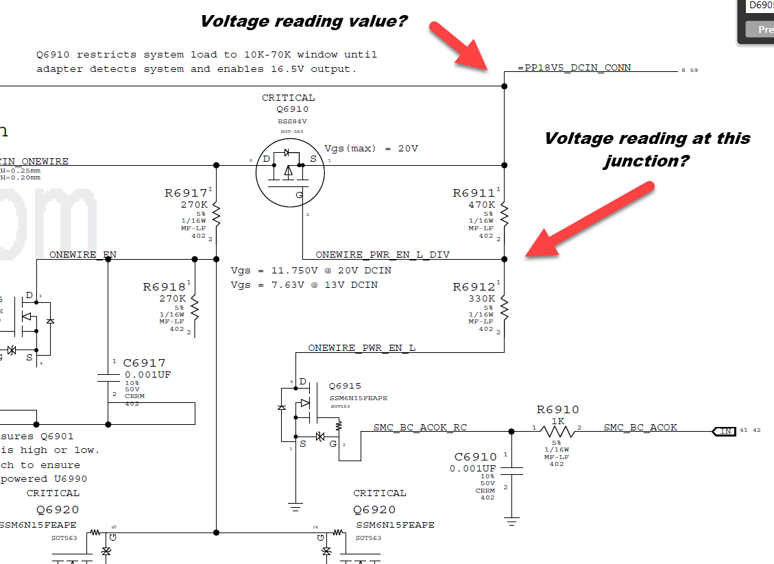

        Mon, thank you here are the measurements
        Diode D6905
        Voltage ground to leg 1 is 18.95v
        Voltage ground to leg 2 is 8.67v
        Voltage ground to leg 3 is 18.67v
        Resistor R6911
        Leg 2 of the resistor to test point TP1 PP18V5DC in onewire 11.08 V
        TP1 PP18V5DC to TP1 Onewire Pwr En L Div 19.1 V

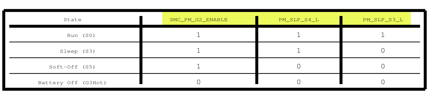

                            What are the voltage readings for the following rails (3 of them) as per attached table?
                            • Joandaz
                              • Feb 2021
                              • 10
                              Mon ..thank you again
                              PM_SLP_S4_L no voltage at Q7912
                              PM_SLP_S3_L 3.32 v at Q3801
                              SMC_PM_G2_EN 3.38 v at TP(1)SMC_PM_G2_EN
                              Directions out of the burrow please

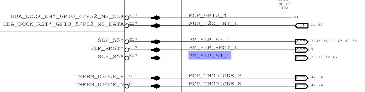

                                PM_SLP_S4_L appears to be linked to U1400. Wonder if that is defective but too early to tell.
                                Can you post the readings for the attached points of interest?

                                  Ouch U1400 doesn't sound pleasant. Dead CPU no bueno. Not worth repairing at that point. You could buy a no power logic board on eBay with a failed CAP for next to nothing and just replace the cap and have a working board.

                                    PM_SLP_S4_L should come up at the same time or before PM_SLP_S3_L.
                                    U1400 is the MCP.
                                    • Joandaz
                                      • Feb 2021
                                      • 10
                                      Mon little confusing between schematics and board view.
                                      PP3V3_S0_P3V3S0FET on the board view measured between R7932 PIN 1 and C7931 Pin 1 board view shows rail PP3V3_ S5 at these components
                                      If correct PP3V3_S0_P3V3S0FET location 1 measures 0 volts
                                      P3V3S0_EN Pin 5 Q7912 location 2 measures 0 volts
                                      PP3V3_S0_FET Pin 6 Q7930 location 3 measures 0 volts
                                      P3V3S0_EN_L location 4 measured between R7930 Pin 2 and R7930 Pin 1 measures 3.28 volts
                                      Trust this makes some sense
                                      Losing confidence my end
