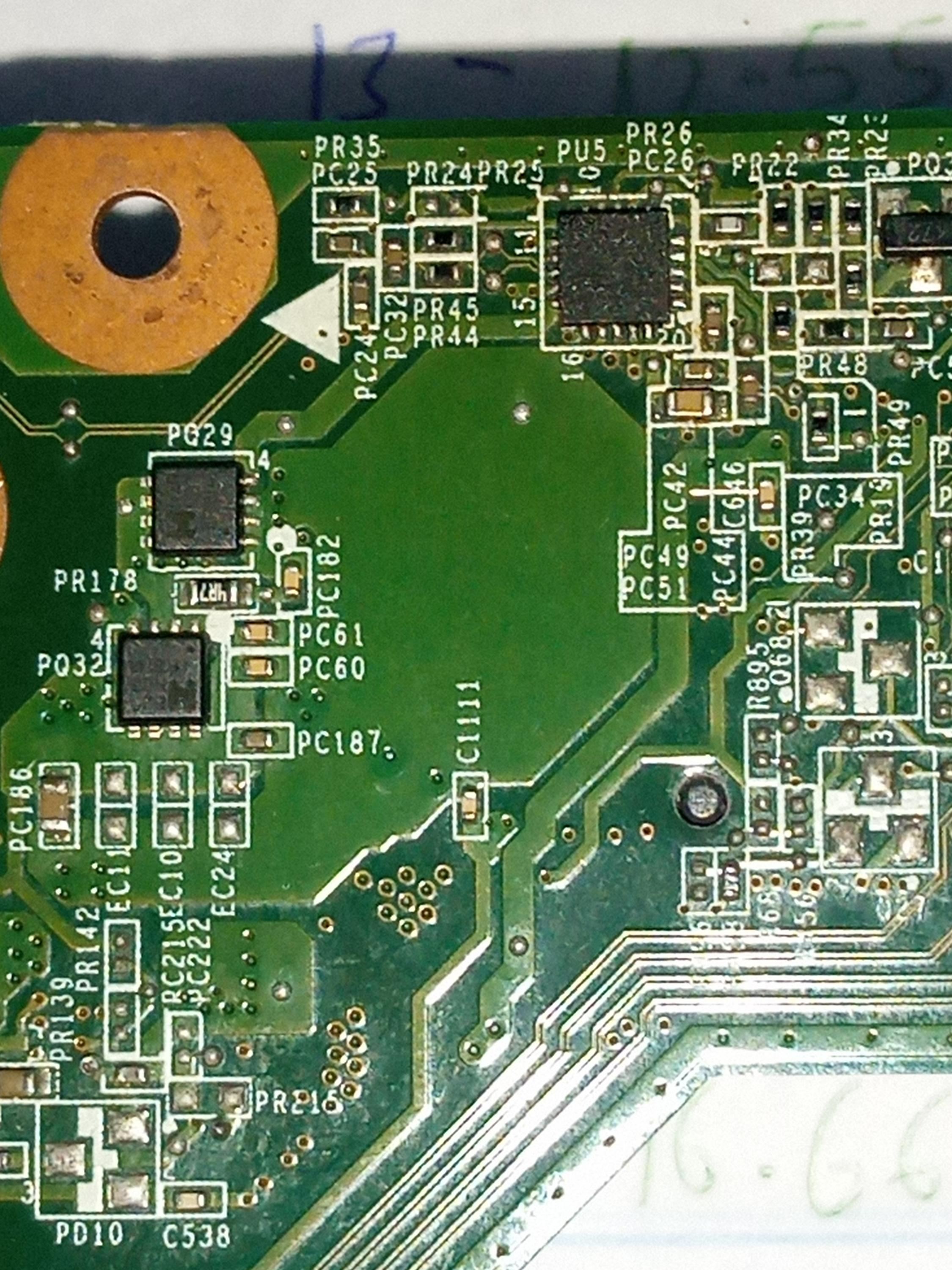

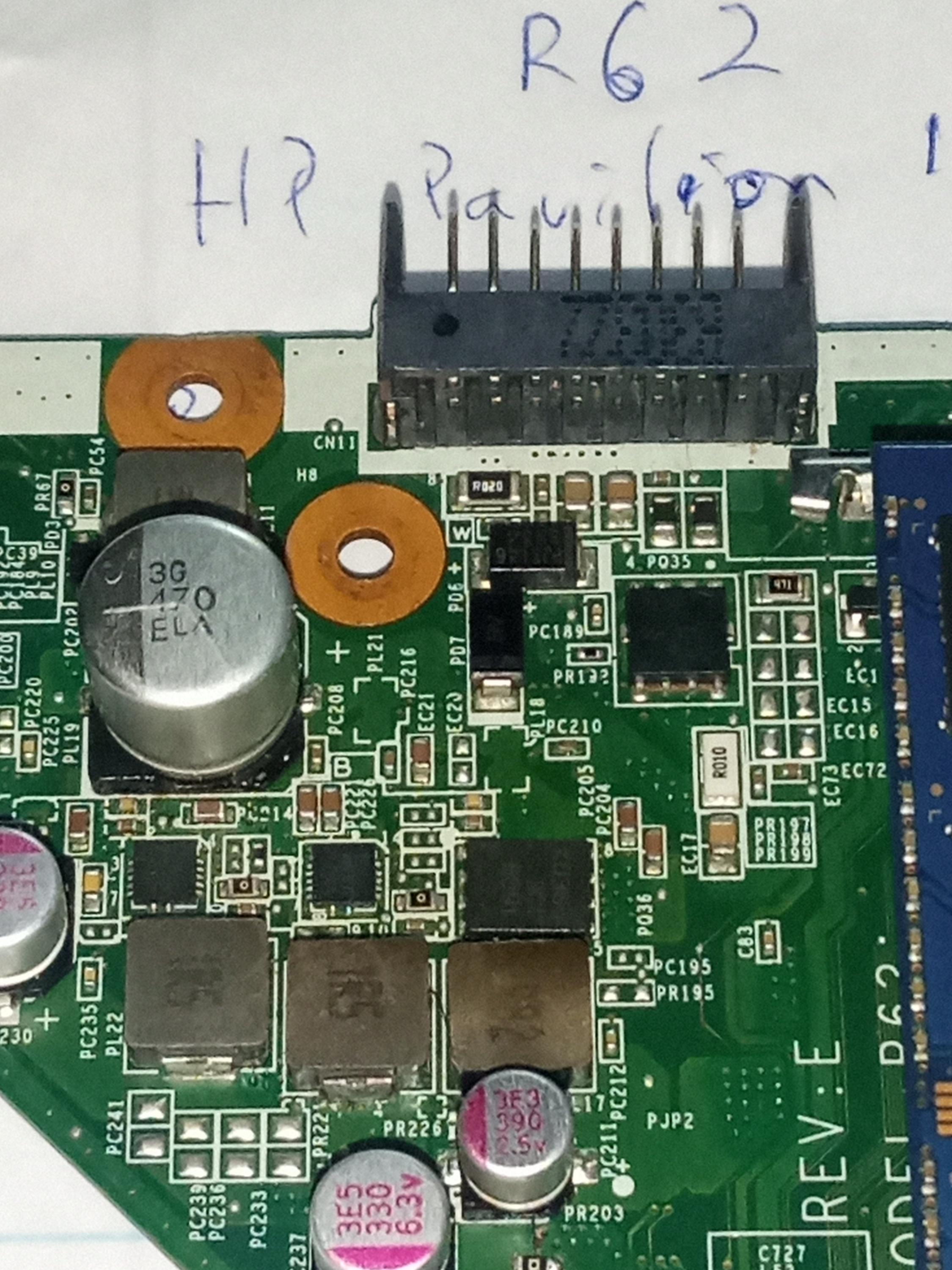

    Please, i need help with my HP Pavilion 15 (R62). It's not powering ON with the charger only. But it powers On and display with Battery and charger connected or battery Only connected.
    It charges the battery normally though.
    I noticed it gets abnormally hot around PL11 (Coil), PQ29 and PQ32. And there's a voltage drop at PL11. With battery and charger connected, my multi-meter reads 12.89 volts entering it from Charging IC (PU5) and 12.77v leaving it to +BATCHG.
    I've replaced PL11 and still same problem. I have also replaced PU5 just in case it might be faulty, yet no luck.
    I have attached my multi-meter voltage readings of PU5 and some additional pics.
    Thanks in advance.

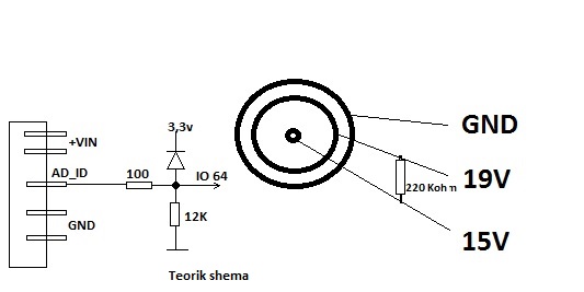

    Re: HP Pavilion 15 (R62) not powering on with charger
    find out AD_ID voltage on R499 R501 SIO pin 64 ?
      R499 = 0.46v
      R501 = 0.46v
      SIO pin 64 = 0.46v
        Originally posted by classicandy
        R499 = 0.46v
        R501 = 0.46v
        SIO pin 64 = 0.46v
        With a 45W charger AD ID 0.46V perfect did you try with a different charger is the DC jack light in on ?

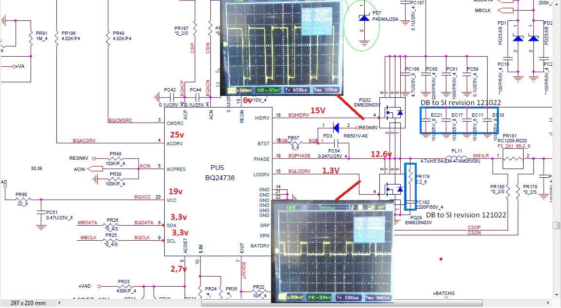

            Would you check
            I'm not happy to be so strong. because it's not humanly
              Originally posted by Sametbey
              Would you check
              In mine,
              Pin 15 = 1.88v
              Pin 18 = 16.66v
              The remaining pins are of the same values as the values in the picture you posted.
                      PQ35 Voltage on G-S-D??
                        Warming in the charging circuit will not be resolved with the Bios program. PQ35 is the battery switch, n-mosfet. With the adapter + battery there should be D 19v, S 12.6v, G 3.3v. When the adapter is removed, D 12.6v, S 12.7v, G 25v.
                        SIO pin 64 = 1,5v need to be
                          Voltage on PQ35
                          Without Adapter
                          D = 11.97V
                          S = 11.97V
                          G = 18.05
                          With Adapter
                          D = 19.66V
                          S = 12.68V
                          G = 12.67V
                            SIO Pin 64 @ 1.5v seems unlikely to me. 0.46v seems to be the right value for AD_ID using 45W Adapter usually on most HP Laptops
