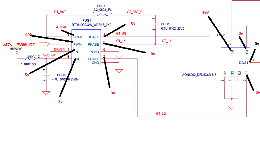

    Hello everyone, I have attached a diagram for Lenovo C340. I got one in the service with spilled fluids. Initially it was taken to another service where the BIOS was changed, of course it didn't work. The problem is that, although I bought the electronic schematic, I can't figure out why I'm missing + VCC_GT, 0V. If anyone can help me, I would appreciate it. Thanks.

    Re: Lenovo C340 El5c3 el531 el431 la-h101p_lo2 problem
    If ram section is ok check pin 20 of Pu 501
    Check vcc_sa voltage then
    vcc_core
    Vcc_gt is s0 state high voltage means full on laptop
      vcc_sa = 1.010 v
      vcc_core = 0.890 v

        Have you checked PUG1 and PQG1
          Check enable pin1 2.5 and pin 8 vcc 5v is coming at RT9610CGQW_WDFN8_2X2 which is generating vcc GT pug1
          En pin and vcc both are connected to power on reset logic inside ic and if one goes low output will be low
          If enable is low check driven_set is coming out correctly at voltage divider pr272 and pr275
              First check driven_ set at voltage divider pr275 and pr272
              Driven_set must be 2.5v check
              Then at core ic puz1 carefully check pin 35 voltage it is driven coming here
              Ic will start working when driven is available in threshold
                pin 35 = 5V
                  Check drven_,set at voltage divider
                  correction
                  prz72 and prz75
                  If 5v then floating is enabled to ps4
                    Check prg1 which is 2.2 ohm with 5 percent tolerance
                    Check pcg1 boot capacitor which is 0.1uf
                    Enable is ok , vcc ok but pqg1 gate is disabled because ugate supply is missing , boot is the supply for ugate mosfet ,boot supply is not reaching ugate .
                        No video signal, some liquid was spilled.
                        PRG11 - 2.5 ohm
                        PCG12 - 0.1 uF
                        prz72 and prz75 - I don't know where is on the board.
                        So, the conclusion is the PUG3 is defective because boot supply is not reaching ugate?
                          Try to Follow Pin 18 of PUZ1 to find them. They are connected on +5VALW/ Rail.
                                      Driven_set = 0V
                                        Driven_set 0 is ok because look in schematic @ sign at prz72 means resistor is not populated, only prz75 populated which is connected to ground
                                        Correct me if I am wrong
                                        Core voltage is ok , vccsa is ok
                                        Fault is around pug3
