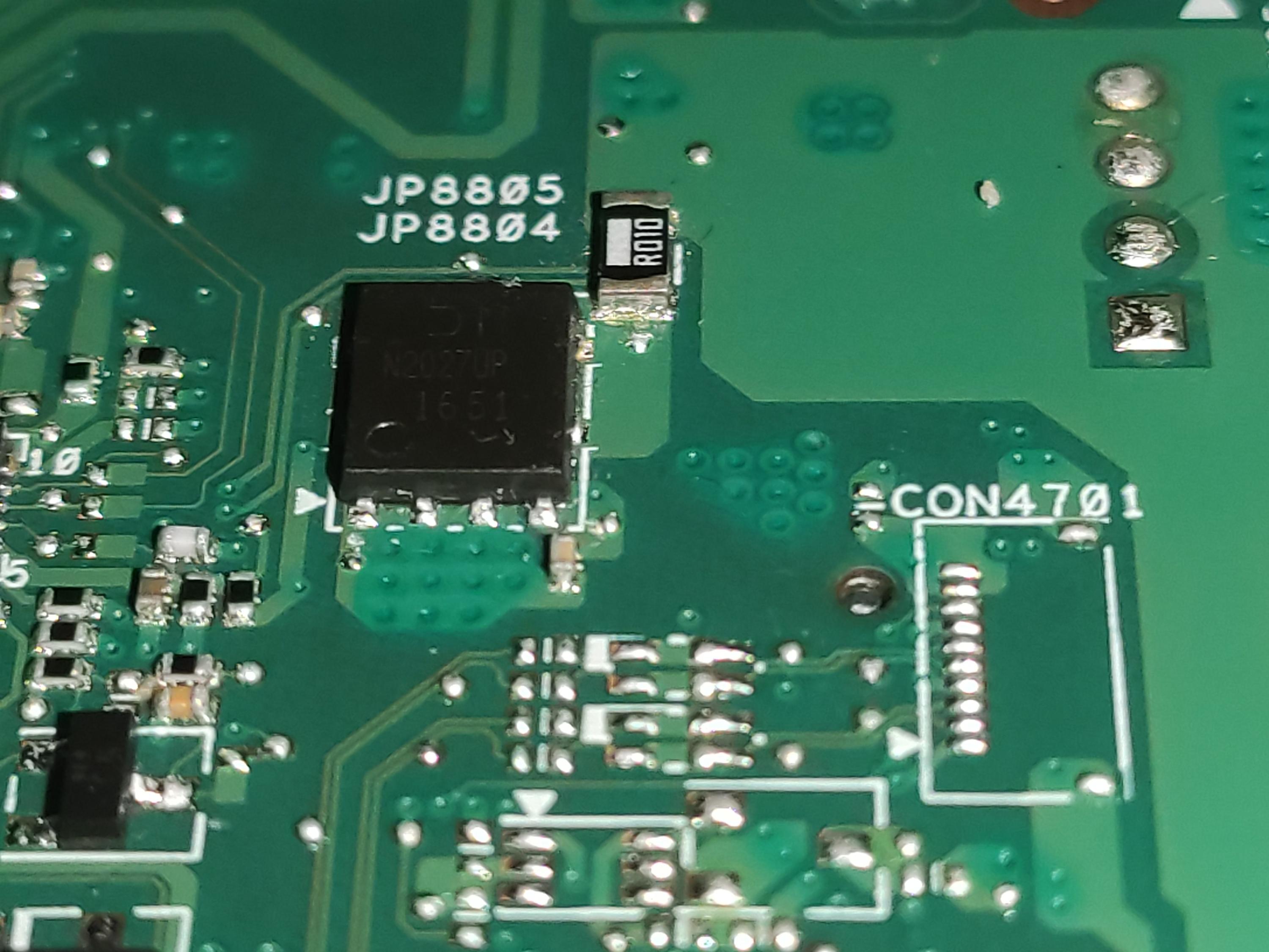

        Re: Medion Akoya E6435 no power
        I've been playing around to see if I can see anything odd and I may have come across something. Not sure.
        There is a chip (shown in attached screenshot) where 7/8 pins read the correct 19v on the multi-meter. However, the end pin at the bottom of the chip on the right-hand side reads 24V. It is the only pin on the chip with that readout. This is with the charger plugged in only.
        Does that sound normal? Is it meant to do that?
          If it's a mosfet , DC in mosfet 24 v is required at pin4 gate to switch on this mosfet for n channel so it is ok
