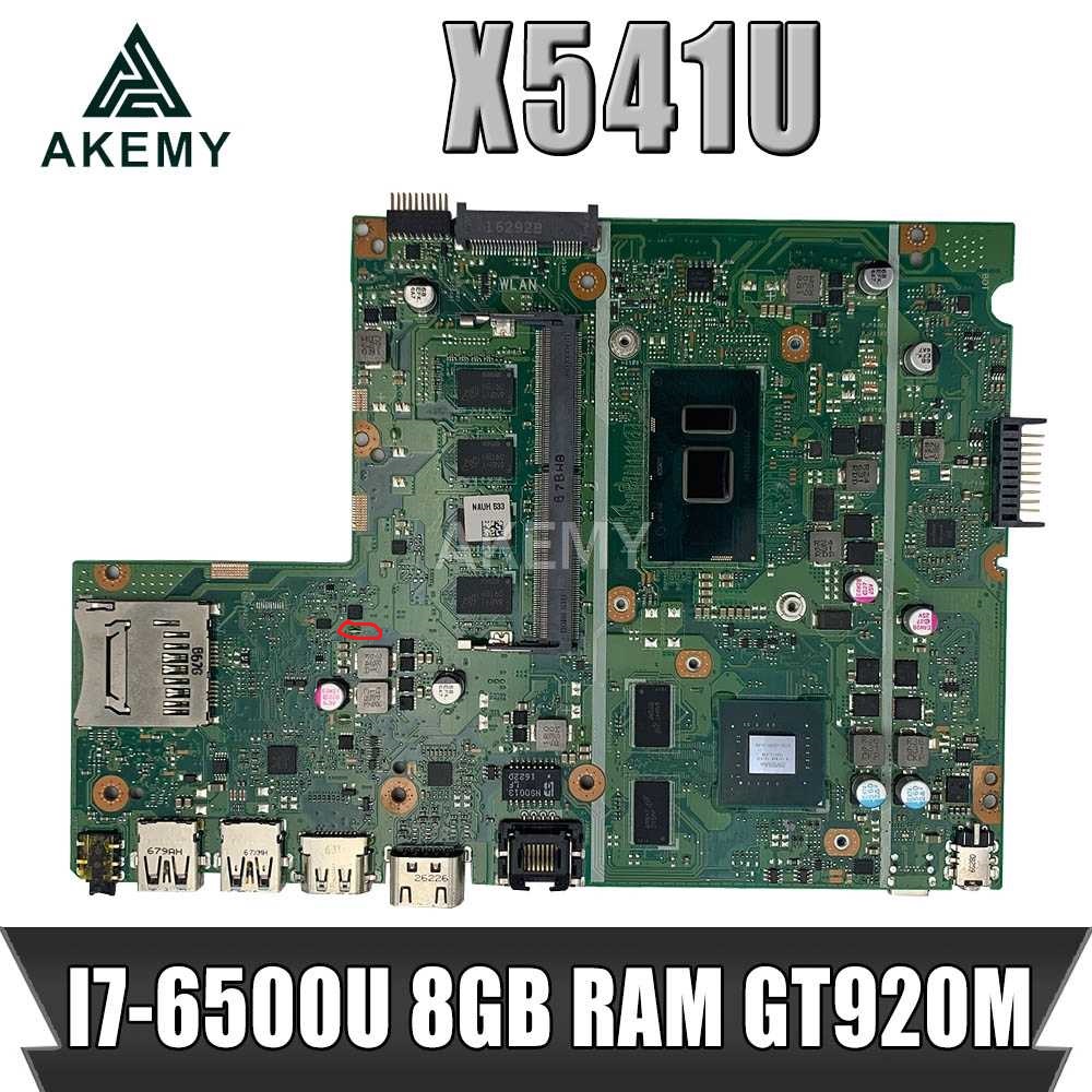

    Hello everyone. Hope you're all doing great in this crazy world
    I am an IT person, but not much of an electronics guy (actually not at all), so I need your help with finding the cause that's stopping this laptop from powering on.
    Luckily I've found the boardview of this particular board on this forum, so this should make things a little bit easier for me (and hopefully for you deciding to give me a hand). I'm also attaching it here in case someone else is troubleshooting the same board in the future.
    First things first, I confirm that:
    1. Power adapter is OK
    2. DC IN is OK
    3. First 4 fuses are OK
    4. Mosfet is OK
    By OK, I mean 19V is present
    But then, there is a resistor (PR8938) which seems to be connected all over the board. At this stage I am not sure how I should resume troubleshooting. I tried to trace all linked components to this resistor, and 19V seems to be present everywhere.
    Don't want to misguide you, but visual inspection shows just a little bit of corrosion on capacitor C5564. There is no voltage going through, not the USB chip it's linked to (U5505).

    what is the voltage on PQ8902 pin 4 & 3 after check PR8938 voltage ? PU8701 all pins

          the +3/+5V regulator is not working pin 8 voltage is low what is the voltage on
          PL8701 PL8702 voltage ? you have to check the resistance to GND on the 2 coils , what is the voltage SIO pin 85 ?

                            PU8701/2 low resistance there is a short on this part , remove one PAD of each Coils PU8701/2 & test again what side is short in Diode mode , remove C3003 & test out of the bed if it's short

                              remove the red marked jumper (clean with solder wick) and see if ic still get hot, if 3.3 and 5 volts comes on, see if resistance on coils has changed.

                                Yep, still frying eggs.

                                  Removed just one side of these coils, Pin2 of PL8701, and Pin1 of PL8702.
                                  So in diode (beep) mode:
                                  PL8701 pin1: beep
                                  PL8701 pin2: no beep
                                  PL8702 pin1: no beep
                                  PL8702 pin2: beep
                                  C3003 removed (coils still one pad off), in beep mode: beep on GND and no beep on +3V.
                                  I hope this is what you've asked for

                                    replace PU8701

                                      Will try to find a coil from a donor board. The problem is finding one that is exactly the same
                                      If I may ask, what makes you think PU8701 is the culprit and not PU8702 when the beeps result the same?
