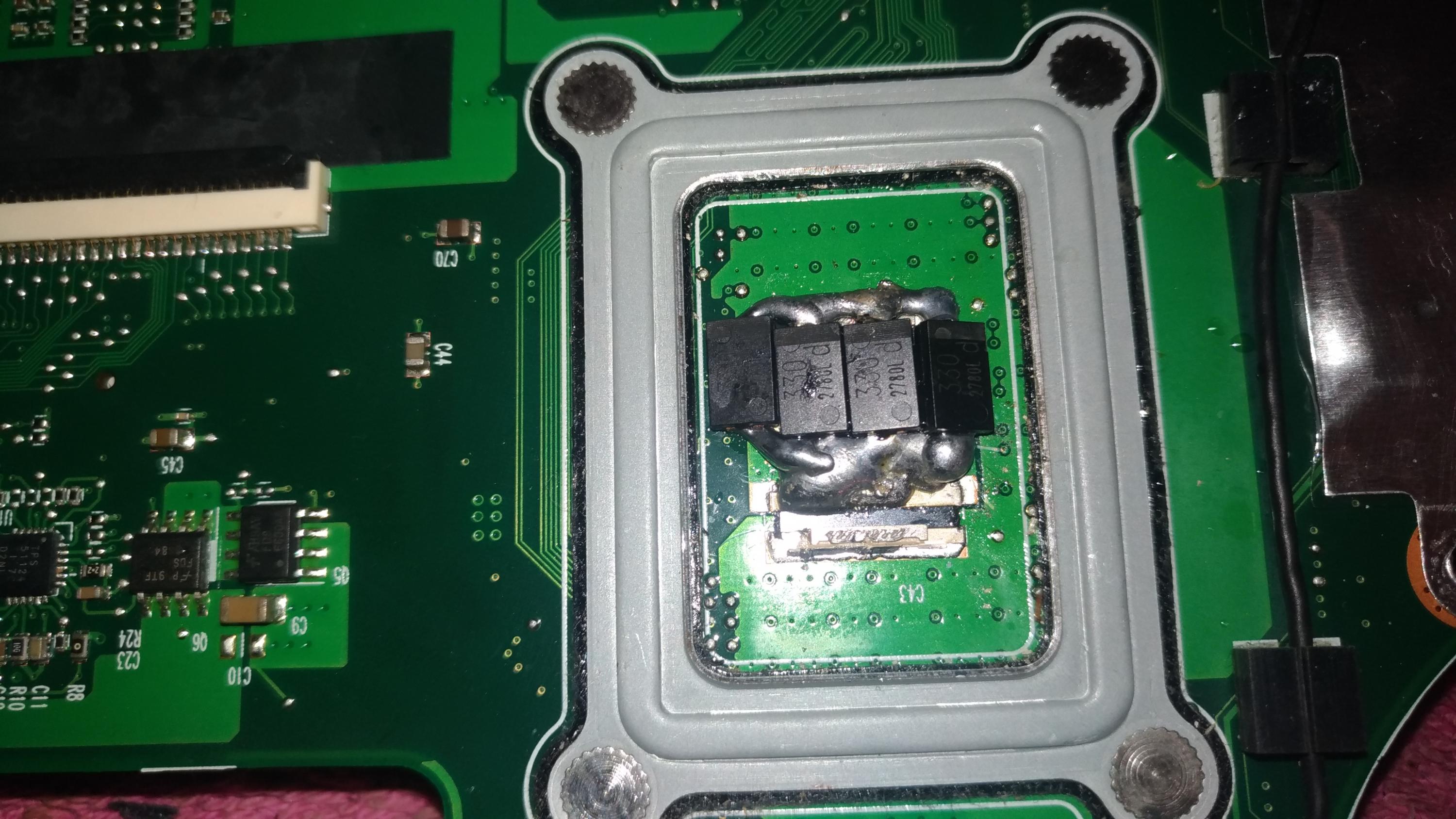

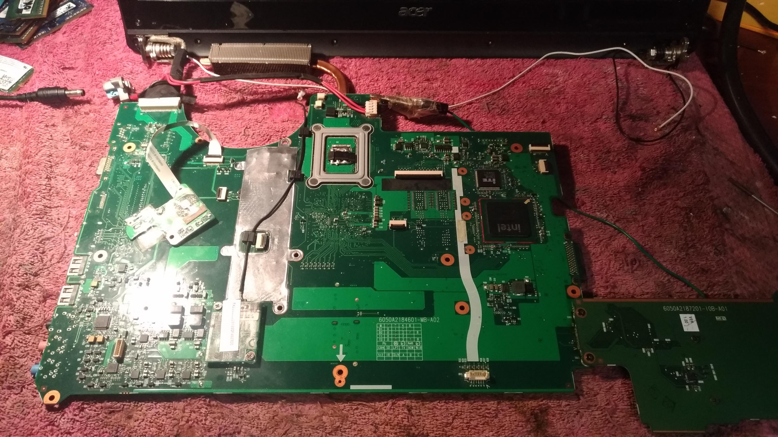

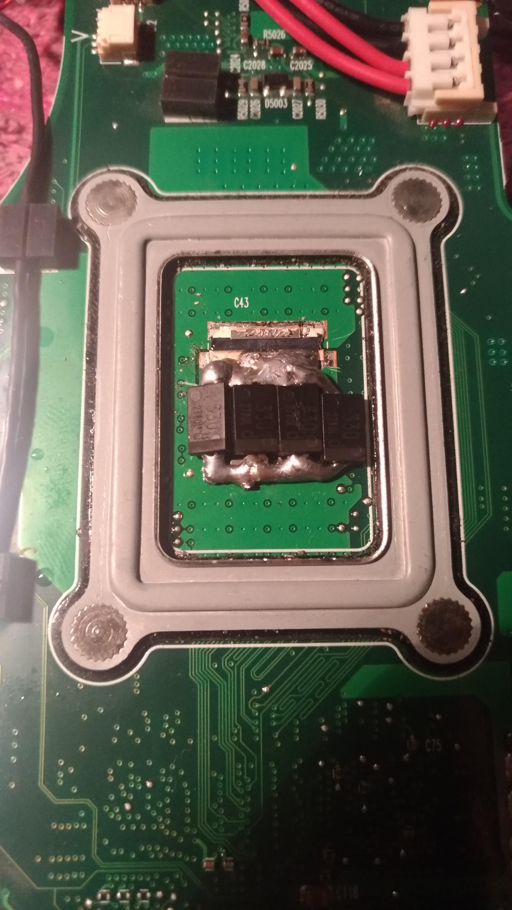

      Images:
      8920G:
      8930G

          Post picture of NEC Tokin replacement.
          VSSSENSE is connected to ground.

            pictures

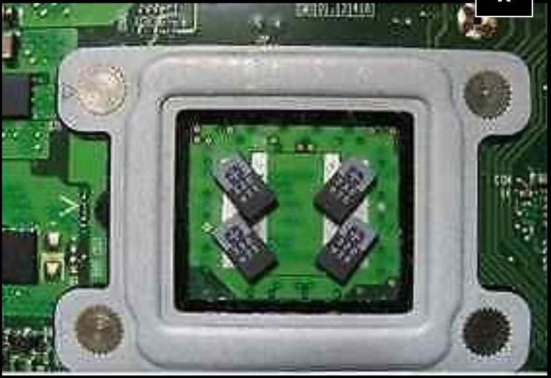

              Maybe i'm wrong but this doesn't Looks Like a proper replacement of an NEC Tokin, when i compare e.g. with the attached Pic...
              However i never did It so far...

                Re: Acer 8920g problem
                if you look at it from this angle. it shouldn't be a problem theoretically. He used 330ufs long. North should work on chip.
