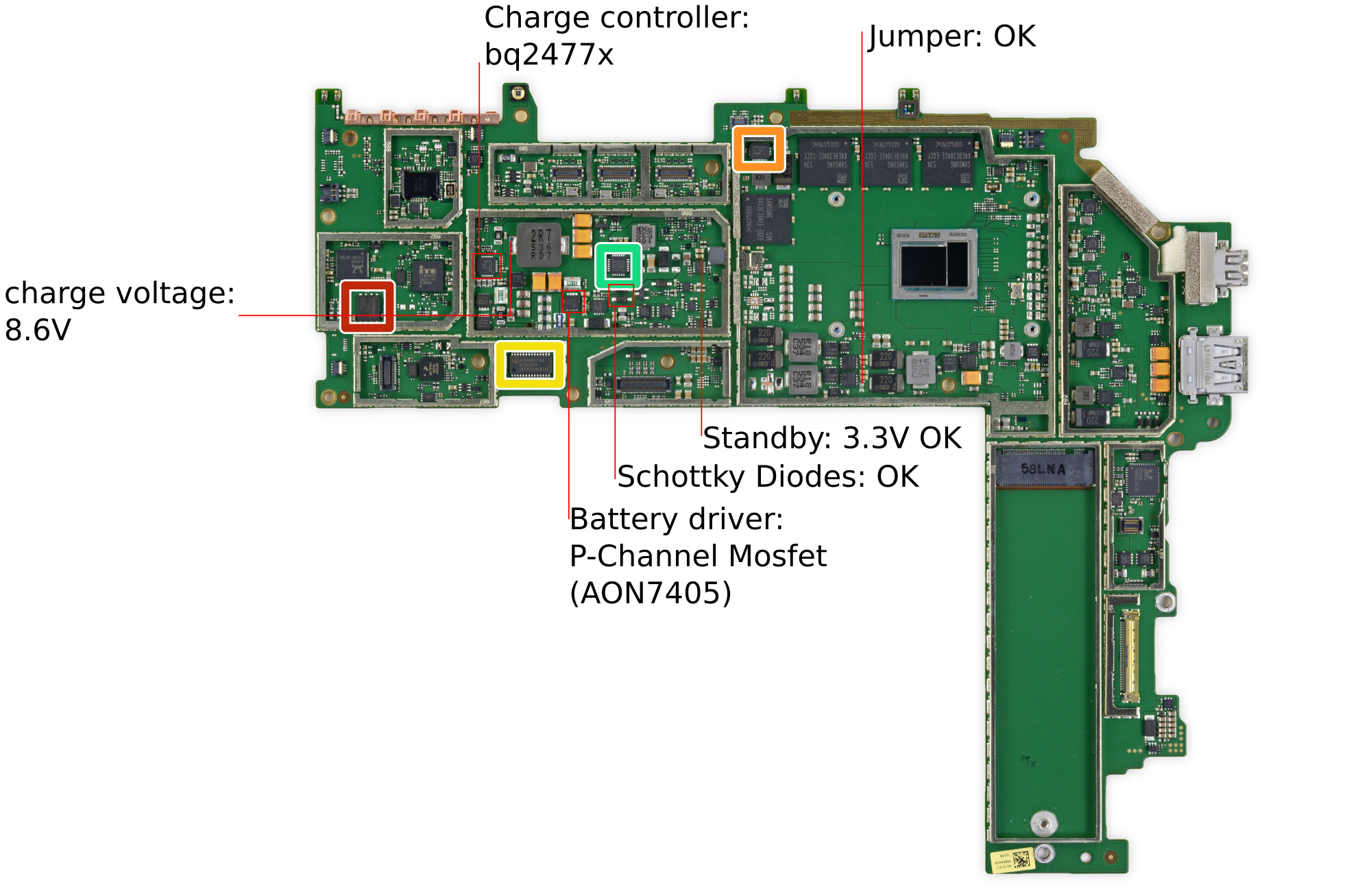

    Then i searched the internet for possible troubleshooting solutions. First tip here is to check the 2 Schottky Diodes (see picture) https://www.youtube.com/watch?v=Qrdfd3Rojxw. In my case they are OK:
    • 0.29 V forward V (the upper one)
    • 0.21 V (lower one)
    The upper one also measures the correct voltage with battery or power adapter connected.
    Next i checked the jumper mentioned here: https://www.youtube.com/watch?v=aMGikVXxdBY. Totally fine.
    Now it was time for a deep dive. I looked up the charge controller (https://www.ti.com/lit/ds/symlink/bq24770.pdf) and did some measurements (from now on i report voltages in the form (without charger/with charger, e.g. 0V/15V for the adapter input voltage):
    • VCC is fine (Pin 28: 7.4V/15V)
    • it creates the charge voltage: 7.7V/8.6V
    • it switches the P-Channel MOSFET that carries the Voltage to the battery on
    • ACOK is high ( 0V/3.3V)
    • not BATPRES is low (as it should be, 0V/0V)

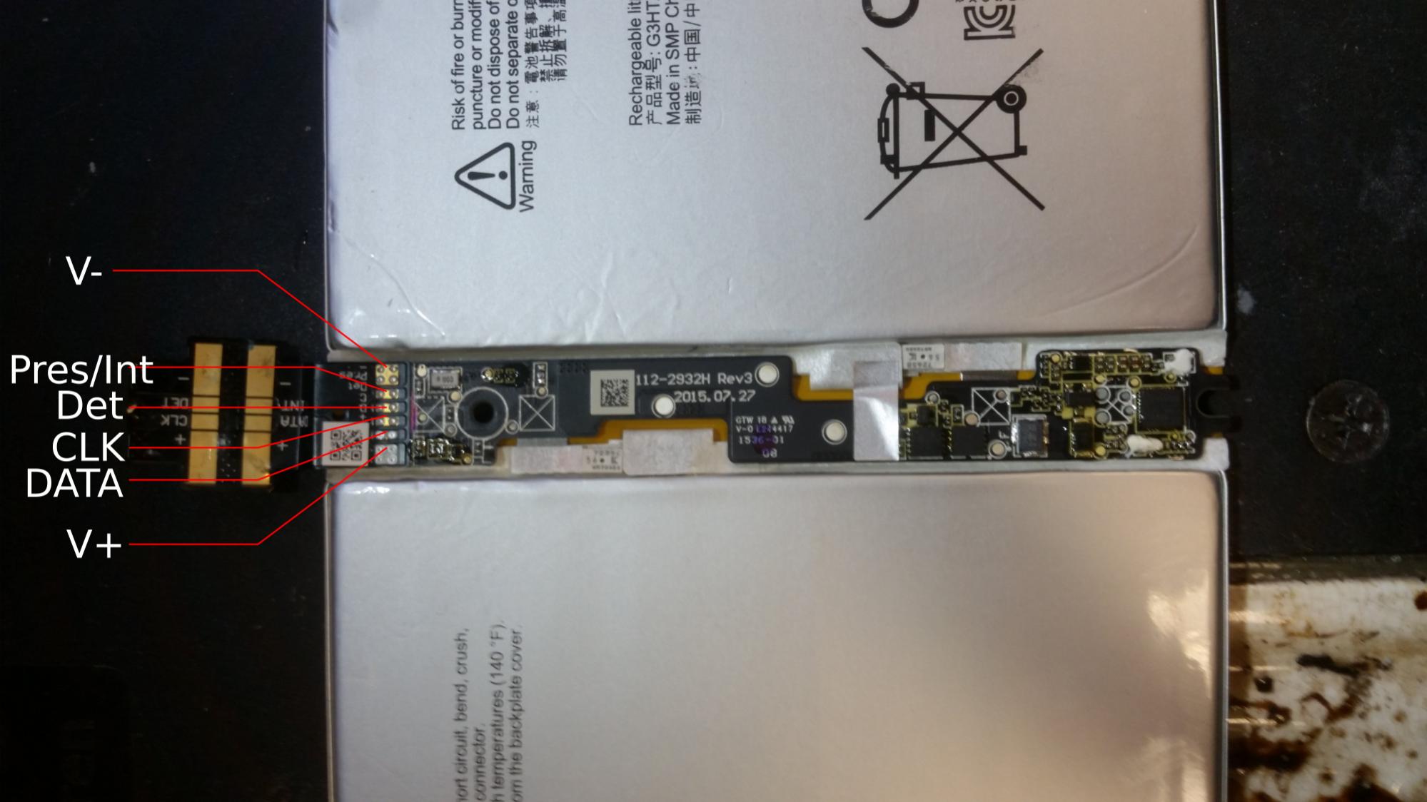

    Now i started to think, that there is something wrong with the batteries, or the spring connections to the battery. So i removed the insulating tape hiding the smart battery circuit on one of them (see picture). There are contacts where the battery input and ouput voltages can be measured.
    • V+ is OK (7.7/8.6V)
    • CLK and DATA have voltage (1.7V/3.3V) but i had no oscilloscope to test further
    • Det and Int are both low (0V, 0V)
    So my question is: What are INT and DET supposed to do and are the voltages on them correct for charging? I tried to follow the CLK and DATA lines and they seem to attach to the charge controller on pins 11 and 12.

    there is a little news about this project. Me and a collegue tried to charge a battery externally. So we supplied 8V to the + Pin of the battery with a Lab Powersupply (if you try this please set the current limit to a low value) . No current was flowing.
    But after we touched the DATA pin with a 8V through a 10k resistor shortly, the battery began to charge. So our guess is, that the battery is good and just needs a signal on the data bus to beginn charging.
    The question is: why doesn't it charge via the board? A voltage is present on this pin, when the AC adapter is connected.
    Any help is very appreciated.
