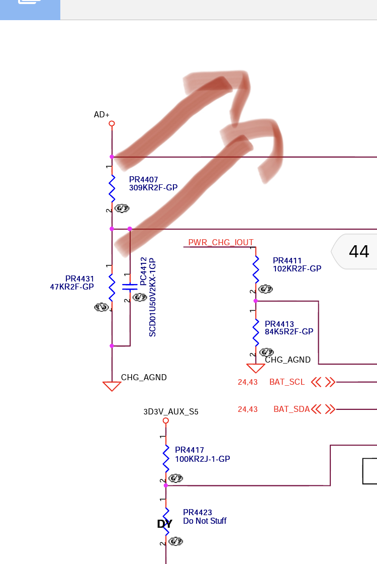

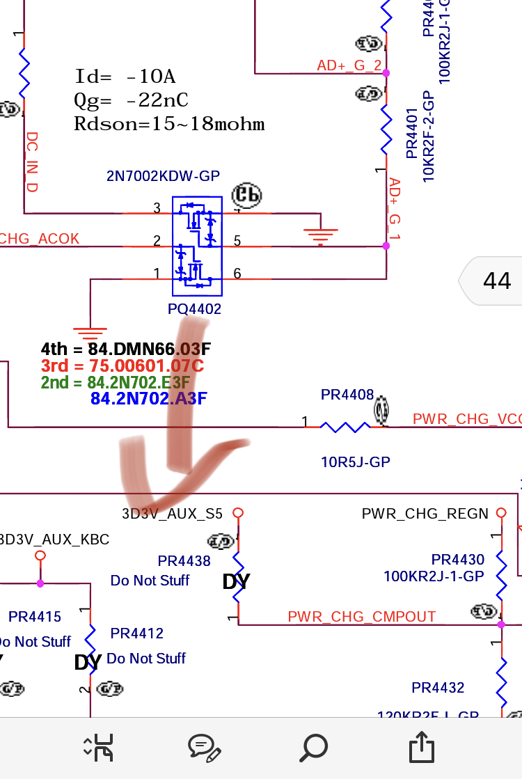

          You have to follow & Understand the Basic before you start to change components, What is your 1st Mosfet & why is it not switching? As for the Schematic AMD you 1st Fet is P -channel the Gate voltage is too high for the gate pass , check out the Pic & update the voltage

                  Re: dell motherboard 13283-1 power problem
                  Originally posted by chamalsb
                  can't understand where to where check voltages
                  oh dear he we go again 1st clean you bord with isopropyl alcohol PU4404 IC count ant-clock wise pin 6 is connected with PR4407 it's Resister check the voltage on both side after put the multimeter Ohms with out any power test Ohms on pin 6 20 of PU4404 find out PQ4402 Dual N-channel mosfet test voltage of all pins uplode a cleair Pic again near the 1st Mosfet (is sitll The Vedda Village exist Mahiyanganaya )

                      Good I suppose you have not tested the points that I have highlighted
