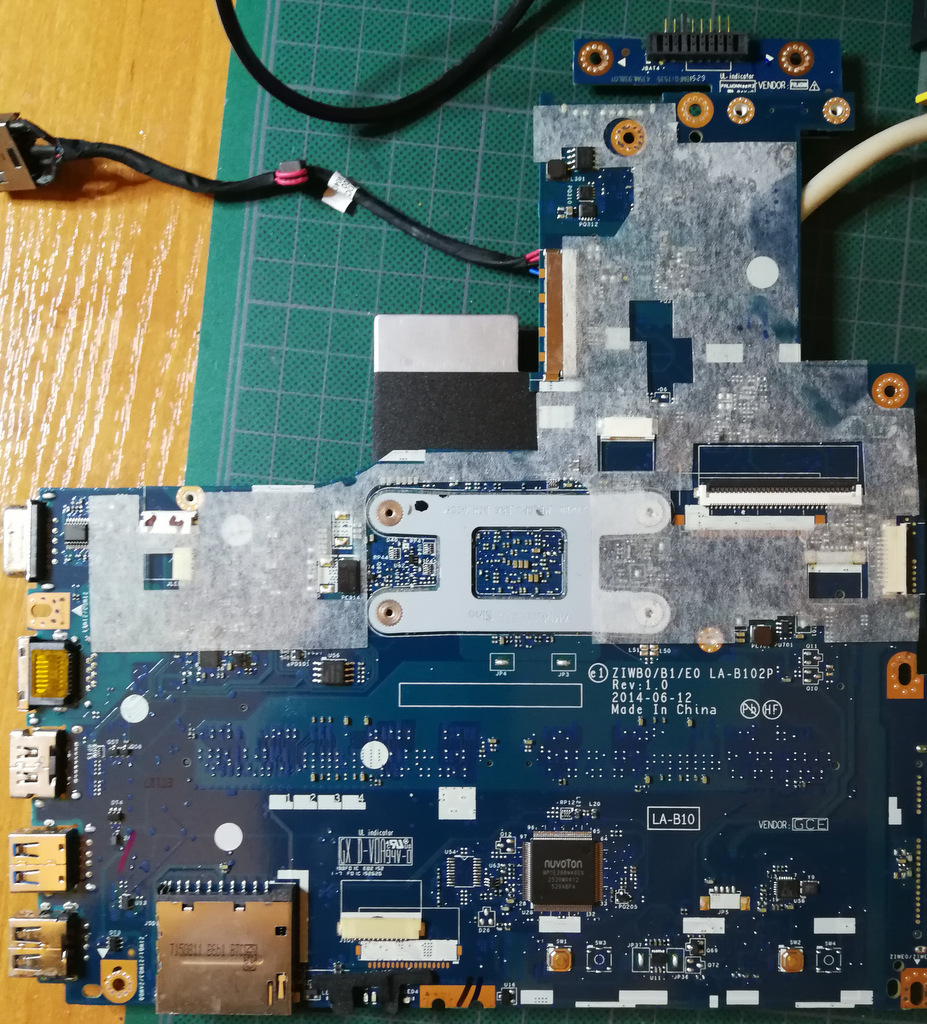

        Re: Lenovo G50-30 no POST on powerup
        Omg, I am very sorry.
        I have a different motherboard:
        ZIWBO/B1/E0
        LA-B102P Rev: 1.0
        2014-06-12
        Should I start another thread on this forum?
          Yes, this thread is for NM-A311 and all advises are based on that mb which will mislead you. Better start a new thread.
