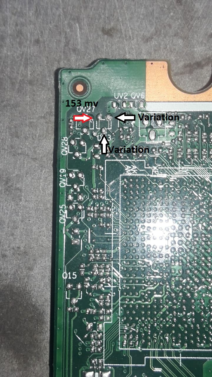

    Hello folks
    Lenovo 320 -15AST
    Motherboard = NM-B321
    AMD with DDR 4
    Lenovo no backlight,no picture Fan not turning on even the CPU get hot after a moment , not display at extern too.
    PSU =0.300 amp .
    PL601/602 = 3/5 valaw ok
    Pl 2201 = +APU_CORE_NB = 0.897 v
    Pl 2202 = +APU_CORE = 0.897 v
    Bios Pin 8 = 1.8 V
    5/3 VS ok / 1.8VS ok / 0.95VS ok / 0.6 VS ok /
    PLT_RST = UL1 =Pin 19= 3.4v
    UE =
    pin 34 = EC_APU_ALWEN = 3.4V .
    Ram = +1.2V ok / +VDDSPD = 3.4V ok / +2.5V OK
    Flashed bios from web site /other site same issue , changing Screen same thing
    U7 = +3VS ok but no PCH_ENVDD.
    So , what i miss to check else !!
    Thank you

    QC9 is not in the MB ? what is the Resistance to GND PCH_ENVDD ? R35 100k is good ? as for the power sequence KBRST# should get reset last !

      Re: Lenovo 320 -15AST not power on !
      Thank you Tech .
      Yes QC9 didn't exist.
      U7 Resistance to GND =
      Pin 4 = PCH_ENVDD = 69.1Kohm.
      R35 = 67.8 Kohm.
      KBRST# when charger connected = 0v...press power = 3.4v
        find out for VGA_PWRGD line is ok or not
          No components to test , most of themps are with @ = don't exsist .
          Une merde ..

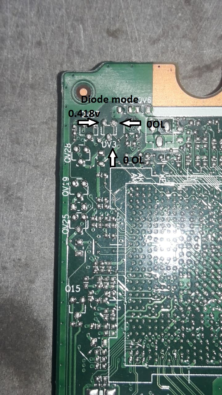

          i find the place of DV3 - don't exist - and try to take measurements (voltage and resistance) at his pad.
          Voltage / diode mode see the pictures
            Update
            UE1 =
            pin 106 = EC_GFX_PWRGD = 3.1v than decrease ....i add R 10kohm = 3.4v
            pin 97 = EC_VR_ON = 3.4v
            pin 99 = EC_SYS_PWRGD = 3.4v
            pin 109 = LID_SW# = 3.4v
            pin 108 = ACIN# = 3V
            pin 78 = VR_APU_PWRGD = 3.4V
            Pin 19 = PLT_RST = 3.4v
              if you can test voltage or from oscilloscope
              LPC_FRAME#
              LPC_AD3
              LPC_AD2
              LPC_AD1
              LPC_AD0
              CLK_PCI_EC
                sorry i don't have oscilloscope
                LPC_FRAME# = 3.4v
                LPC_AD3 = 3.3v
                LPC_AD2 = 3.3v
                LPC_AD1 = 3.3v
                LPC_AD0 3.3v
                CLK_PCI_EC = 1.7v
