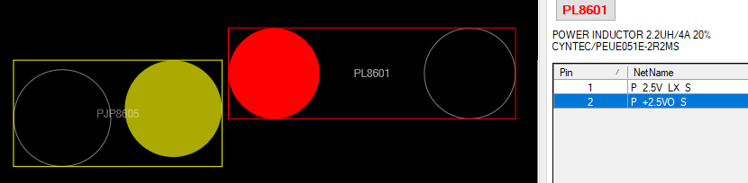

                    what is the voltage on PL8601 ? if no 1.2V trace it Back

                        i have 2.5v on pl8601 and in boardview it says it should be like this or am i wrong?
                        i attached picture from boardview
                        DRAMRST will come after cpu vcore. So no point probing it now. Check ram requirements first and see if cpu receives ram supply(1.2v if ddr4, 1.35v for ddr3 pc3-L).
                        i have 1.2 on pl8600 and 2.5 on pl8601

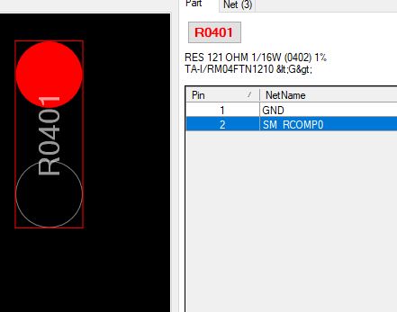

                            R5804 = 3.4v on both sides
                            R5812 = 3.4v on both sides
                            R5805 = 3.4v on both sides
                            R5807 = 3.4v on both sides
                            SL0401 = i didnt find this one but there is sl0601 that has 2.6v
                            R0401 = one side is gnd and the other side has oV [SM RCOMP0] this line only has another net that comes from cpu

                              for the R8507 pin 1 should be 1.2V & pin 2 3.3V
                              D5801 pin 2 is connected to R5807 pin & PU8601 pin 10 is connected D5801 pin2
                              maybe R5807 or D5801 faulty find out , R0401 one side cannot be GND if so remove it test it out of the MB then test the PAD pin 1 2 witch side is short ?

                                i chkd both r8507 and d5801 are healthy, ichkd them outside of mb, i changed d5801 anyway. stillthe same . is the ic faulty? should i buy and replace the ic?
                                and about r0401 it says it in boardview that one side is GND :
