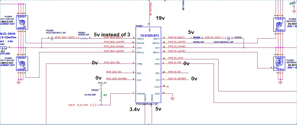

    the situation is:
    no power at all:
    1- no leds , the volt on the power switch is 3.3v and goes to zero when press it.
    no volts in pl4501 nor pl4502

      Voltage on pin 6/20 ? pl4501 / pl4502 Resistence to GND? Upload the Schematic check +B 19V on the upper fets

          Re: Aspire eg50-kb
          pl4501 to ground= 4 kohm
          pl4502 to ground = 40 kohm

            Voltage on PU4503 Drain side ? Check if no short on the 2 Fets , Check for any leak PC4509 PR4501 , TPS5115 pin 6/20 voltage is absent ?

              As techtiger mention before , the requirements for this IC to work is Vin (Pin12) and the enable signals pin 6/20.
              After to get 5 VALW /3 VALW you need 2 another enables signal at Pin 1/5...so what about their voltage !

                no voltage on pu4503 sides, pin6/20 are zero....pin 12=19v

                  pin 1=1.264v, pin 5 = ov

                    Trace the pin6/20 rail for short or bad component
