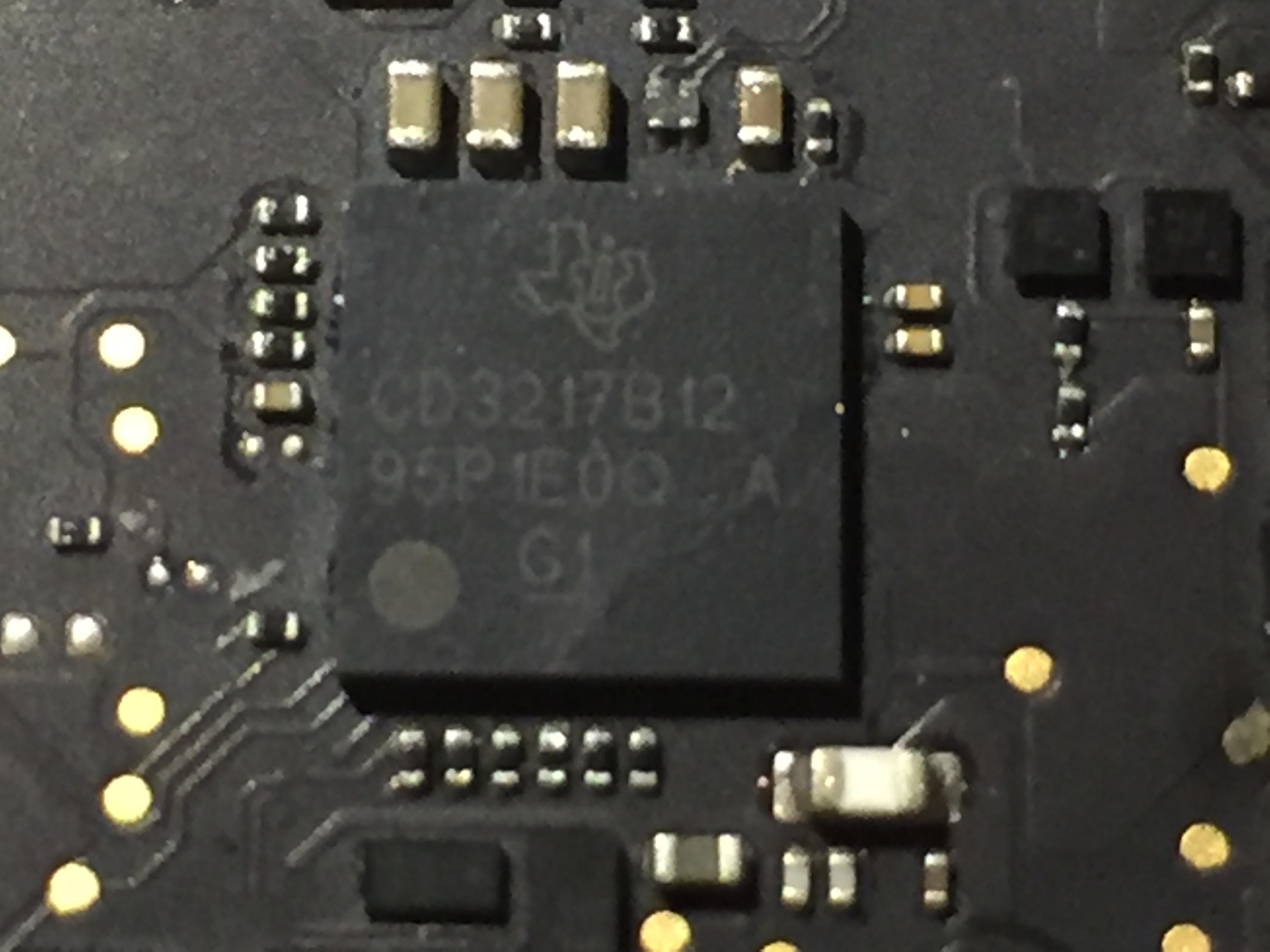

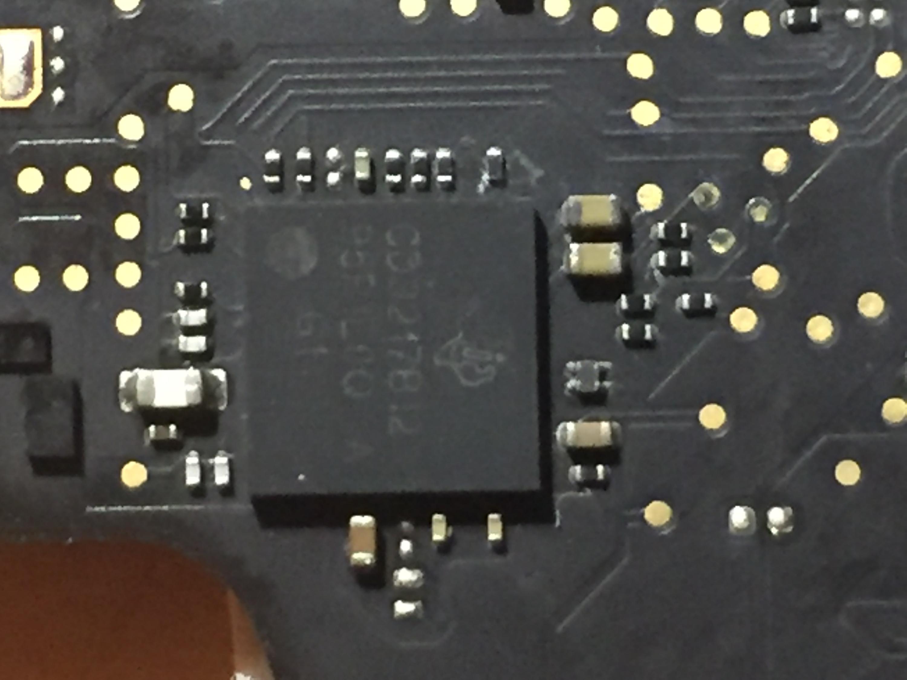

    Hey, as i just became a member i need to hijack this post a little
    I got the same board in front of me.
    My issue, the board does not power up. it has 20V coming in and
    PPBUS_G3H reads 12.56V
    I measured around the C3217B (see pictures attached)
    Circled in red does not give me a Diode reading while the rest looks ok
    https://ibb.co/JKVFtyp
    https://ibb.co/TP1W4ps
    Any thoughts? i don't have the Boardview which makes it quite hard for a beginner like me.
    Thanks guys!

    Re: A2159 820-01598-06, no power
    You're supposed to make your first post in https://www.badcaps.net/forum/showth...o=newpost&t=12 then you get the ability to create new threads.
    Anyway, you got 20V on PPDCIN and even PPBUS_G3H is present so there's no point in looking around the USB-C controllers CD3217.
    What's the history of the machine? What's the current consumption on USB-C ammeter?

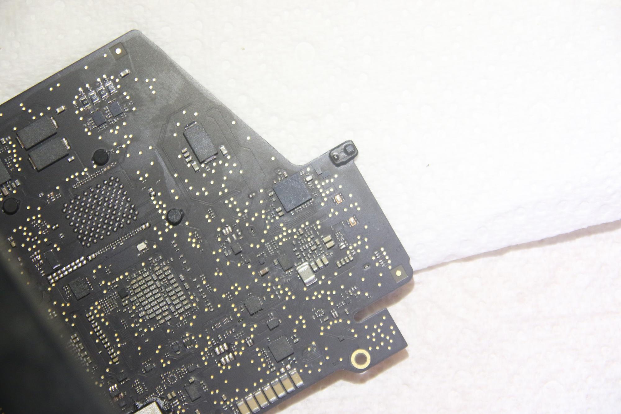

      History is that the mac was in a car crash (car rolled a few times) there was some coca cola in the car too.
      i took some shots of the board:
      https://ibb.co/VMtCwxK
      https://ibb.co/rQCB8ty
      https://ibb.co/6b8wt7C
      https://ibb.co/StyRmL0
      https://ibb.co/r2zQsBD
      Thanks for your response Piernov! :-)

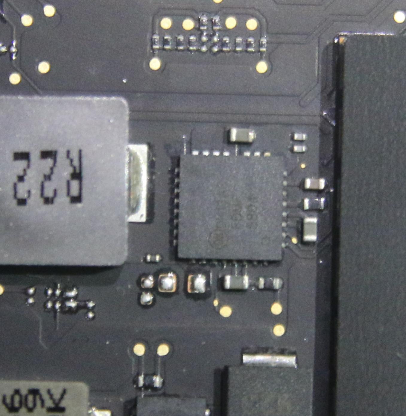

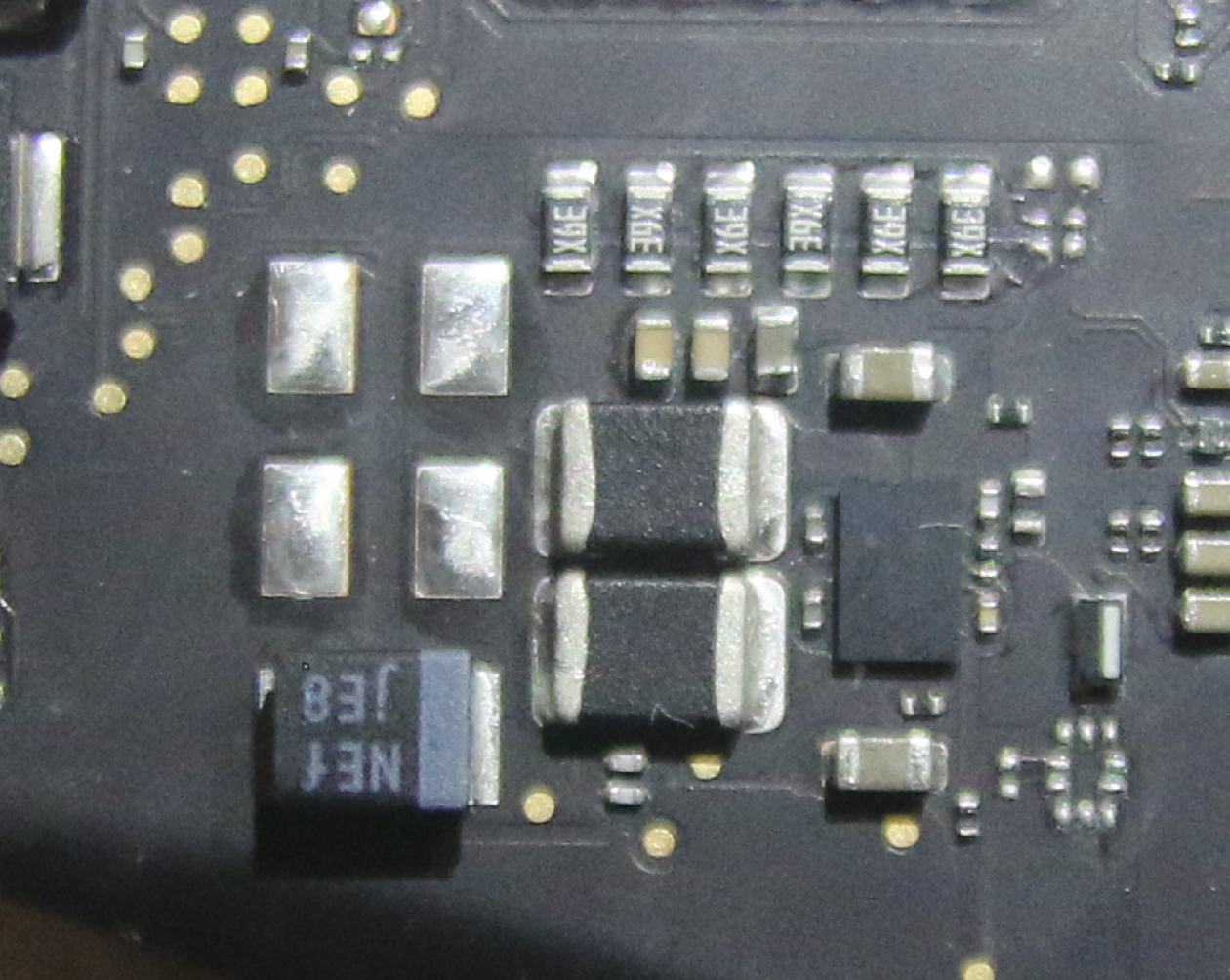

        There's indeed several spots of dirt and corrosion. Make sure you locate every single one of them and take good shots, then you can clean them and see if the components are corroded afterwards.
        On the second picture there's damage on a CPU VRM chip — that's often a bad sign but let's hope the CPU survived.
        There's no boardview for this board available yet and there's no similar boardview (820-00840 and 820-00850 can give some ideas but they're still very different). At least schematics leaked a few months ago. This is a T2 machine with a pretty complex and obscure power sequence. It's one of the hardest board to start repairing.
        Also please attach the pictures directly to your post rather than uploading to an external service.
