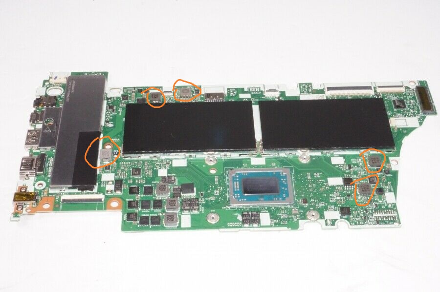

                  Here`s a link to the schematic. Can you measure the voltage on all the large square grey coils.
                  https://www.badcaps.net/forum/showthread.php?p=973992

                    the ones next to the fets? and what looks like diodes? They all read 0 (with adapter plugged in)
                    all diodes read 0 except one away from the group around the fets

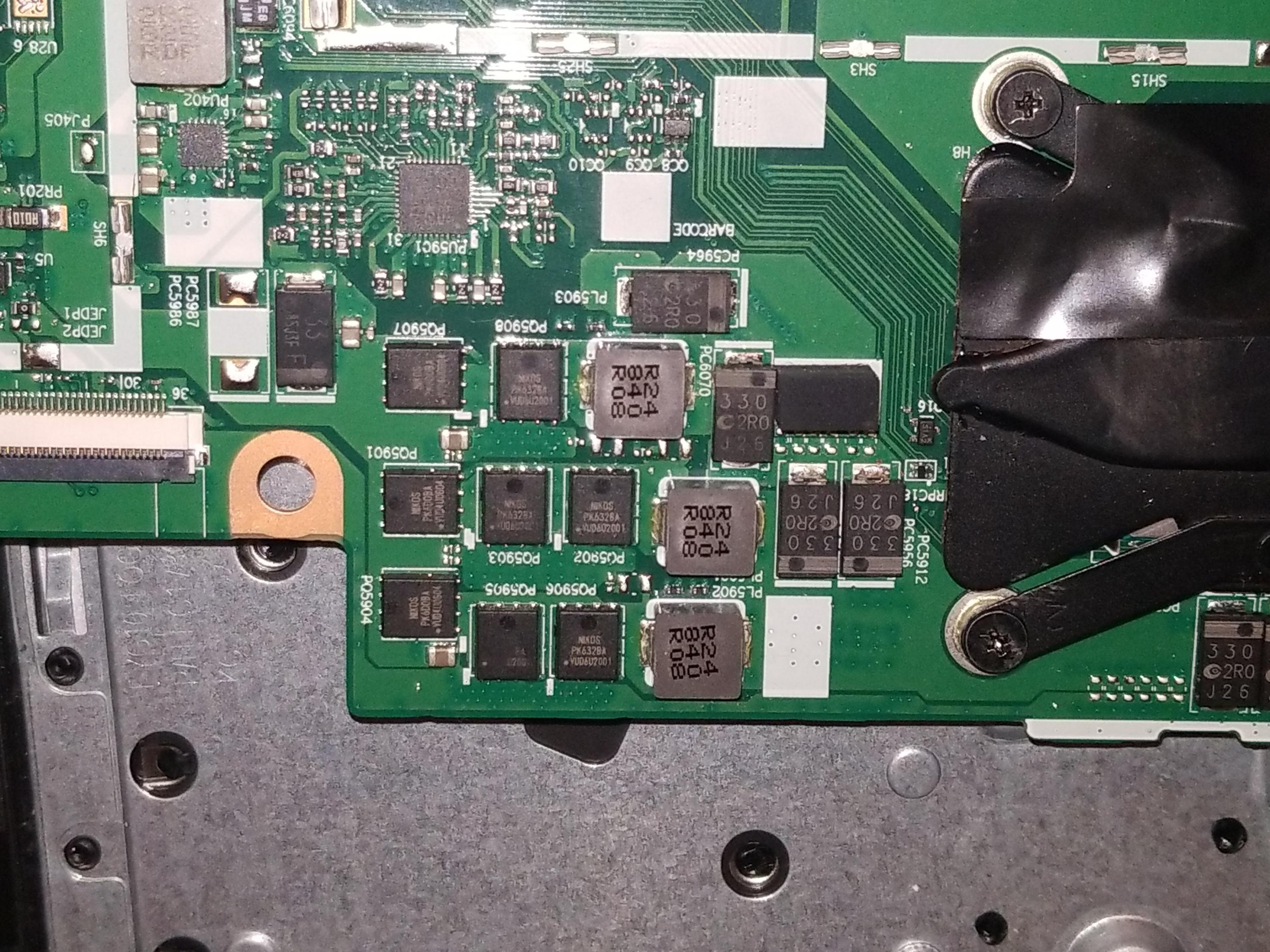

                      check these, also can you post a few pictures of the DC in area ,both sides of the board, peel back the black plastic sheet beforehand.

                        Back of it dosen't have much. Only a few smds. Mostly blank

                          Test voltage on PQ201 pins 1/4/5 ,PQ202 pins 1/4/5 ,see page 42 on the schematic.PU201 on pins 1/2/5/6/7/27. PL401/PL402 and PU1901 pins 3/6 .

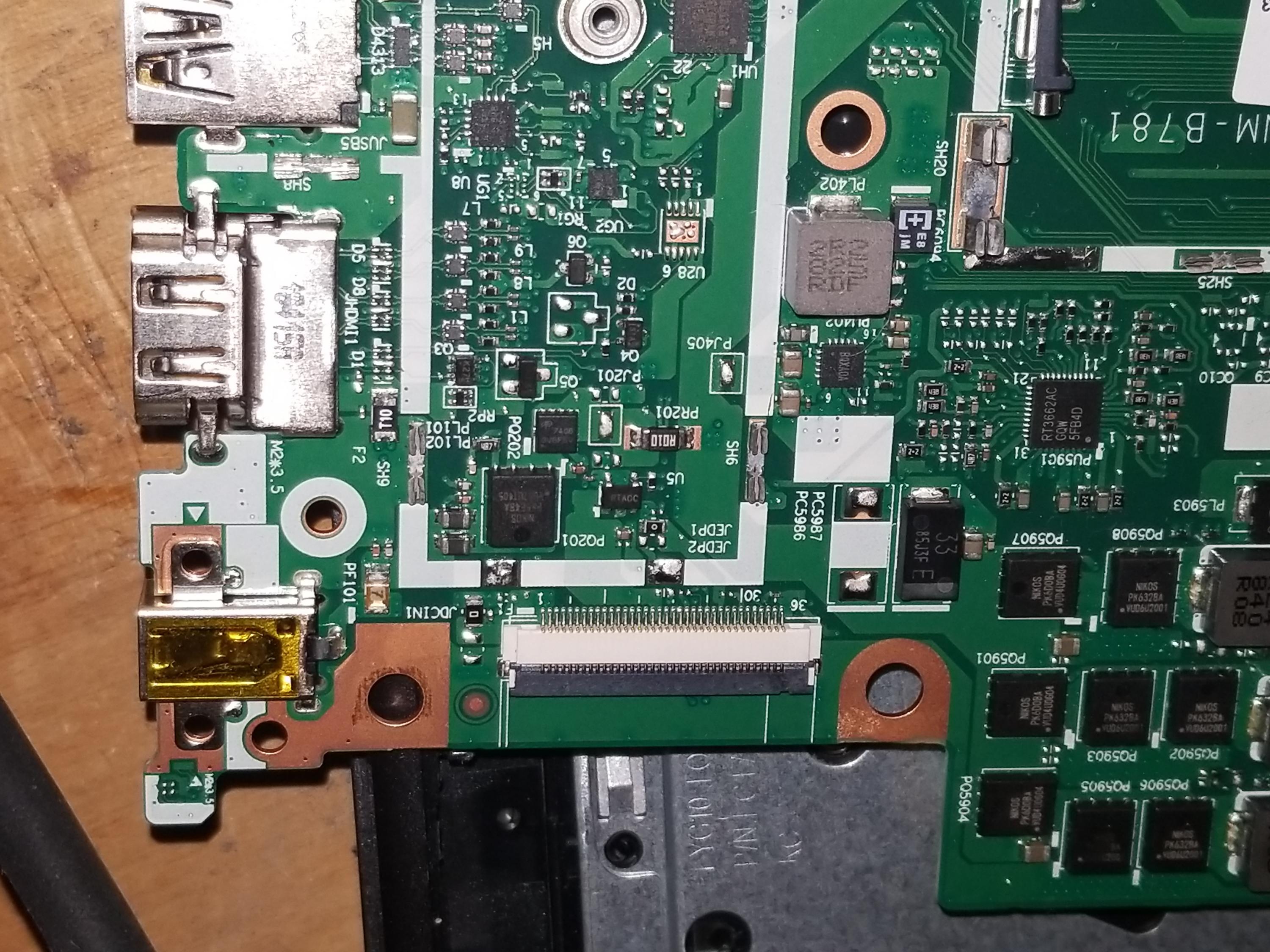

                            ok, i've never dealt with fets or voltage controllers before. Is pin 1 the one with the square on the silkscreen?
                            by 1/4/5 do you mean 1&4, 1&5? 4&5?
                            401 and 402 are coils i've already tested
                            umm, let me add info. You see the M.2 slot (where the PQ201, PQ202, UH1 are?)
                            Well it's M.2 2242, which is hard to find good ones, so I got a 2280 and used a small 3M VHB strip to keep it down, looks around where PQ 201 and 202 are. I'm guessing, my dumbass insulated fets, and the heat caused them to die?
