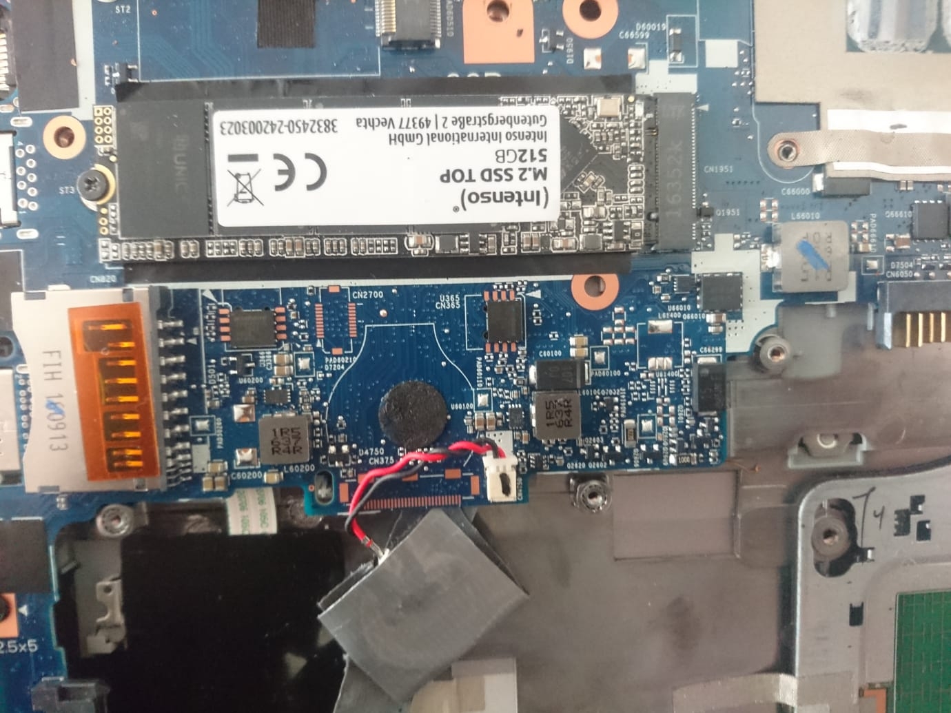

    I bought a used HP Elitebook 840 G3 on ebay. It came as untested, without a Hard Drive.
    When I first started it, it gave me a series of POST beeps - 2.2, followed by 3.2. I identified the beeps as corrupted bios and faulty ram. I replaced the ram and the beeps stopped. Now when I turned it on, the keyboard backlight went on for a moment, then turned off, followed by the laptop turning itself off shortly after.
    I created a bios recovery flash drive, using an HP setup file, popped it in and started it, while keeping windows+b pressed, the method outlined here
    The laptop now stayed on, the fan started running, but nothing else happened. The USB drive blinked for a second when I turned the laptop on.
    I left it like this for several hours (apparently flashing the bios can take up to 40 minutes) but still, no change. The screen backlight went on, but the screens remained black and nothing else happened.
    I changed the cmos battery, tried resetting the cmos, nothing happened.
    I'm guessing the motherboard has a fault somewhere, but that's really where my expertise ends. I have no idea how to even check the motherboard for faults, or where I should look. I'm willing to learn, but if someone could point me in the right direction, I'd very much appreciate it. Or it could be something else entirely?

            It is possible that the mainboard be faulty. But to make sure, the first step is reprogramming Bios.
            But as you did not reprogram Bios properly, @techtiger recommended you desolder the Bios chip and use an external programmer. This is my recommendation too.
            If no result, then you can continue testing the mainboard further.
            Does the CPU get warm?

              I tried to flash the bios the way HP recommended... I didn't know about external programmers. But I'll try it!
              The CPU doesn't get warm at all. The fan spins and I guess thermal paste should hold for 4 years (the manufacture date of the laptop is August 2016). But as I'm going to take it apart anyways, I will replace the thermal paste.
              I know a few things about taking computers apart, i just don't know about replacing/checking parts on the motherboard itself.

                If the CPU doesn't get warm, that means the mainboard is faulty. Bios reprogramming is not required anymore.

                    because that means the mainboard does not provide any power to the CPU.

                      Just tested it, took the fan off, started it, the cpu got hot within seconds.
                      I also saw that the light on the SDD was on (I got a new M.2 and put it in). But since the Disk is blank, I guess that only means that the SSD is receiving power?

                        yes,
                        If the CPU gets warm, you can reprogram Bios. To learn how to do that using an external programmer, search the net for guide pages and videos.

                              Is your bios chip a sop8 or WSON

                                  Um... There's two, but I can't really make out the writing on them, they're too small... both winbond, I think one of them says 25q64fv10 and the other 25q128vfq, but google doesn't know those parts numbers, so I could be mistaken.
                                  This is the best picture I could take.
