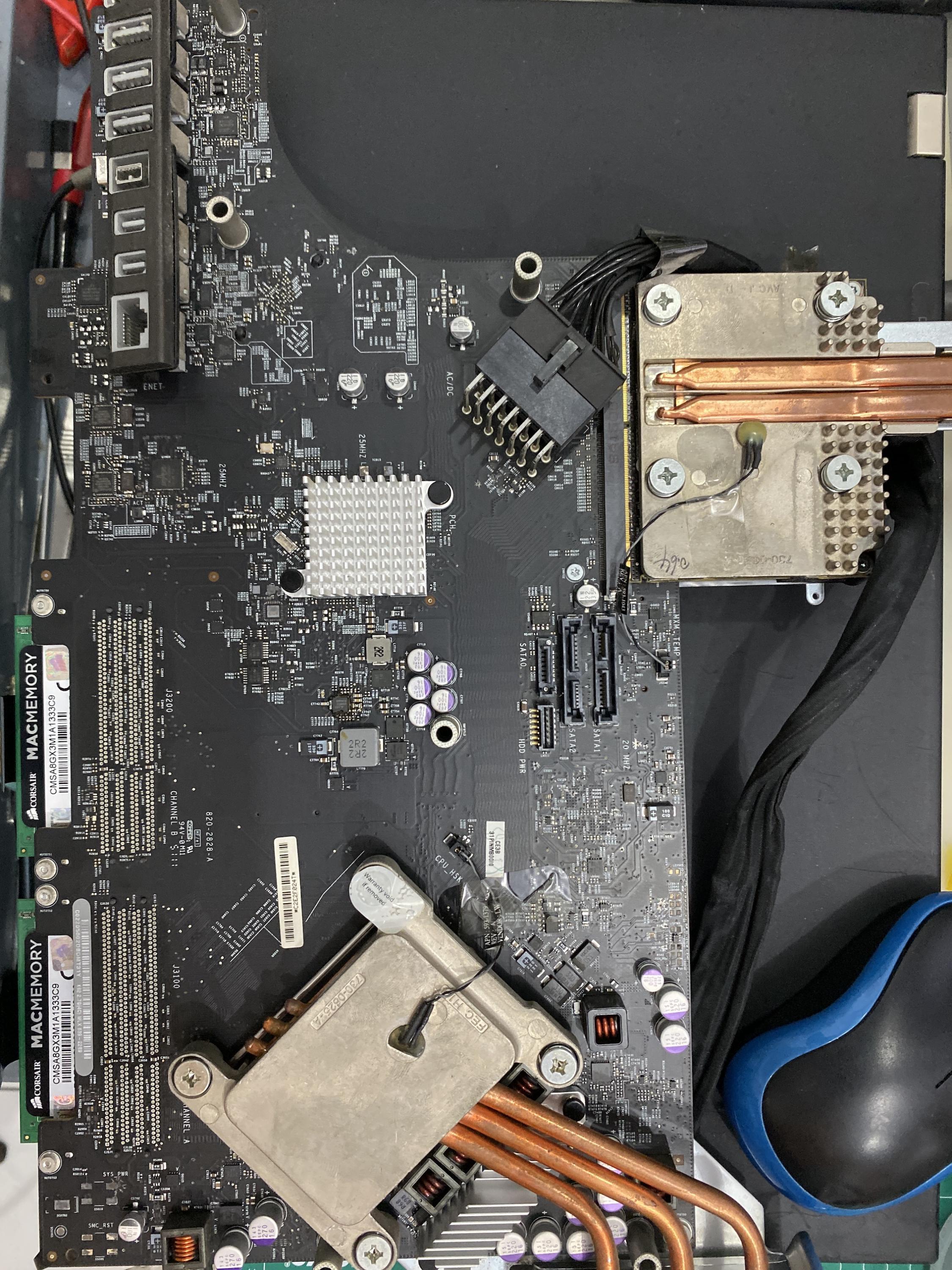

    I need some help for iMac A1312 820-2828-A.
    The iMac cannot turn on. i already changed the power supply but still cannot turn on.
    All the LED indicator is off. can somebody give me a hint where should i start?

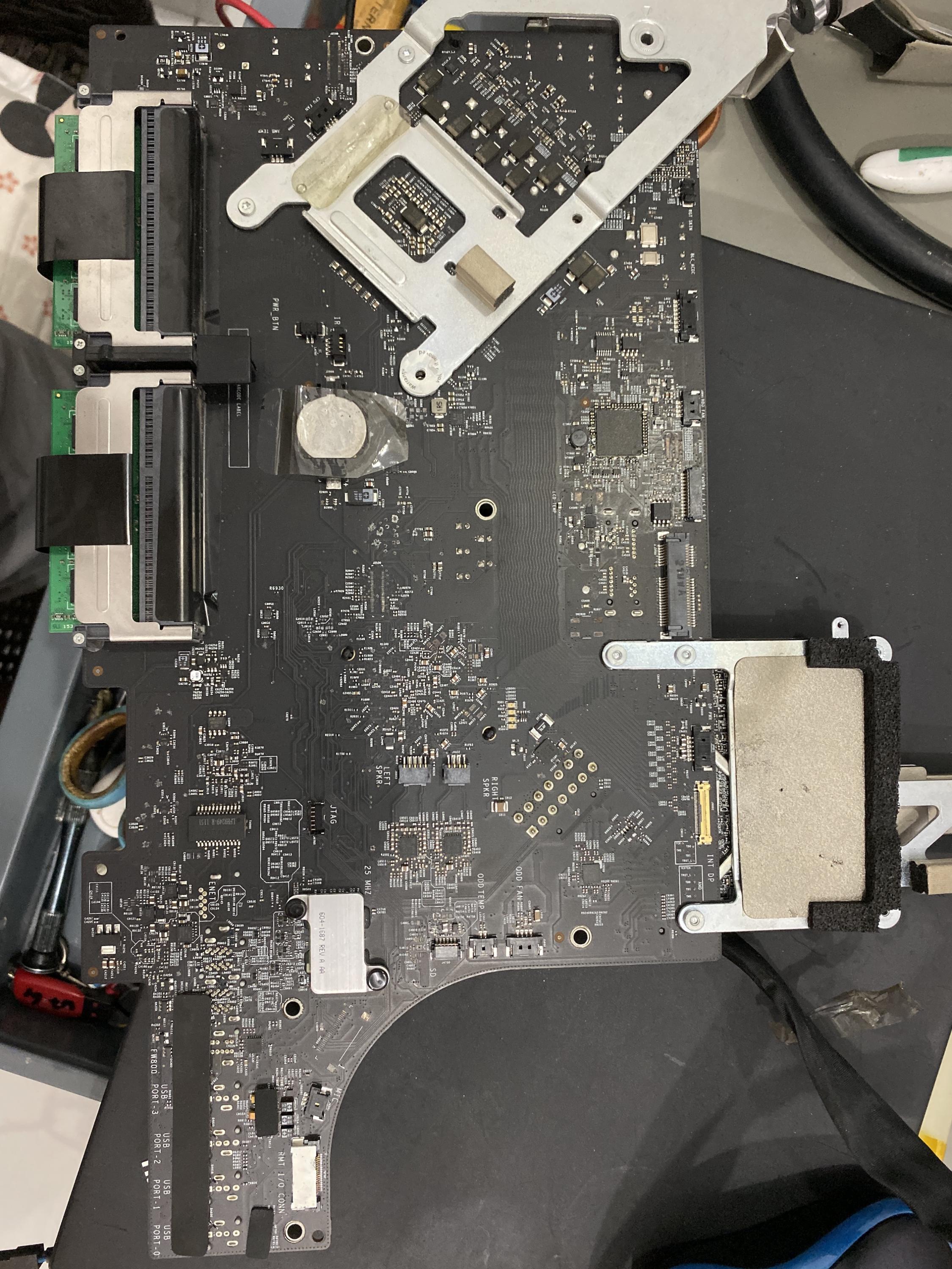

      i get a little lost here because the schematic i have is different from the board.
      here i attach the schematic and boardview that i have

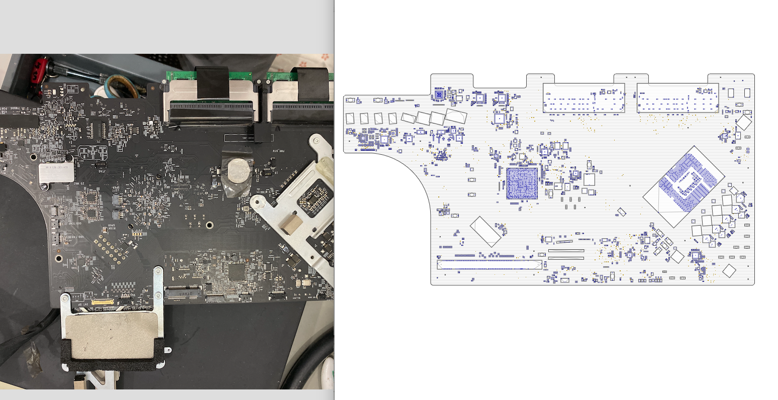

        Looks like it is the correct schematic and boardview for the 820-2828 board.

          it is different as you can see from the pictures. the position of the components are different.

              I haven't looked in great details but the board pictures still seem to match the boardview…
              Not sure what you mean by "ISL chip". You have to take measurements of all G3H rails so that includes PP12V_G3H .

                  Please point out which component placement is different between boardview and the actual logic board, I still don't understand.
                  If there is a short to ground on PP3V42_G3H, you can inject 3V with a lab PSU and try to find a component that heats up (capacitors or SMC for example).

                    i followed your suggestion and inject 4.5V and 2A at PP3V42_G3H and found the short cap. it is C7902. after i removed the caps and measure i still got 0.4V on PP3V42_G3H.
                    here is the picture as you can see there are diferrence between actual and the boardview

                        Press space to show the other side of the board and press M to mirror it.
                        You didn't follow my suggestion of injecting 3V since you injected 4.5V. Injecting 4.5V into a 3.42V rail will kill components. In any case after removing a component you have to check if the short to ground is still present or not.
