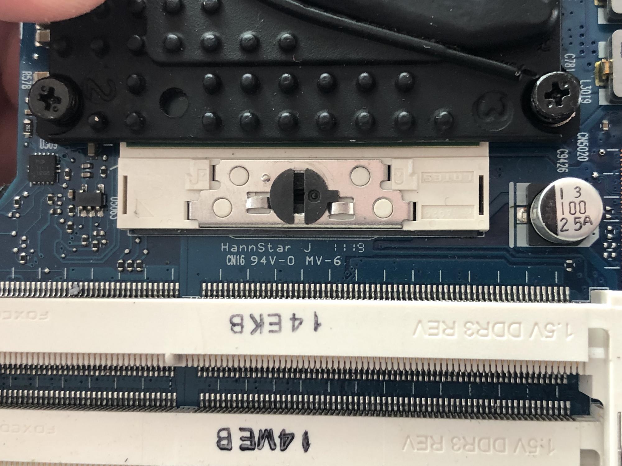

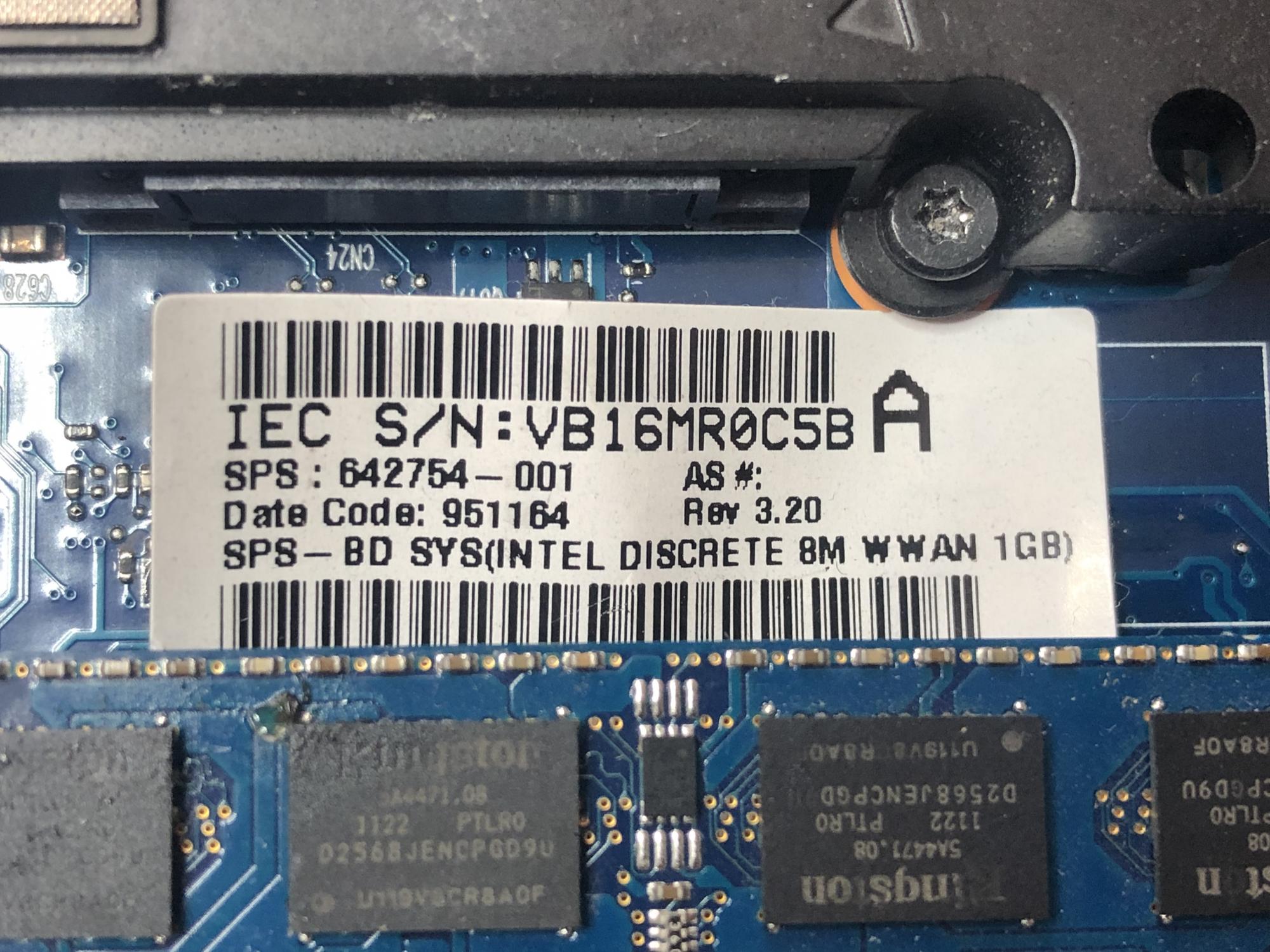

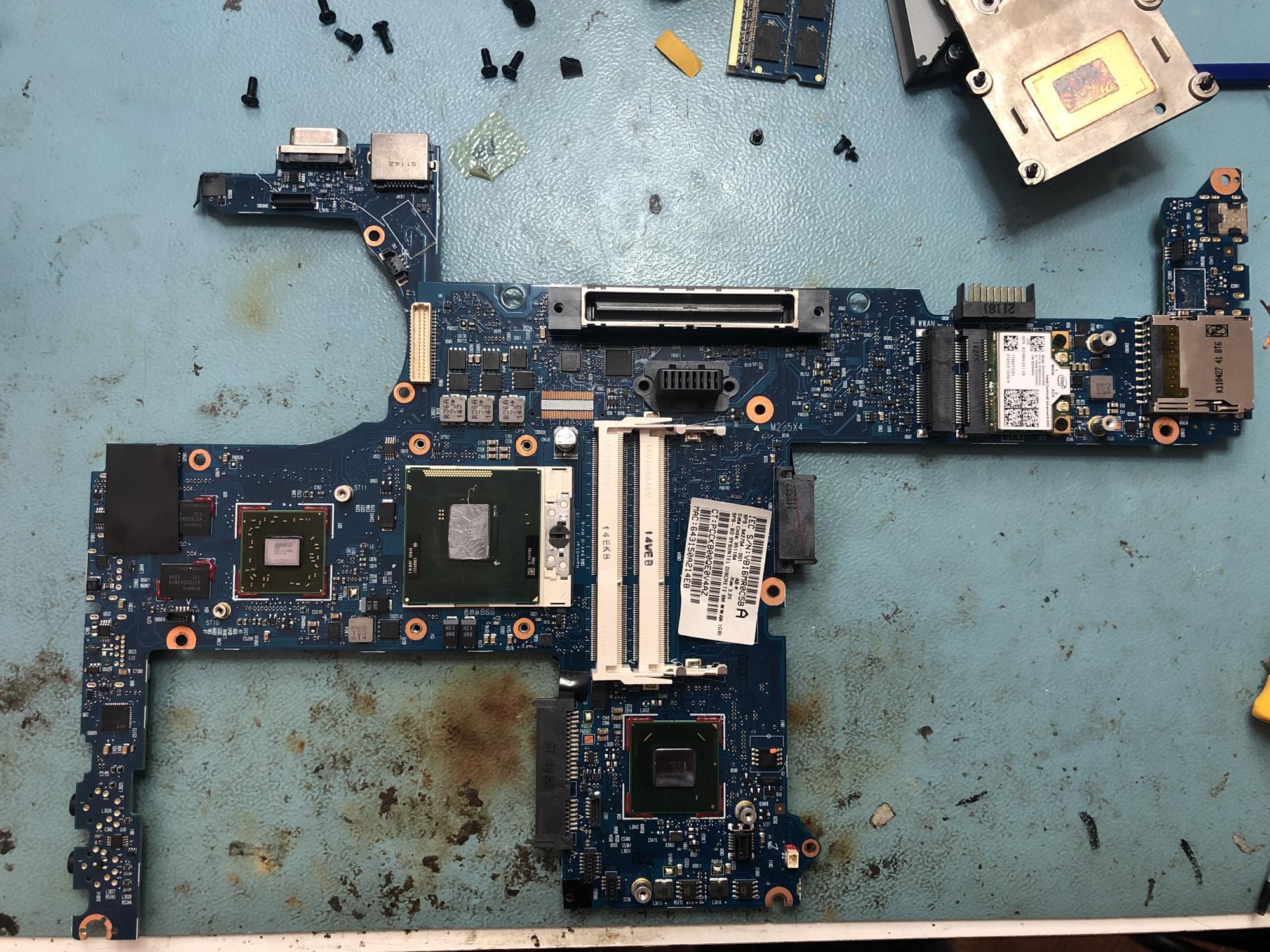

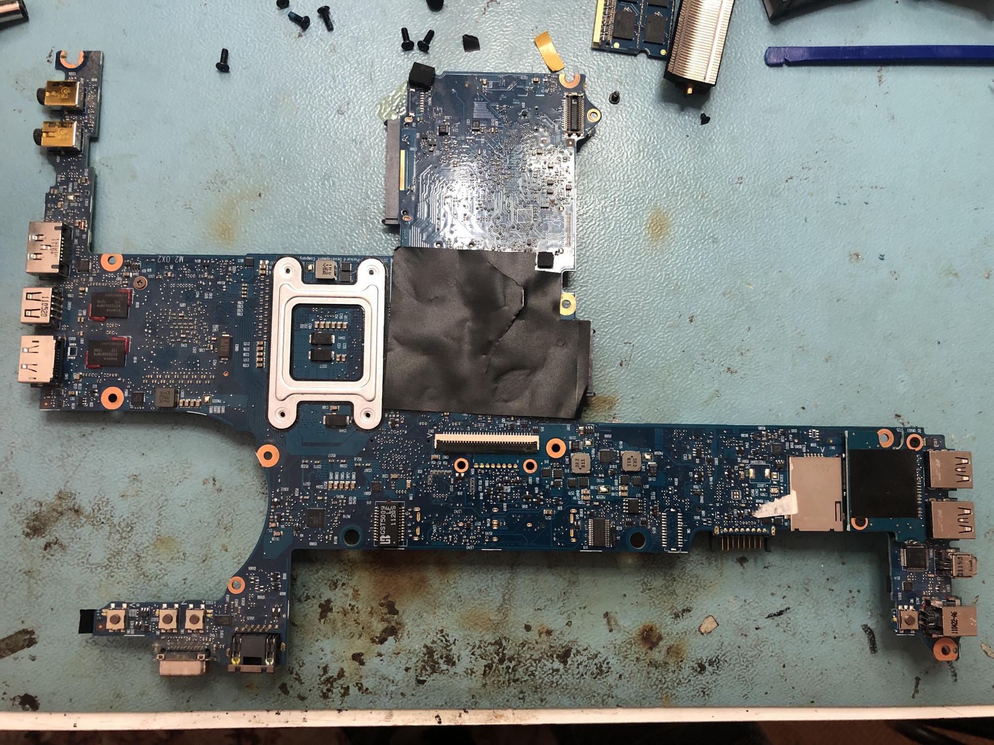

    I have problem with this laptop. After power on button is pressed laptop start and instantly goes off. When I remove main battery and CMOS battery for a while laptop starts normally and work all the day. I tried flash bios with tool from HP website and it tooks too long time approximately 6 Hours for saving old bios and 6 hours for flashing new one. Bios Is latest now. And CMOS battery has only 2.6v I replaced it.
    But problem is still here.. can someone help me with this? Mobo looks fine no water damage..
    Re: HP EliteBook 8460p turn on problem
    Pictures
