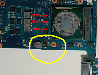

        Suggest to measure the resistance to ground of each inductor on the board (usually are grey in color and will be with 2 leads). This is to check if any of the power rails are with a lower resistance than normal and then the power regulator will sense this excessive current draw and power down. When a rail shuts off, so does the board.
        A low voltage power rail will be with a low resistance, by design. Post all details of any suspects. When you search for 'VBATR' in the schematics, you will see that this high voltage will mate with the high side of a mosfet. That is, there will be a high side and a low side mosfet (goes to ground) which work as a pair to dial down the high ~19v to a safe value for the specific rail. For example, 3v3 or 5v0, etc.

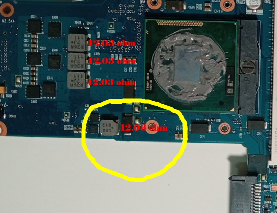

          2) measure the resistance to ground of each inductor on the board
          12.03 ohm, 12.0 ohm, 12.03 ohm, 25.03 ohm , 88 kohm
          620 ohm, 105 ohm, 63.55 ohm, 9 ohm , 37.5 ohm

            For the inductor measurements - post their locations from the schematics. Unable to zoom in on their values in the posted pics.

              3) For the inductor measurements - post their locations from the schematics. Unable to zoom in on their values in the posted pics.
              i post links where you can open and zoom the pictures
              the link for the first picture
              https://ibb.co/fd4dP8gD
              the link for the second picture
              https://ibb.co/RGtd0mJn

                What are the white silk screen markings of this region of the board? Unable to read the values in the posted pics.

                  if you like i can send you the motherboard BoardViewe file , it shows all the component numbers and places. if it will help you
                  https://ibb.co/gbV64v0
                  https://ibb.co/jkgQJ5LC

                    L3 is ok since this is the 1v05 rail. That is, low voltage rails, by design will have a low resistance to ground. This rail is ok.

                      actually L3 is 12.03 ohm resistance
                      but L3051 is the lowest one with 9 ohm resistance

                        L3051 is also ok since this is the GPU power rail. Some GPUs can be as low as 0R5 ohms and still be ok. No issue here.

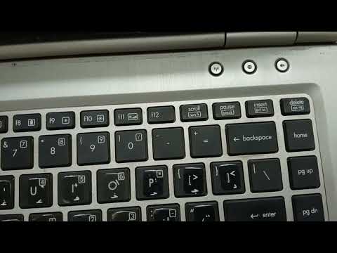

                              this the motherboard behavior after re programming the bios
                              https://youtube.com/shorts/aobkb17PIKQ
                              if anyone can help me
                              i'm not sure if it's hardware failure or just Bios firmware failure

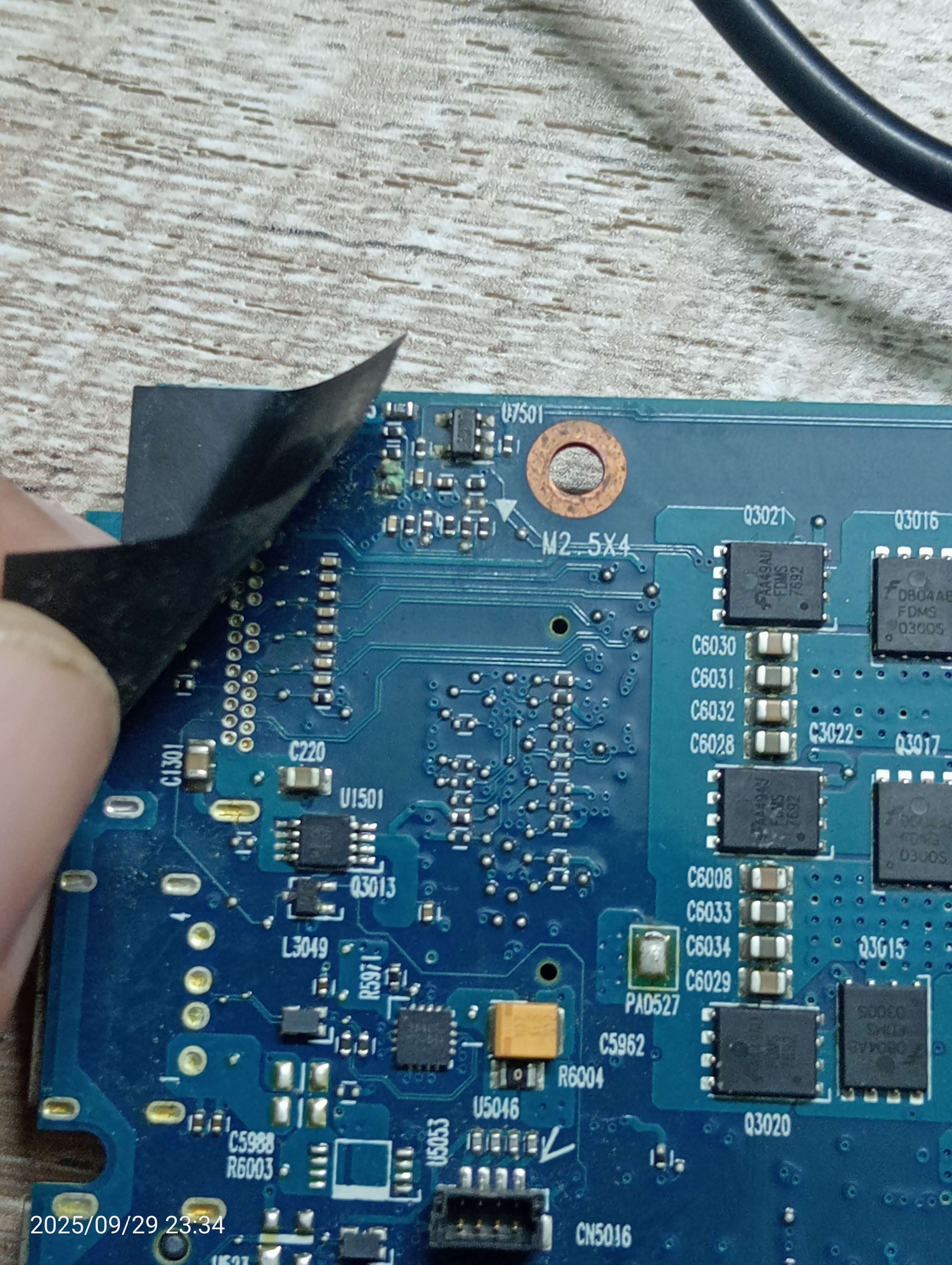

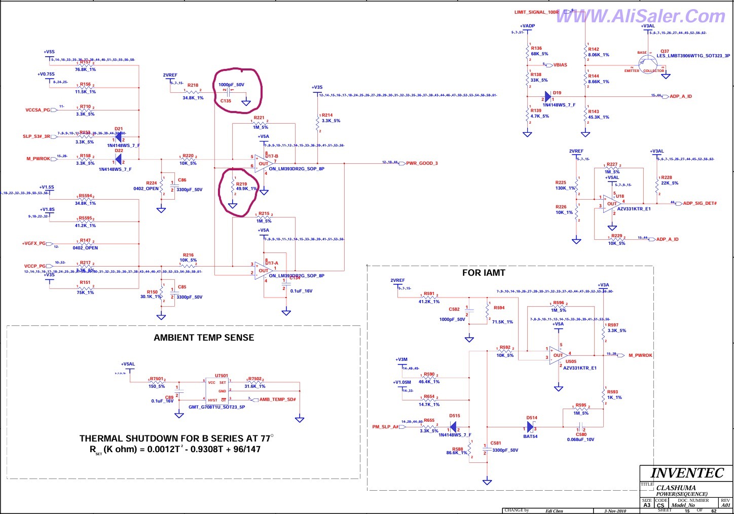

                                    i was tracking the overload current protection circuit when i found this
ID:	3738161 and after cleaning it with alcohol i found that r219 is missing solder connection

ID:	3738162 so i replace it with another resistor 50 k ohm
                                    and it run perfectly
