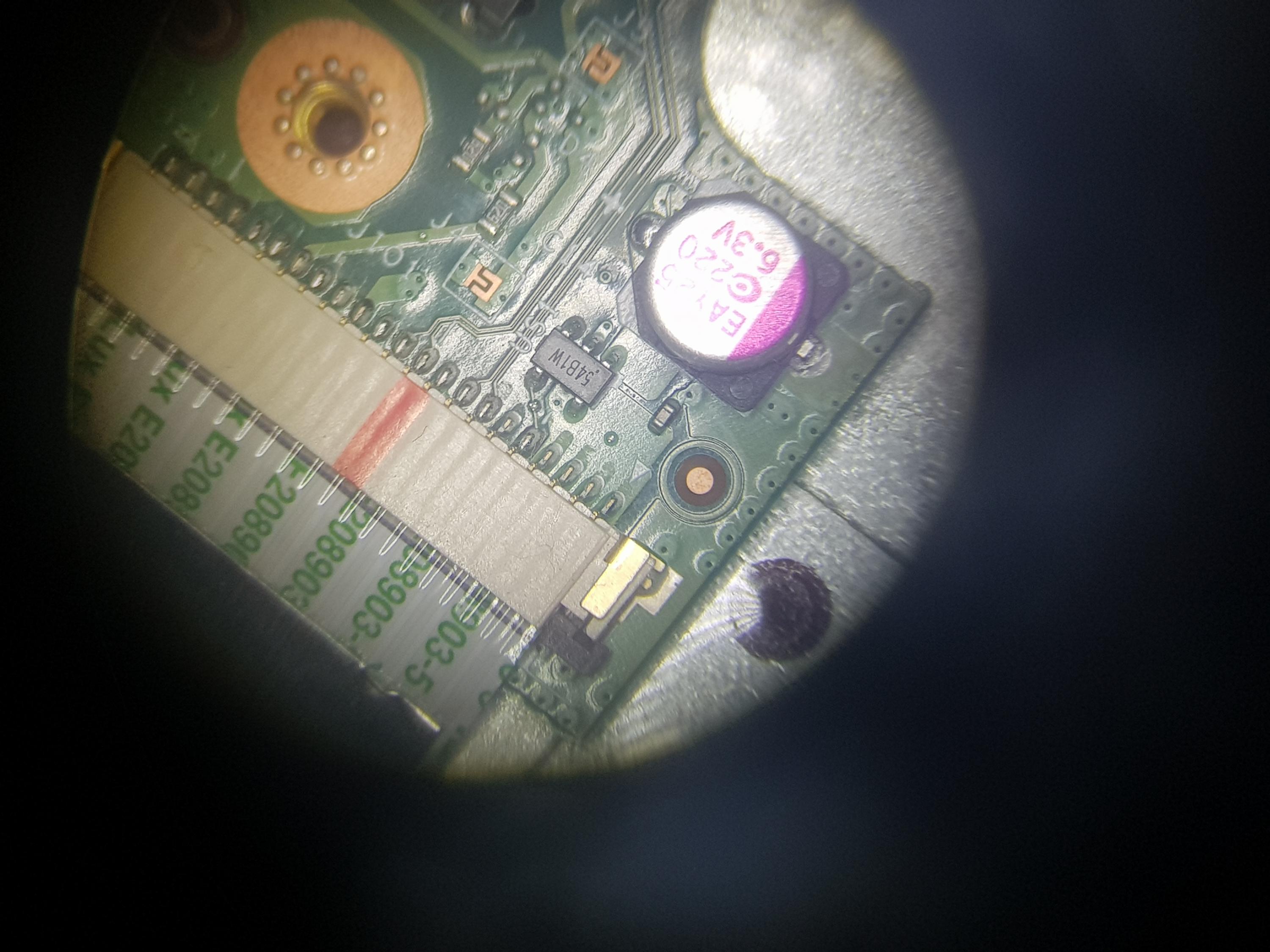

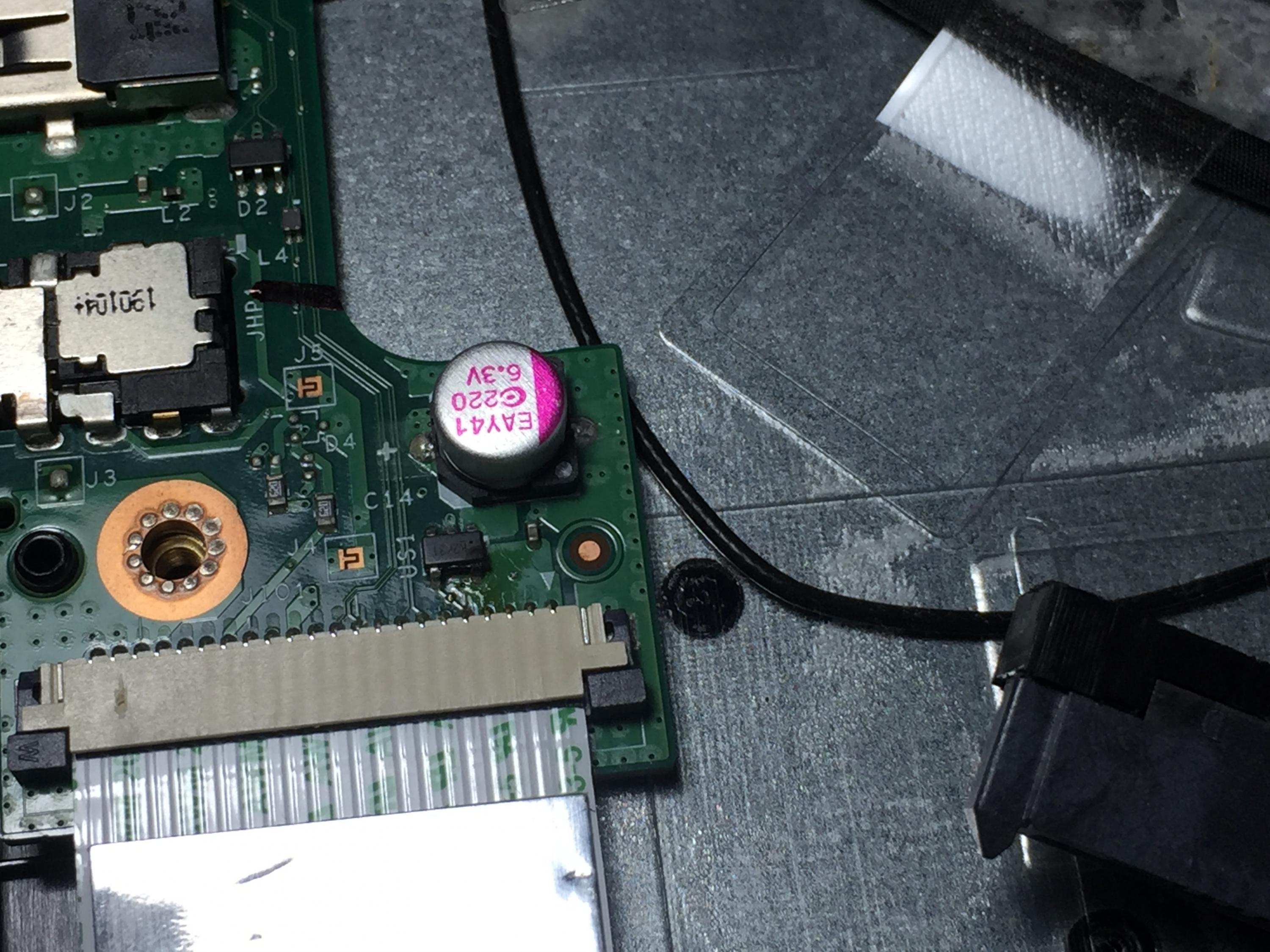

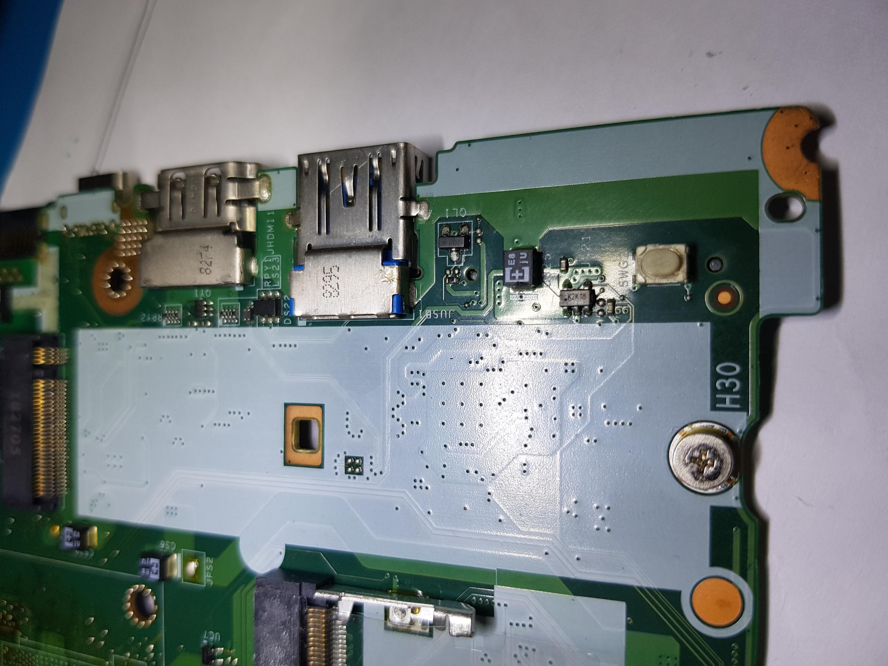

    Does anyone know what chip is this?and what is it purpose?i cannot find same replacement

    The picture isn`t clear enough with the part number . You didn`t say its on the IO audio board..........
    The IO Audio board schematic is D7W01 LS-E893P Rev: 1A

      Re: ACER a515 C5V01 LA-E891P
      I am not sure, but it is very likely the usb 5v power controller.
      It is not matching the la-e891p schematic. However, like SMDFlea suggested, a clear photo would be helpful to identify it ...

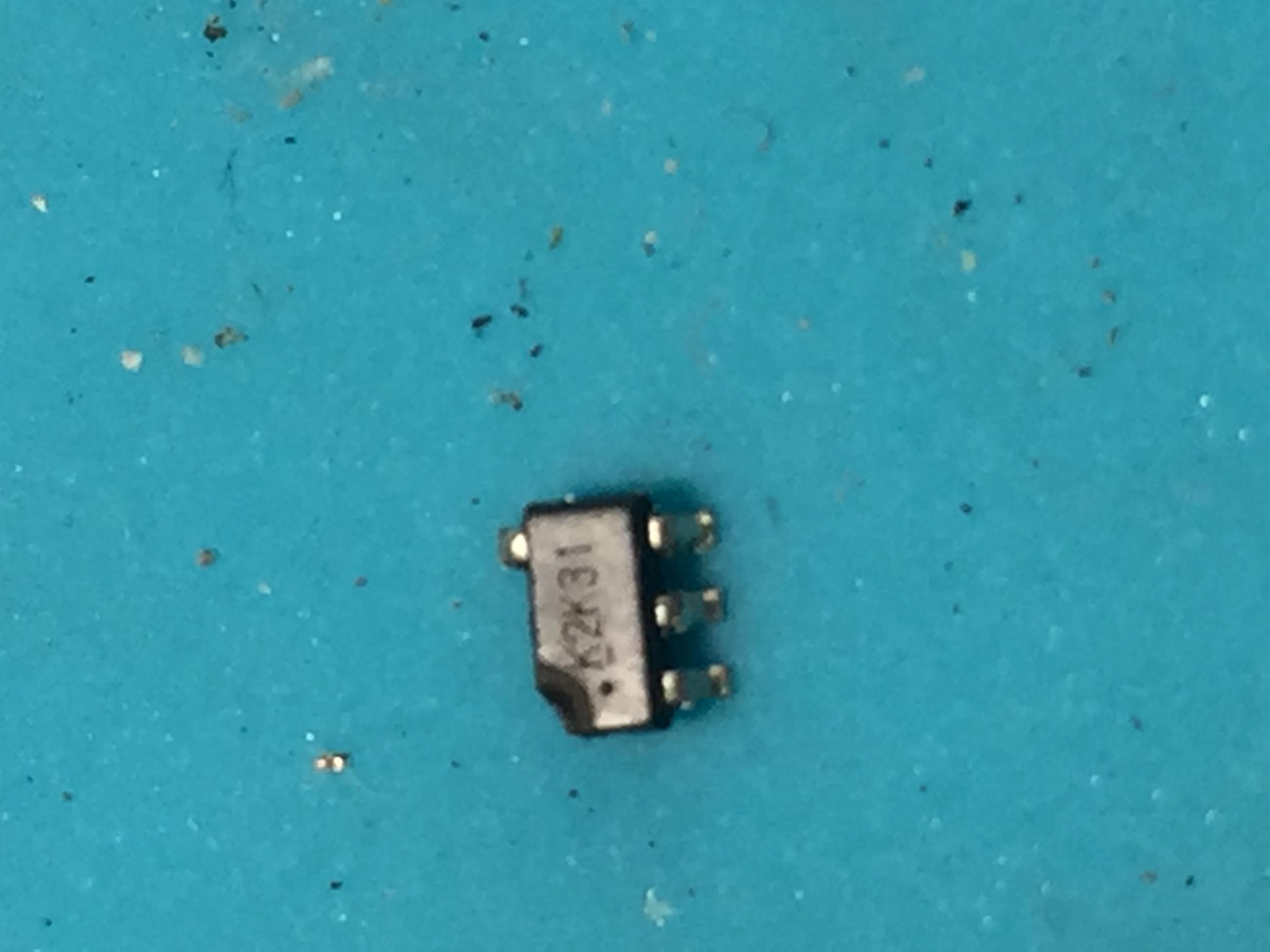

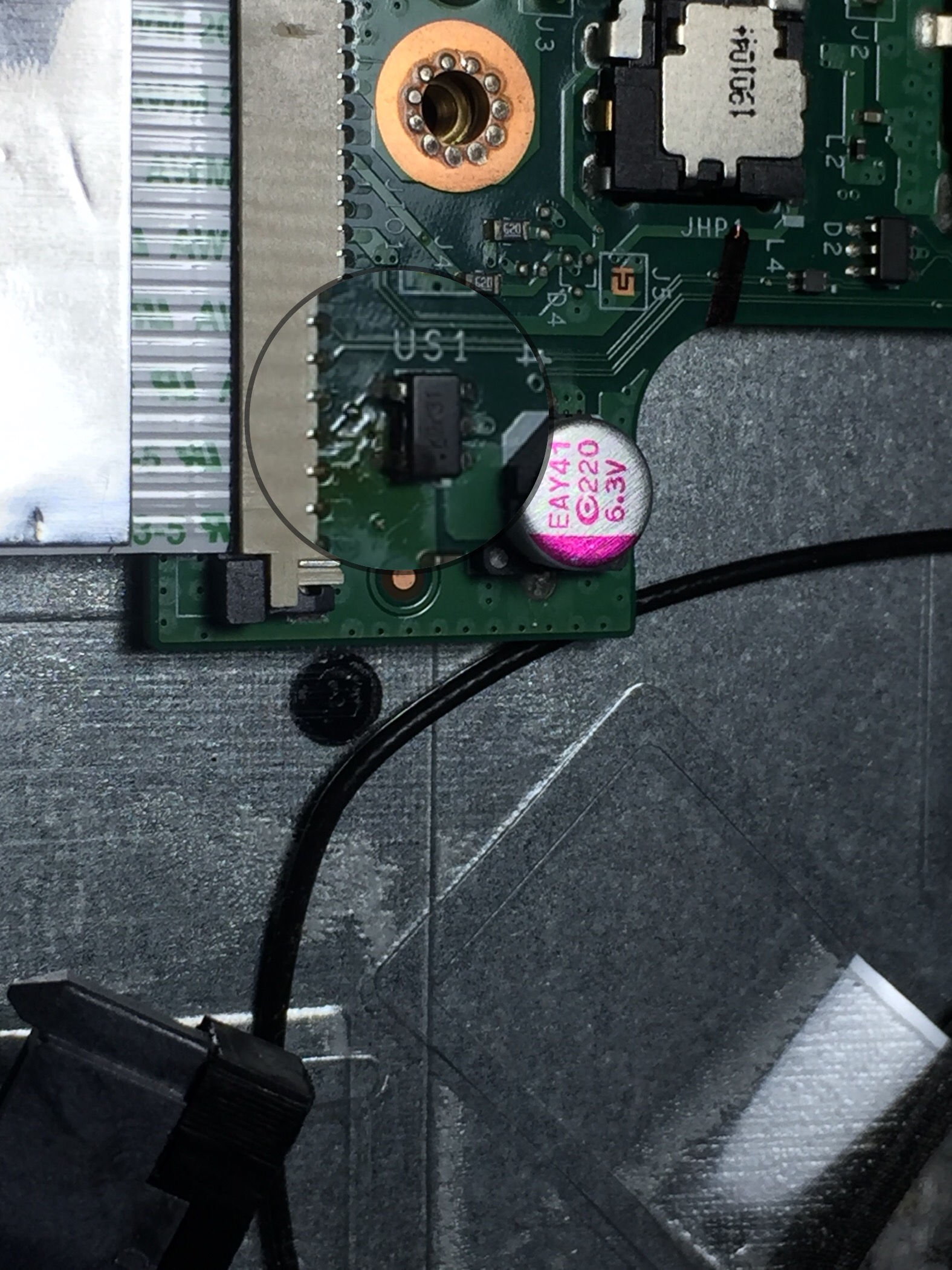

        i dont have a clear photo i have upload again the chip removed the board id C5V01 LA-E891P

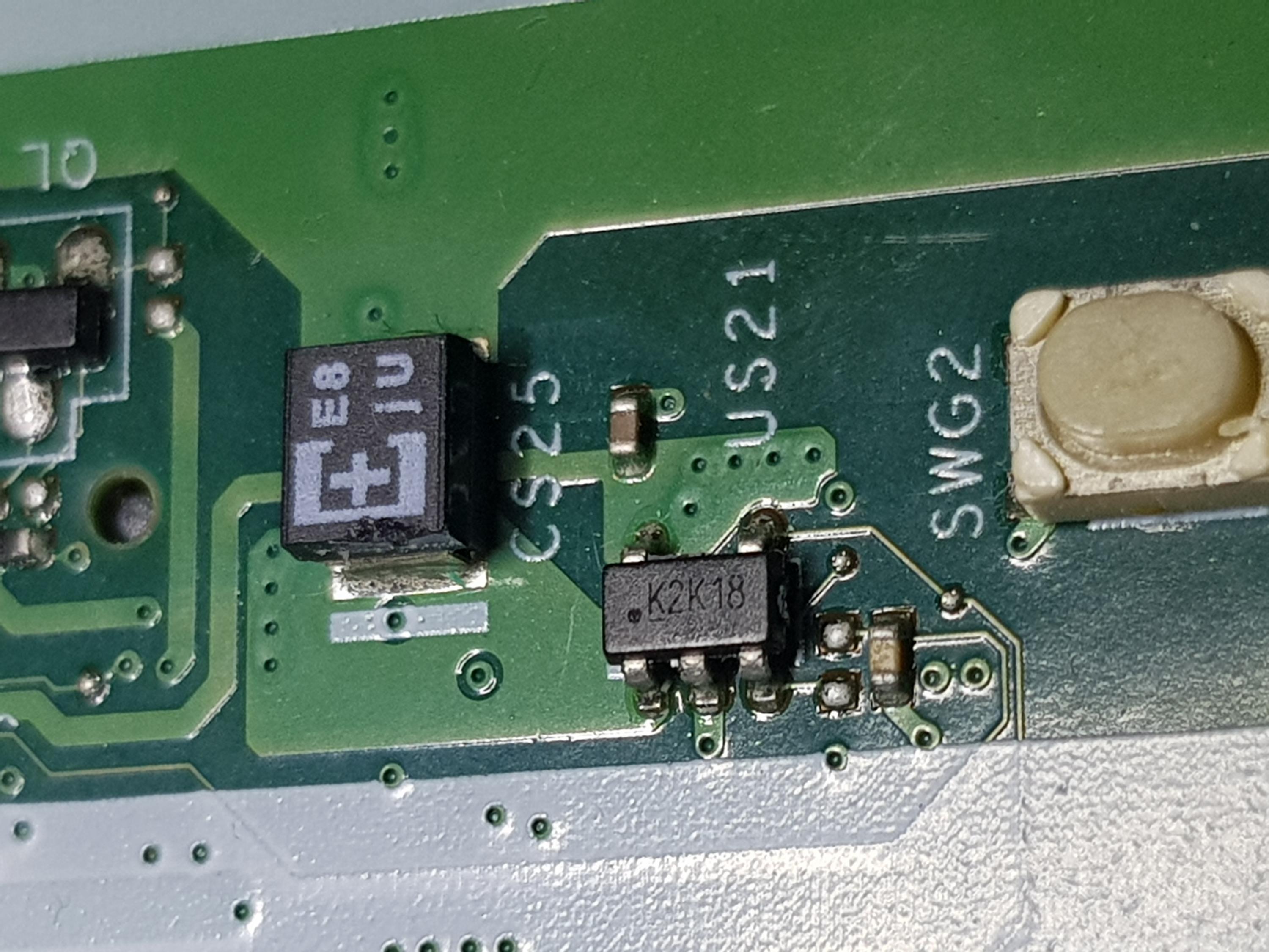

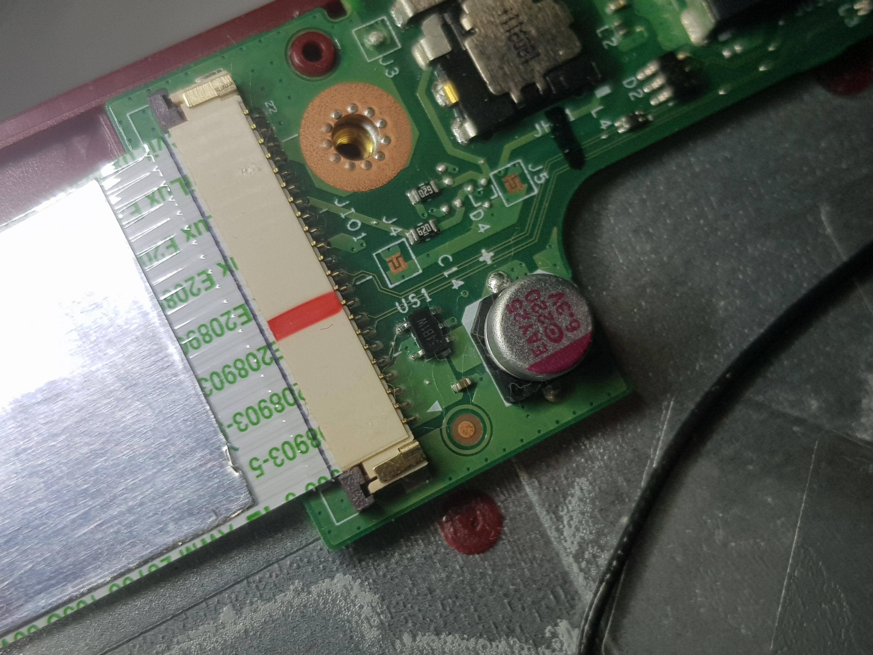

          This is exactly the same as US21 smd on the same board LA-E891P... you can find the schematics here:
          https://www.badcaps.net/forum/showthread.php?t=75826
          As mentioned before it is providing usb 5v ...
          If you have donor boards check near usb ports for a similar sot23-5 chip...
          The chip you mentioned is k2k + 2 digit part number..
          You can replace it with 54B+2 digit part number or
          SY6288C20AAC as per the shematics...
          I have attached some photos to make it easy....
