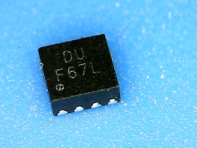

Hi Friends.
I have an ASUS GTX1060 Turbo graphic card.
One of the mosfets was shorted. And all the mosfts drivers were defected (shorted) ..
I have replaced the shorted mosfet. And couple of the 2.2ohms resistors. And because i could not recognise the mosfet drivers on board i choosed NCP5901B based on pinout (mainly the GND pin) ..
Now the card turns on and post screen . Everything seems ok until the driver is installed then the screen goes blank and the card fan runs at Max speed. Also the pc is not responsive.
I would like to hear your advices on the mosfet gate driver that i replaced. I suspect it to be the cause as i could not recognise the original mosfet driver from its marking code.
I have attached the old defected gate driver photo maybe someone would recognise it..
Thanks.
