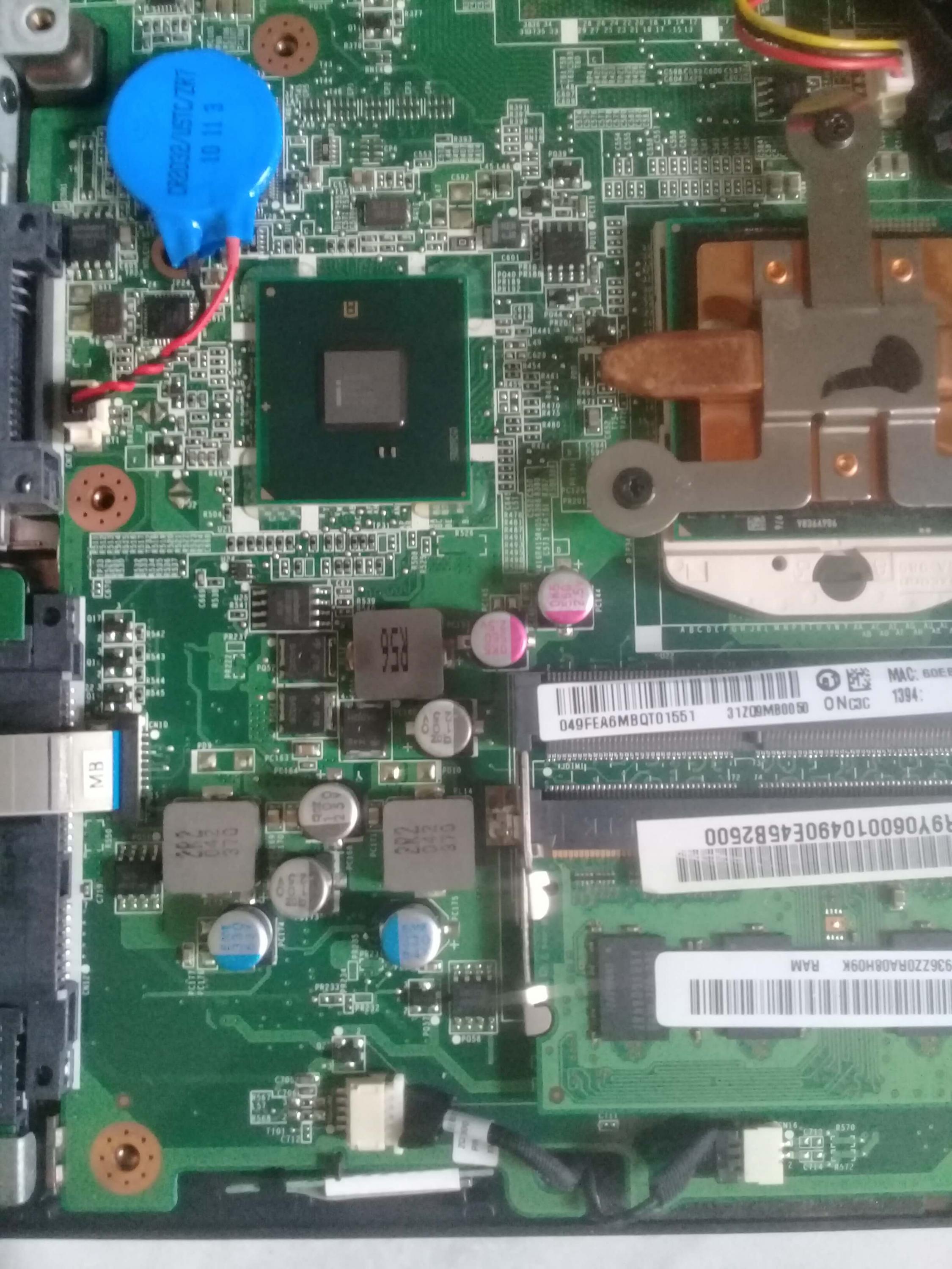

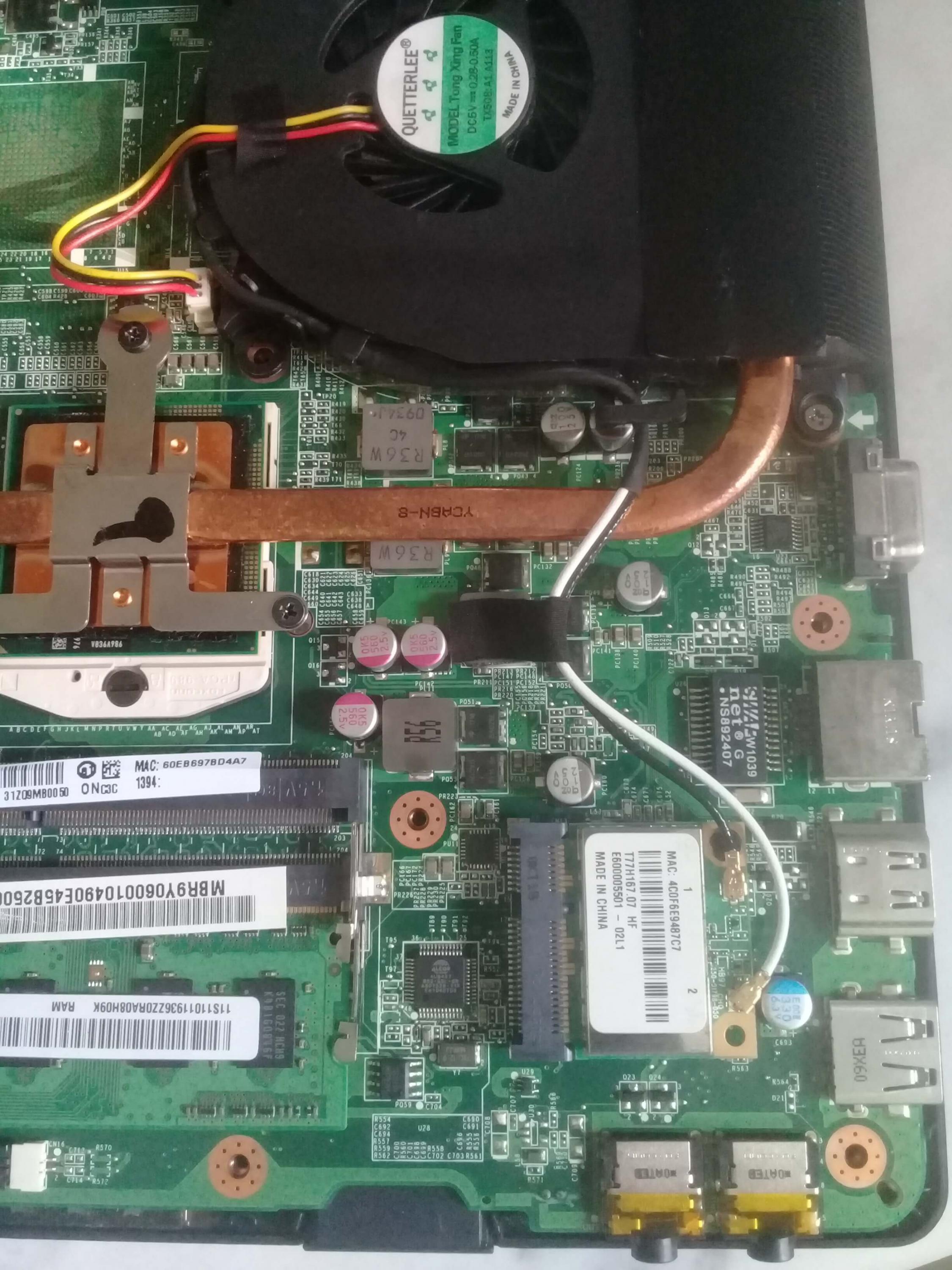

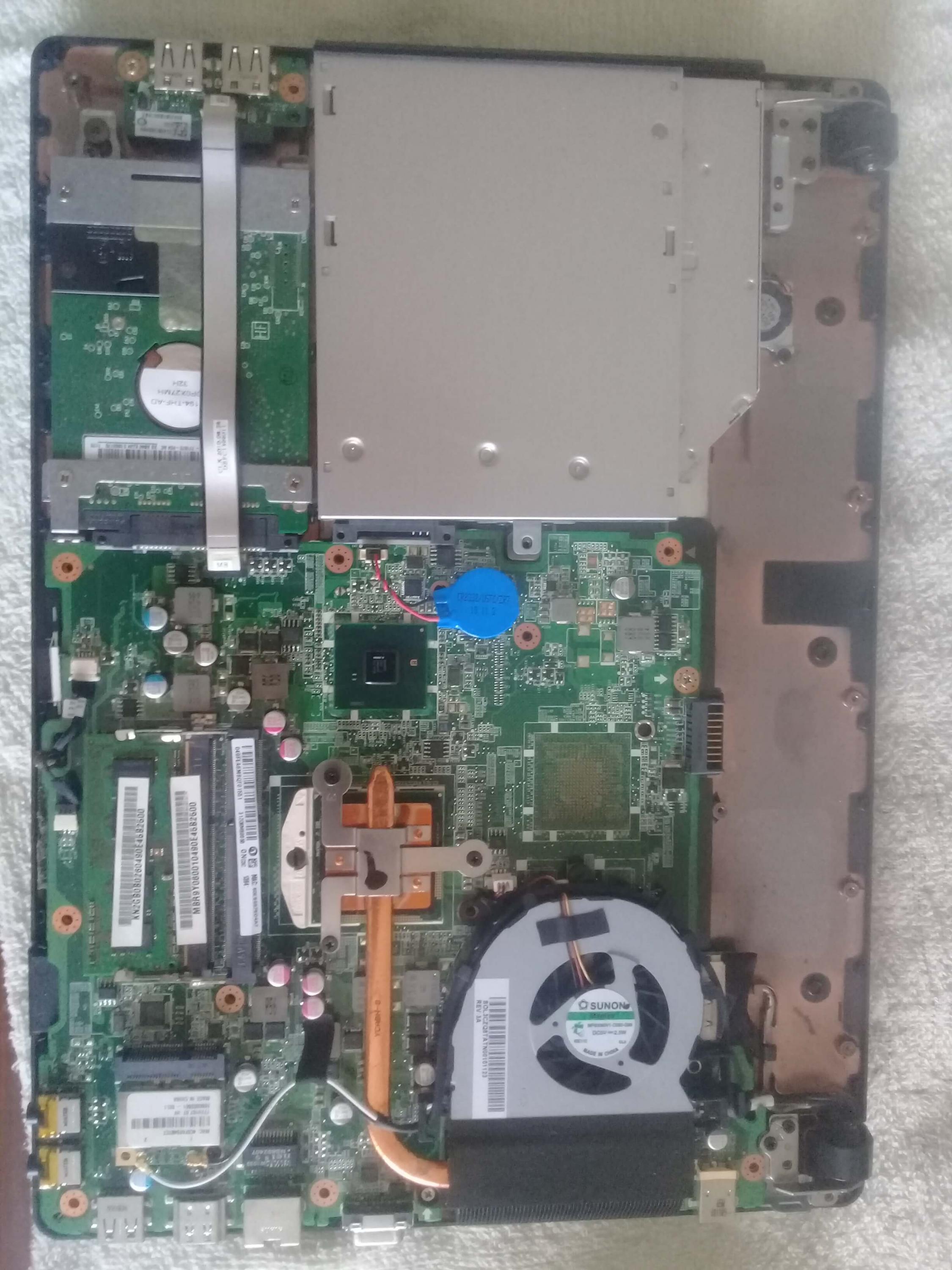

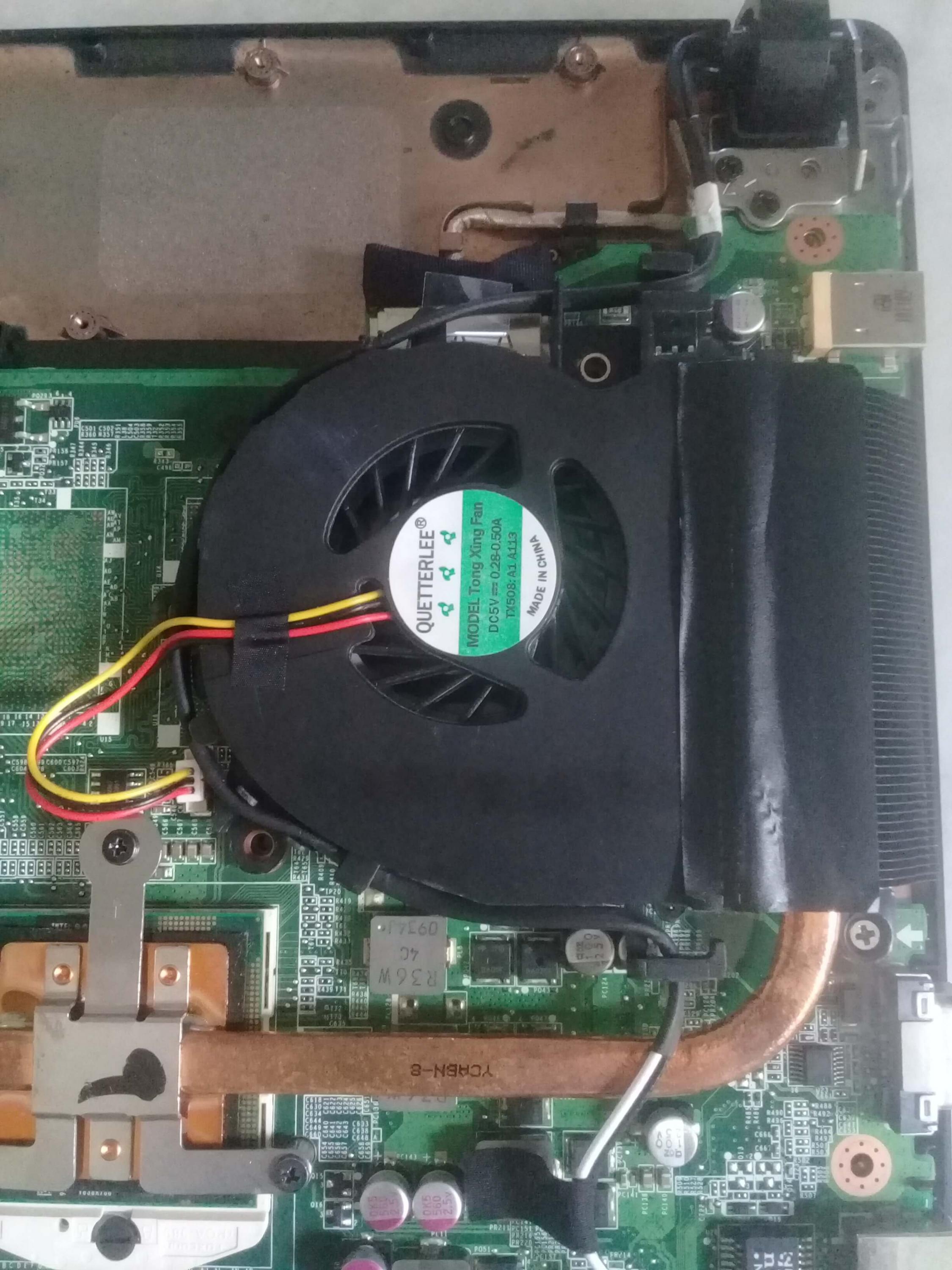

Acer Aspire 4738 dark display after 2 minutes
  • mikey5791
    • Dec 2014
    • 521
    • Malaysia
    This is a previously working Acer laptop
    but two months ago it started to show symptom of sudden blank dark display with blue led power and fan still on.
    Sometimes it is a blue screen saying i might have changed a hardware, etc...
    The whole screen will freeze and i need to press power button to restart. But the same issue of blank display return.
    Initially i thought is a heat problem. So i changed to a new thermal fan but the issue is still the same. I also try changing to a different hard disk, reseat the memory card. But the same issue remains. I attached a picture of the motherboard for reference.
    On hand i have a dmm, with some basic
    soldering skill but i wish to diagnose and repair this laptop if someone is kind enough to guide. Thank you in advance.

                      • RJARRRPCGP
                        • Jul 2004
                        • 6304
                        Re: Acer Aspire 4738 dark display after 2 minutes
                        Originally posted by mikey5791
                        blue screen appears today displaying the message "A problem has been detected....The system encountered an uncorrectable hardware error. Technical info:
                        Stop:0X00000124"
                        May be bad CPU caps. (SMD caps on the motherboard, possibly faulty NEC/Tokin caps)

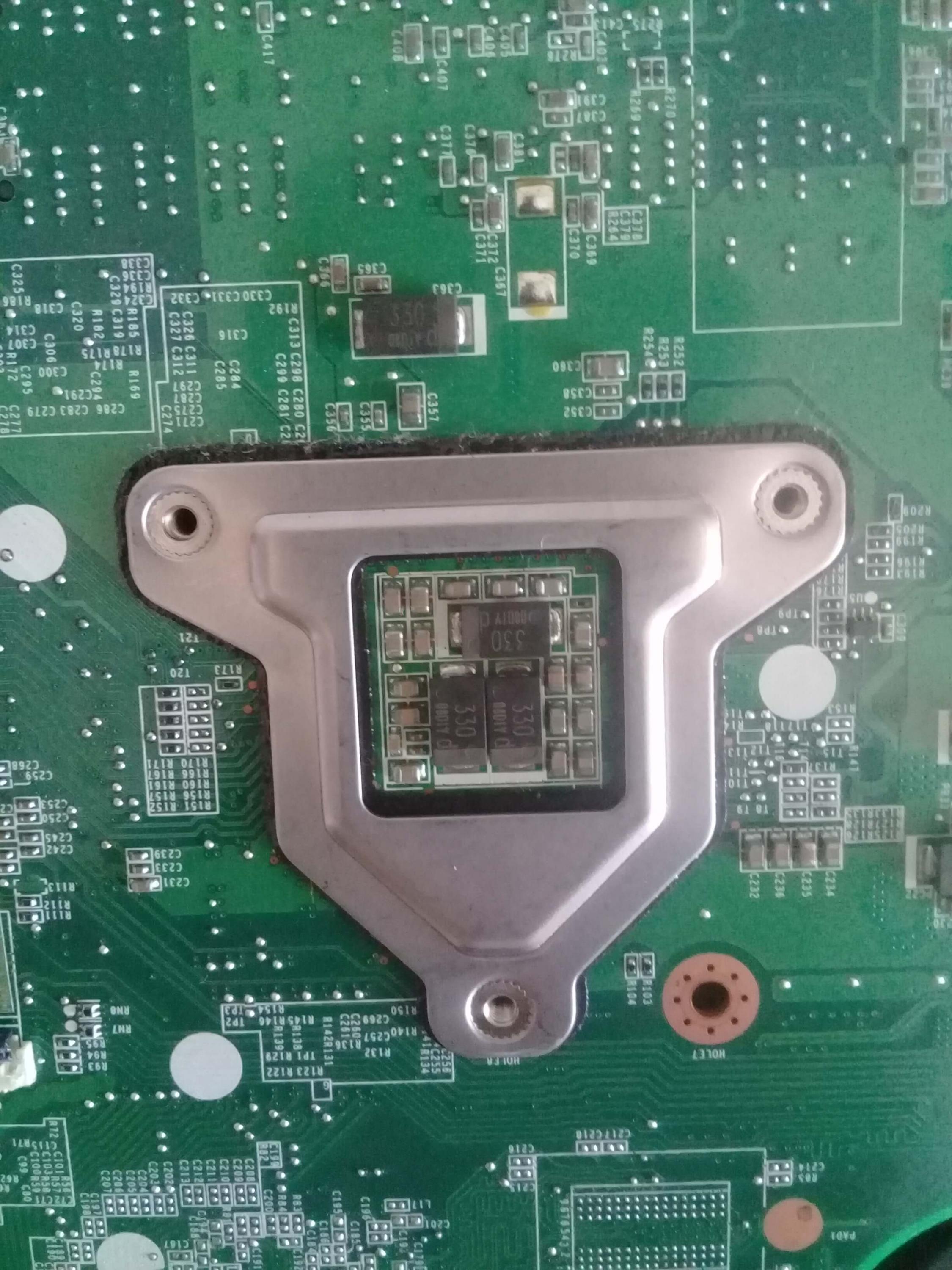

                            • RJARRRPCGP
                              • Jul 2004
                              • 6304
                              May i know where do i start checking for bad CPU caps since i have no idea. On hand i have a dmm and capacitor meter. Do i need to desolder those smd caps to test it? I am attaching 4 images of the board. Please guide me. Thanks.
                              Do you on the back side of the motherboard see what look like four rectangular SMD components? (where the CPU is, look on the back side of the motherboard)

                                • mikey5791
                                  • Dec 2014
                                  • 521
                                  • Malaysia
                                  Just the second day the laptop can start power on but failed to boot to windows now.
                                  Yes, i saw 4 rectangular smd components on the back of cpu. Marking is 330. Looks like capacitor? Should i proceed to test it using my capacitor meter? I attached an image for reference.
                                  What should i do next? My sincere thanks for patiently guiding me and i do appreciate much.
                                  • emestee
                                    • Dec 2019
                                    • 228
                                    • Bulgaria
                                    These are the tantallums and they do fail sometimes, but you probably should pull them out and not test them in circuit.

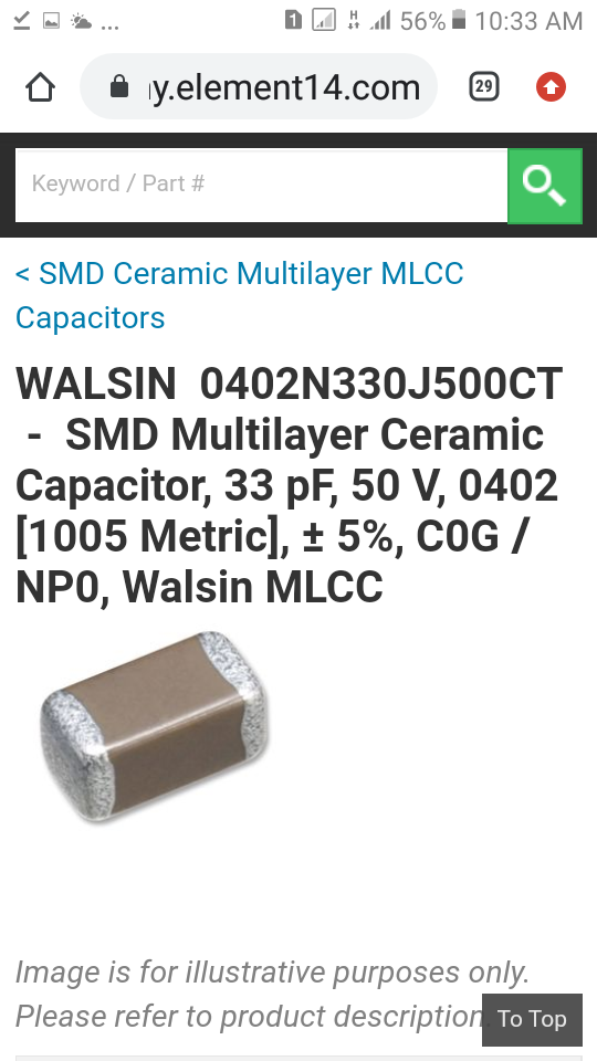

                                      • mikey5791
                                        • Dec 2014
                                        • 521
                                        • Malaysia
                                        Are those rectangular shaped caps (marking 330) 33pF? I have not desolder them out of circuit to test yet. I know this has to be carefully done.
                                        Btw, from my area i googled the nearest option to get this replacement(if needed) is ceramic type. I attached a picture for reference. Can this be used as substitute?
                                        Your advice is greatly appreciated.
