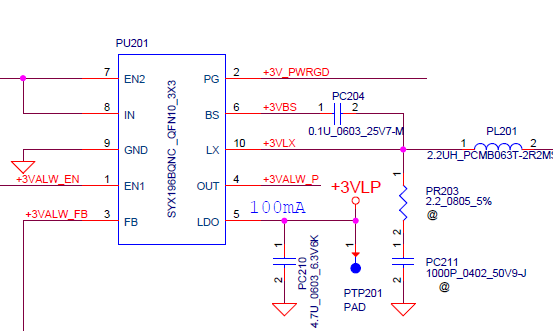

    Make sure your multimeter batteries are good. +3VLP should never go to 3.8V, it is what's causing EC_ON to go to 3.8V as well. If you are 100% sure +3VLP indeed goes to 3.8V, then PU201 is probably bad.

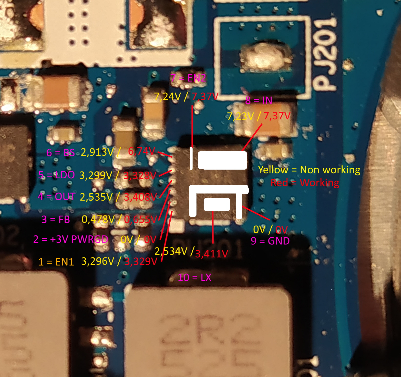

          Good evening, i have the Same model with a similar issue.
          MOD Edit: Link to schematic - https://www.badcaps.net/forum/showthread.php?t=65129
          History: bad GPU- & RAM-Controller. Gate from LowSide mosfet was shorted to ground on both ICs.
          After replacing both ICs i can do a "Cold Boot" (battery and Adapter disconnected and reconnected before) and It's booting to OS without Any issue. but if i shut it down and try to Power it on Second time, i get No Backlight, No Display, No BIOS (CapsLock-test), dimmed LEDs, etc.
          In my case the +3VLP is dropping from 3,3V to around 2,5V. i Wonder if the Voltage of B+ (thought it Has to be 19V) is okay? If Yes, i believe i have to replace PU201 too... The +5VLP Rail is working fine with Same Input Voltage.
          The weirdest Part is, it is working after Cold Boot, although i never get a PWRGD from this IC... o.O

            Re: lenovo yoga 3 14"
            Please confirm
            Ldo is not dropping
            If ldo drops in any case , ic will not go to next step
            Your output is dropping due to capacitor leakage or missing after coil and feedback value is not ok
            I am not an expert I think it is nvdc technology ,b+ feeder to every section as an input voltage , 8v approximately
            • Sephir0th
              • Oct 2020
              • 1289
              I can confirm the LDO isn't dropping, but The Phase on the Coil. And yes, It's NVDC, my first Laptop with a Charging Circuit Like this. Thank you, i'll Check the Caps First.

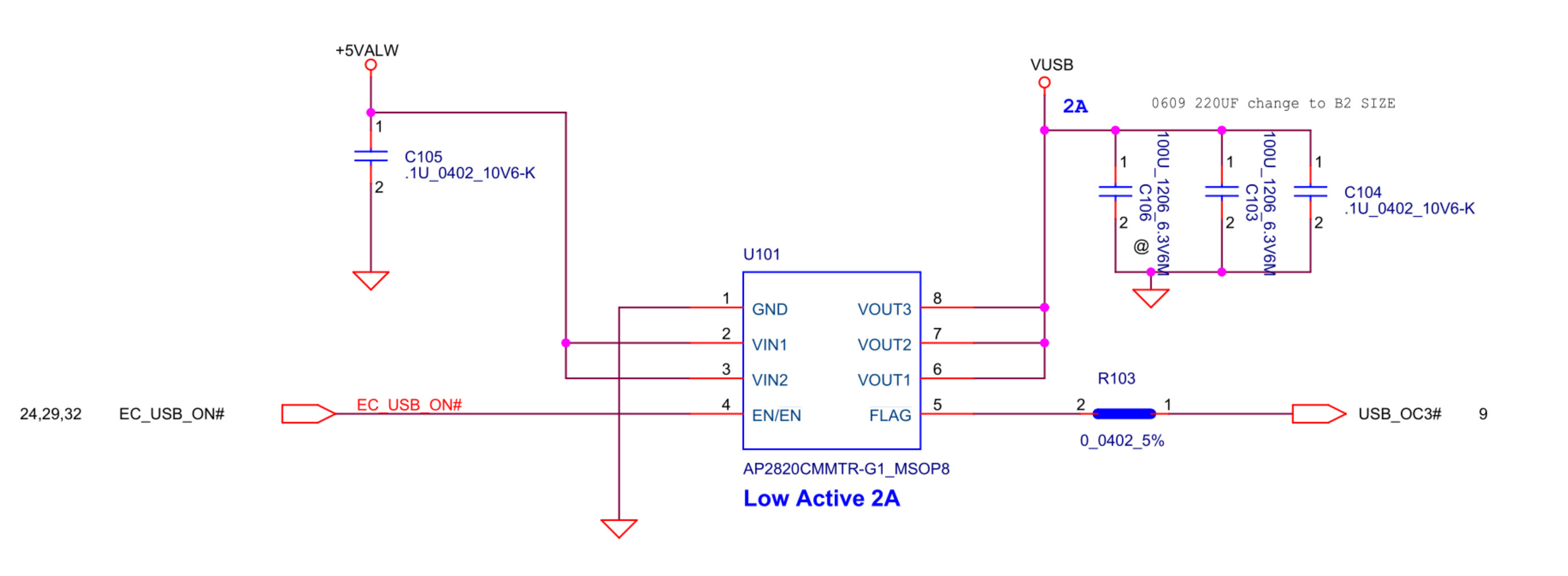

                    @sopik78
                    You are a life saver. Thank you.
                    After removing U101 to confirm that the board will turn back on, it does!
                    • mon2
                      • Dec 2019
                      • 14659
                      U101 = USB Load Switch.
                      Respectively, if removing this load switch works for you, this implies the load switch is defective and was shorted.
                      By removing U101 off the board, that local USB port or ports will no longer function since Vbus is no longer being passed through onto the connector(s).
                      You should seek out a replacement so that port will be functional once again.
                        I appreciate the concern. As mentioned I removed U101 to verify that it was causing the issue.
                        A replacement IC has been ordered and will make the replacement when arrives.
