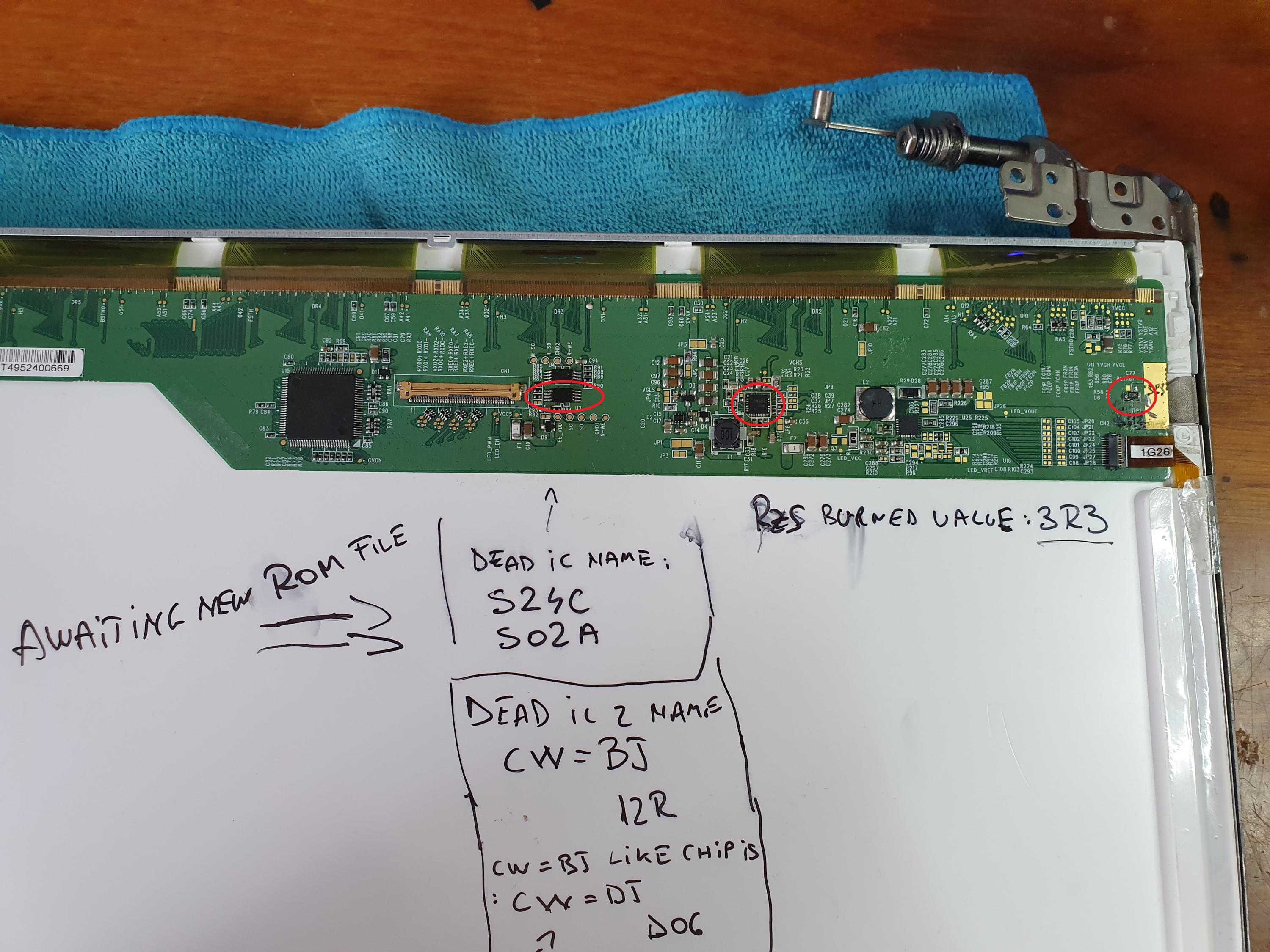

    The 2 IC`s are just for displays. Do you have ebay in your country ?

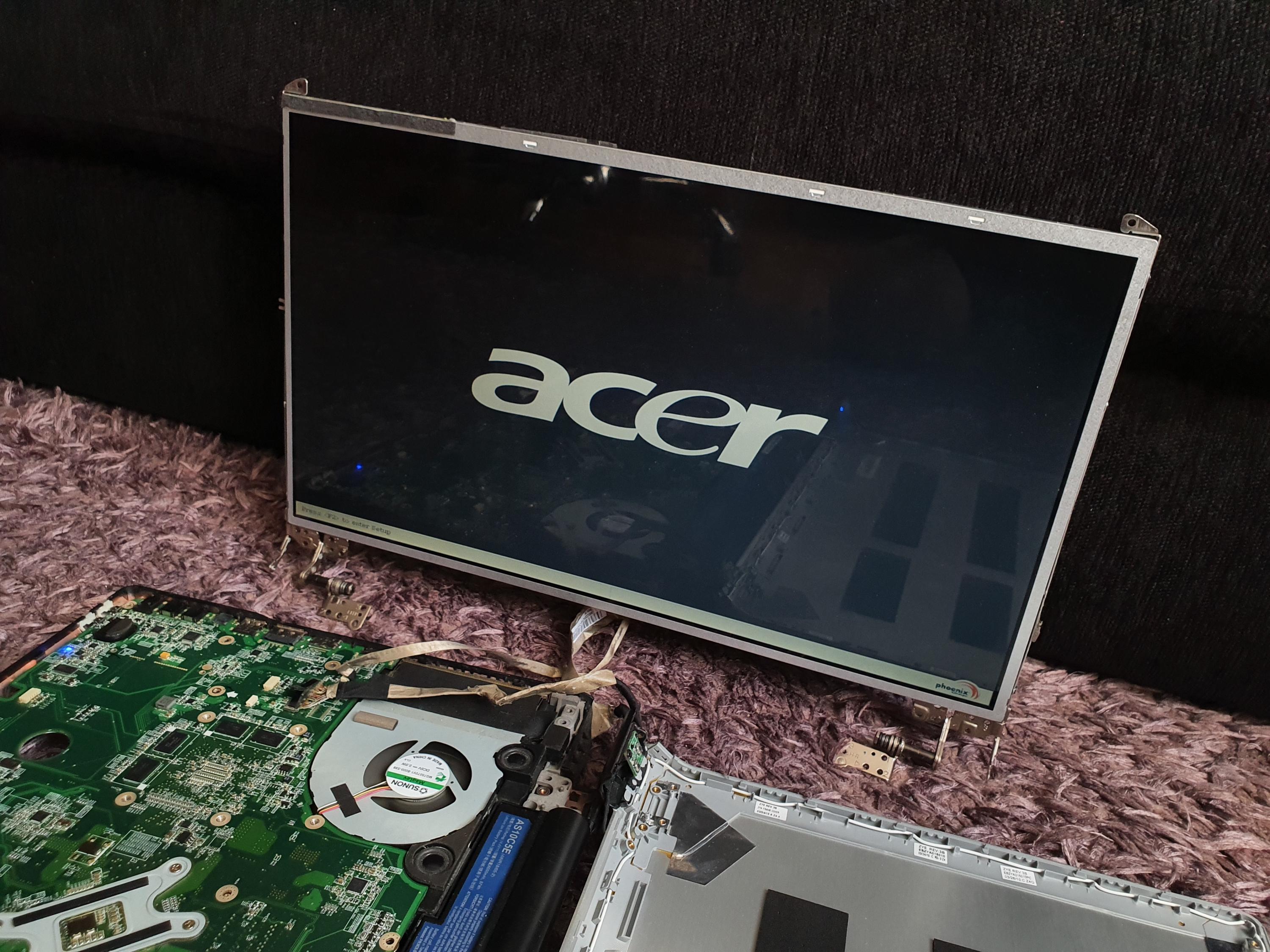

        Re: Acer 8943g shorted motherboard with LVDS connector
        Hello again , ive managed to repair the display the components arrived from China much faster than i expected !
        Only the first ic was damadged ( RT9921CGQV ) , the second one was fine ,
        Now i only have to replace the LVDS connector on the motherboard ( ordered a bad motherboard from Romania , it will arrive next week ) because its damadged ( melted at 2 pins ... ) but it works , the display is fine now !
        Thank you SMDFLEA for your help , without you i could not fix this display, heck i didnt even know that displays have eeprom on them , many thanks again from Romania - Oradea .
