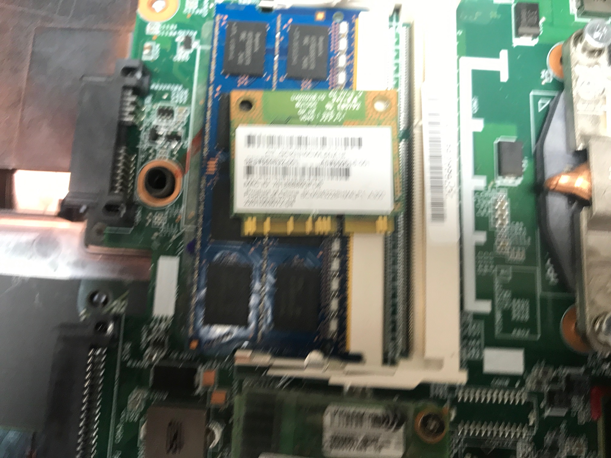

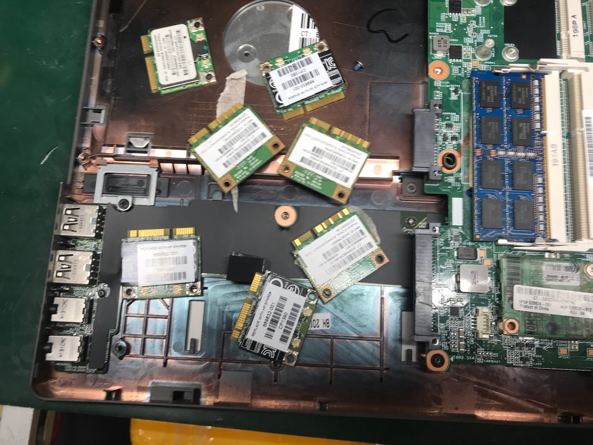

    I have a problem with a HP6560b.
    When I turn on the laptop, first I get a message from the photo I added. 10 second later the Win starts, but it doesn't detect the wifi card.
    I flashed a bios chip, I changed 9 different wifi cards. I always get the same message.
    I have heard about a white list and a black list. Is that what my problem is about?
    Can anyone help?
    There isn't a similar topic on the forum.
    Thanks.

    Re: HP 6560b Wireless Module not supported
    The manufacturer, by programming the Bios, loads some drivers for the wifi cards, which it will detect.
      Originally posted by pepegotera454
      El fabricante mediante la programación de la Bios, carga unos drivers de las tarjetas wifi, que esta va ha detectar.
      No.The problem is wifi card compatible issue.
        put in original card type or search for "whitelist" bios

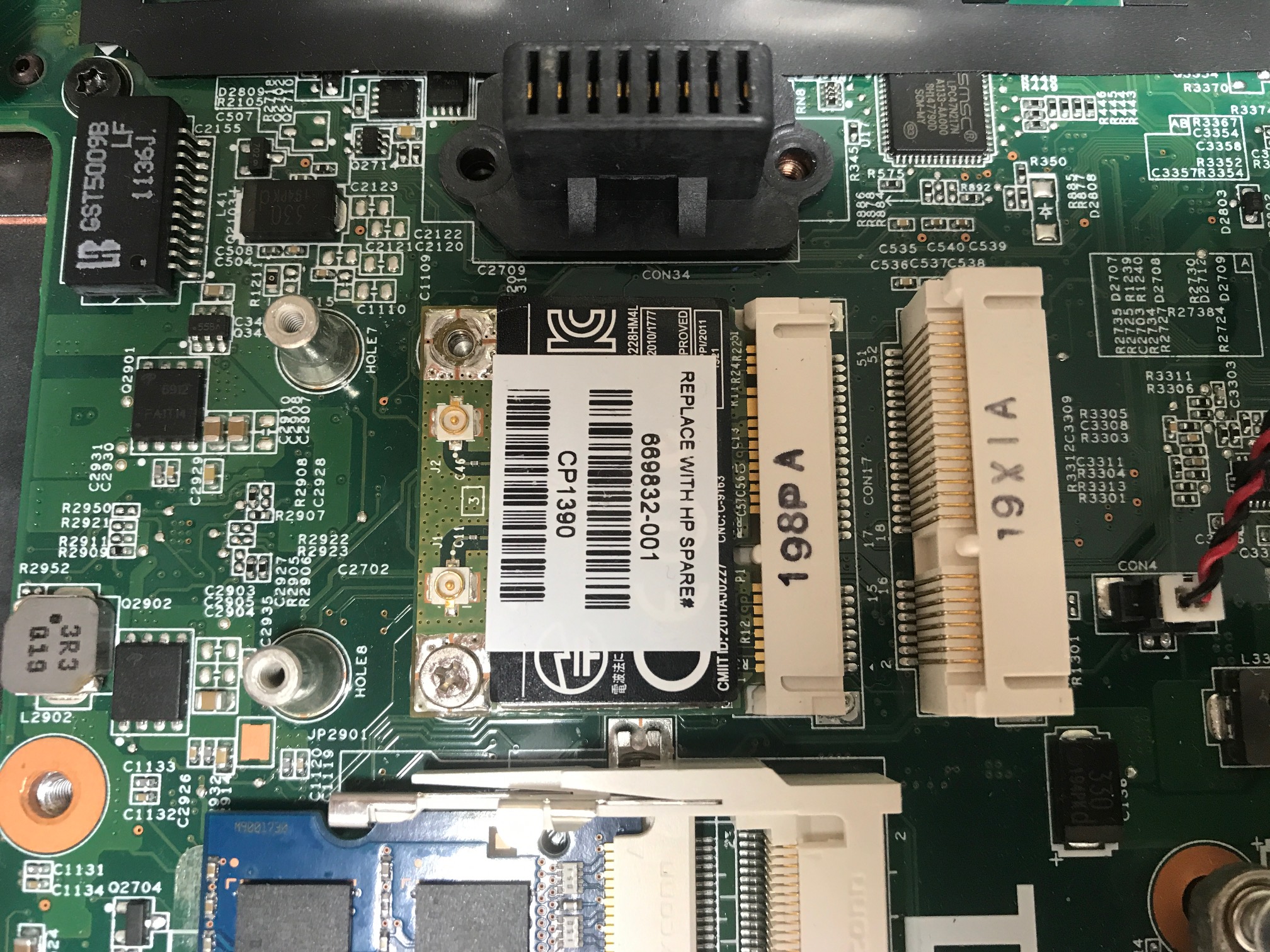

          Thanks everybody,
          I have found wifi card on HP 6360b, which is compatibile with hp6570b white list.
