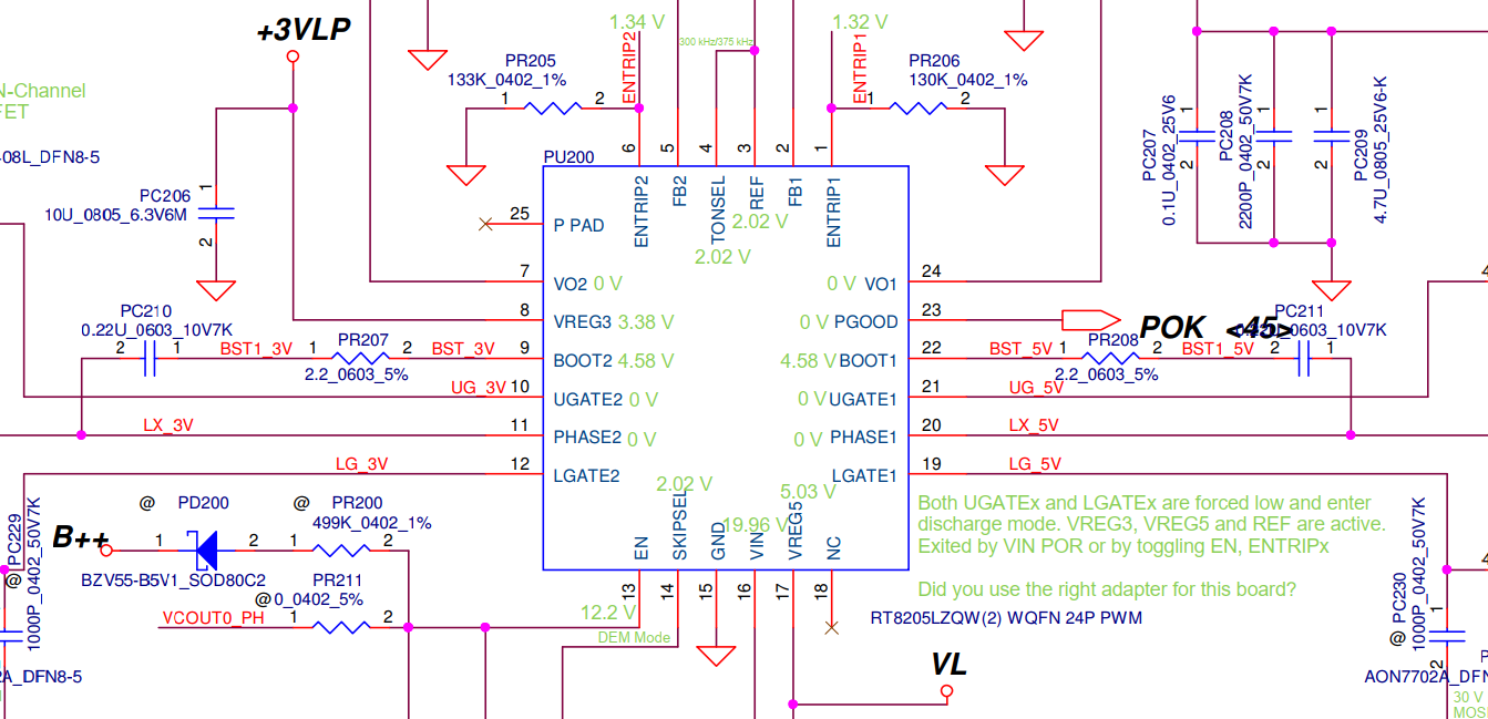

Dell Inspiron 3521 [La-9104p] no power

    Re: Dell Inspiron 3521 [La-9104p] no power
    Originally posted by classicandy
    By VCC, did you mean VDDP_LDO? because, that's the only pin with 5v on PU100.
    Or probably, external 5v would more preferable.
    I'm talking about +5VALW pin 11 of PU100. It comes from PU200 (+5VALWP --> PJP202 --> +5VALW).
    • classicandy
      • Apr 2018
      • 309
      • Nigeria

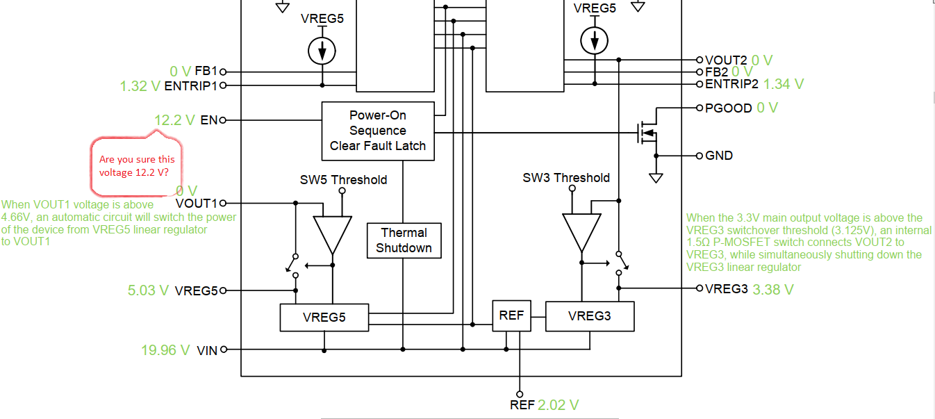

      Ok, I know of Pin 11 with +5VALW. I meant which other Pin you wanted me to connect Pin 11 to. Of which Pin 21 (VDD_LDO) gives out +5V also.
      By the way, I have changed my Multimeter probes and measured Pin 13 of PU200 and now I'm getting 0.13v on both boards. The charging led goes off when I touch Pin 13 with my RED probe (for the other unit that Powers On).
      Am I doing it correctly?
      What is supposed to be the correct voltage on Pin 13?
      Also, I'm using a 90W charger. I have 3 units of this particular Dell motherboard and the charger works well with the other two that Powers On and charge battery.......
          I THINK YOU MISS SOMETHING HERE AT
          UE1
          Pin 115, LID_SW# = 0 VOLT
          IT SHOULD BE 3.3 VOLT ON IT
          • classicandy
            • Apr 2018
            • 309
            • Nigeria
            UE1
            Thanks. No 3.3VALW present to power LID_SW#
                Then why not check LID Switch ??

                      #30
                      LID Switch is on a separate board (power button board) which is not connected.
                      I have two other motherboards of this model which have 3.3V on LID_SW# when the power button board is not connected too. 3.3V present at Pin 115 of UE1 on both motherboards
                      Where else can I check?

                          #32
                          Great
                          Cheack PU100 pin 7 impedance
                          • qayyum786
                            • Aug 2018
                            • 1959
                            • INDIA
                            #33
                            PU100 pin 7 Is it short to ground or good impedance ?
                            Charge Enable (pin 7) should be 3 volt

                              #34
                              Hello, Please I have this Dell Inspiron 3521 [La-9104p] that is dead. There is no visible damaged component. It just tripped off while booting one certain day and has not powered on since then. Doesn't charge either.
                              I have replaced PU200 [3.3V/5V IC]
                              Currently, when I connect the charger;
                              B++ is present
                              3.3VALWP/5VALWP not present
                              VREG3 and VREG5 is present
                              PGOOD is not present
                              RTC is ok.
                              Where else do I need to check to determine the fault?
                              check pq200 3v5v ic pin numper 09 boot2 and pin number 22 boot1 ,,both pin near once 2R2 resisitor ,90% precent sure it is gone,,check multimeter beep mode or resistence value,,,i fix it same your problme,,common fualt this compal board,,pin 09 boot2 near resistor check,,
