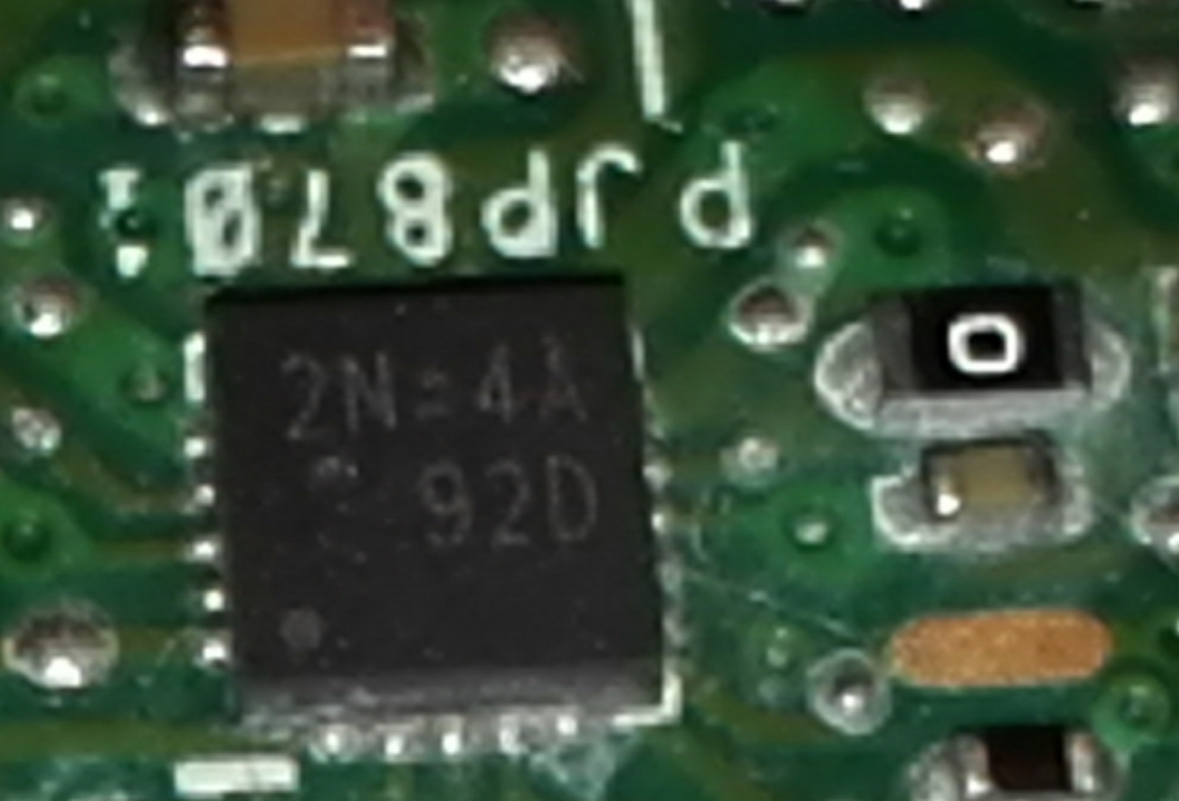

asus x510UQ chip name/number needed!

    I have a chip(2N=4A 92D) from asus x510UQ motherboard. Does anyone know this chip,and send me the correct name/number of the chip for ordering?

    Re: chip name/number needed!
    Maybe this is correct.
    https://www.aliexpress.com/item/32809899809.html
      "2N=" QFN-20 package = Richtek RT8249CGQW
        Thank you for your quick answers.
