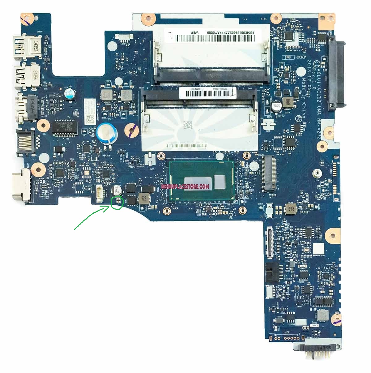

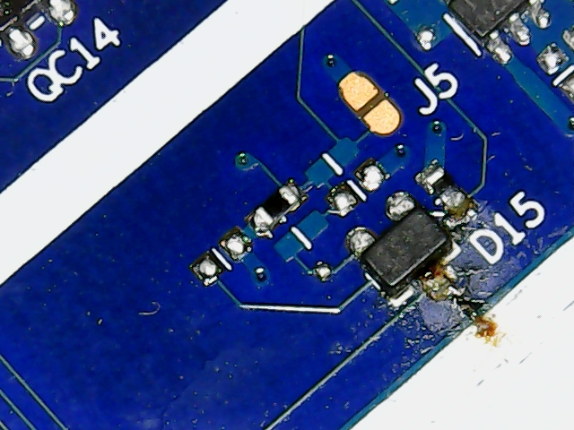

    hello from greece ..
    the motherboard is ACLU1/ACLU2 UMA NM A272 REV1.0
    i need thw types of this two componets
    U will see in photo
    THNKS

    On picture 1 (D15 Label) it's a diode - BAT54CW
    On picture 2 it's a capacitor, don't know the value, but it can be replaced by same physical size of it

      Thnk you for your answer .
      the type for the diode is BAT54CW 200mA, 30V, SOT-323
      for the capacitor i think i must know the value ...

        no u dont
          • 21219
          Re: LENOVO G50 -70 Types of part ..
          The schematic is here: https://www.badcaps.net/forum/showthread.php?t=48851
