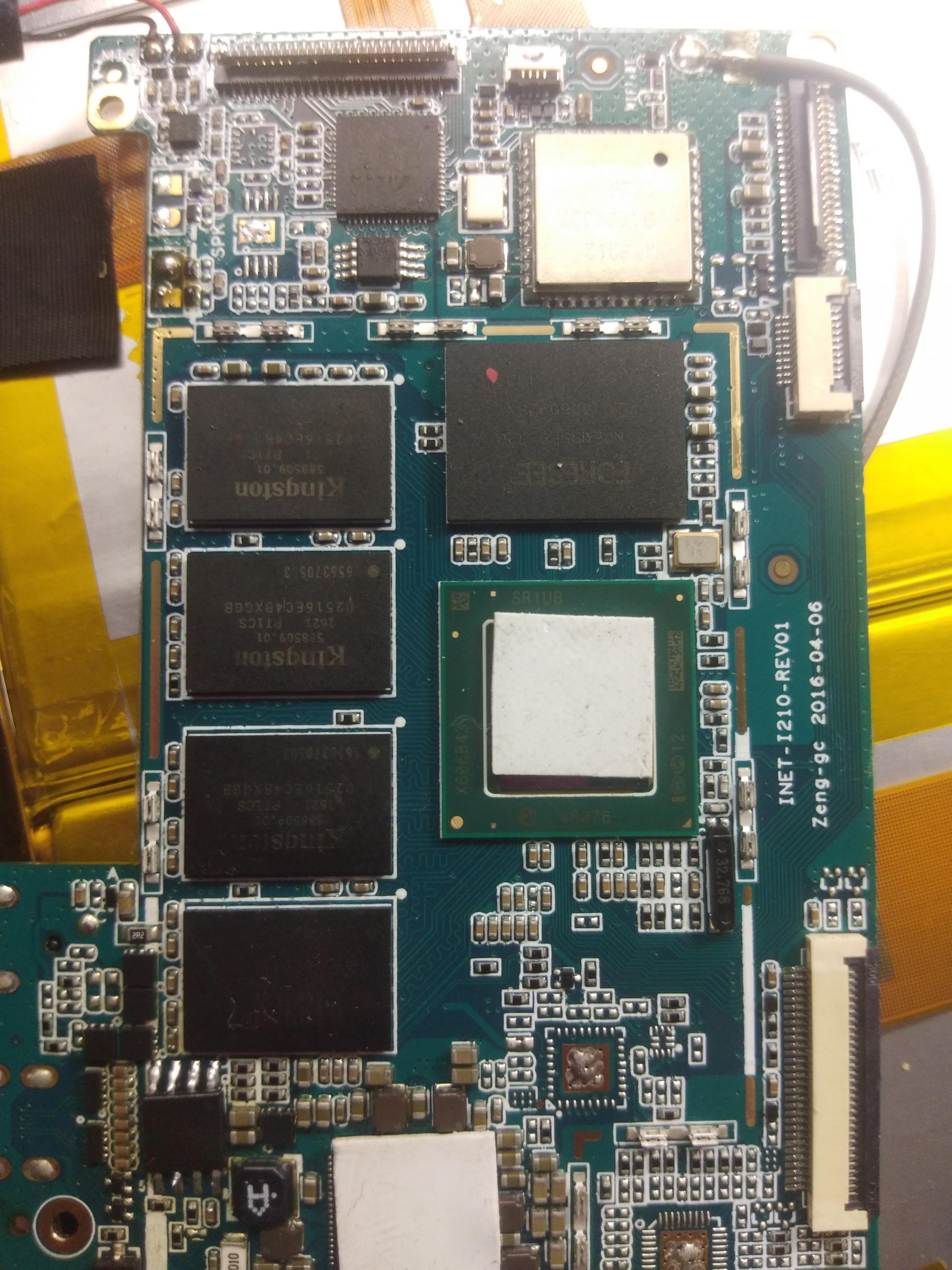

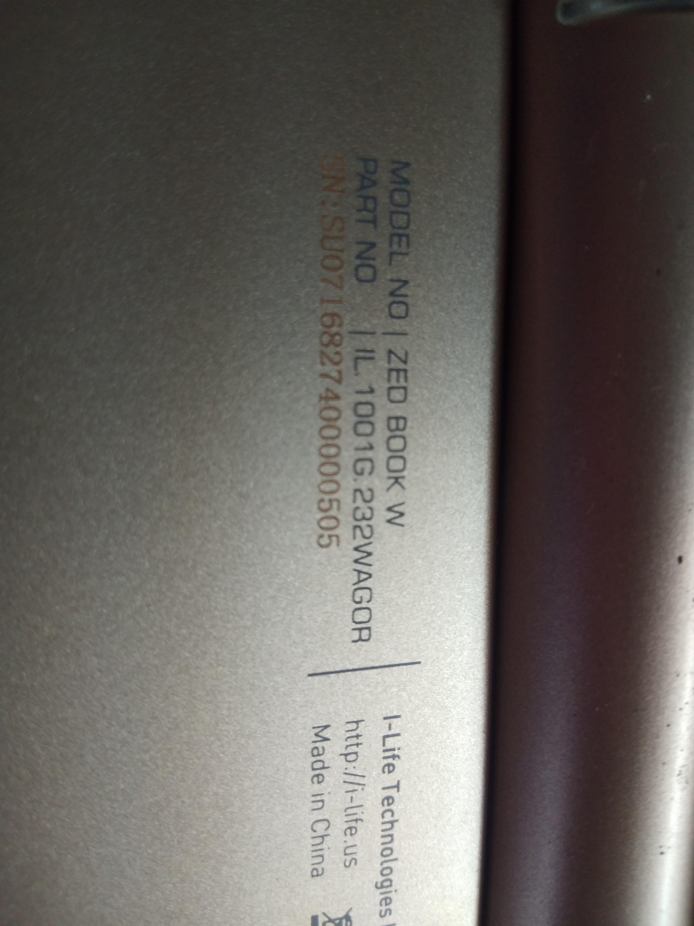

    Hi guy's i have netbook called Zed Netbook W now i accidentally disable the USB in BIOS
    now the keyboard and any usb attach is not working anymore.i tried to reset the BIOS (inet-1012rev01) using
    programmer but the problem is still the same.
    My question is how can restore it to original or default where the Keyboard is working? any chips i need to flash? or something please enlighten me...Thanks
    Here i attach the actual board
    MODEL: Zed Netbook W (i life)
    Borad id.: inet-1012-rev01

      Re: Accidentally disable USB from BIOS setup (how to restore it please help)
      Well if I'm right try to unplug the battery like an laptop... And seed if it looses the information keeped on BIOS.
      With reflash you should have defaults... I belive... But... On that device I don't really know how it works... But here's my suggestion, unplug or de-solder the battery (I belive you did it) and try to reflash once more the chip with right ROM and try with one release before the last available if you could get one and after that, resolder chip if you take it out to reflash and put battery back after all process and test
        try this .
        turn off the laptop and press the power button. Turn it on and immediately the power signal lights up, hit and hold the escape key. This will start the ZED Air Boot Menu. Click on the “Setup Utility” in the setup utility, hit the “F9” to load the default settings and then press “F10” to save the default settings and reboot.
          Thank you very much for the suggestion, this is an tablet/notebook type and the battery is not the ordinary as the laptop....it is the the as tablet or Phone type and i tried already.no luck.
          • rexelens
            • Feb 2020
            • 7
            • Philippines
            try this .
            the problem is the detachable keyboard is not working anymore or even the usb...i can go to to the BIOS Setup but the arrow and the option disable i can't type or do a work....
