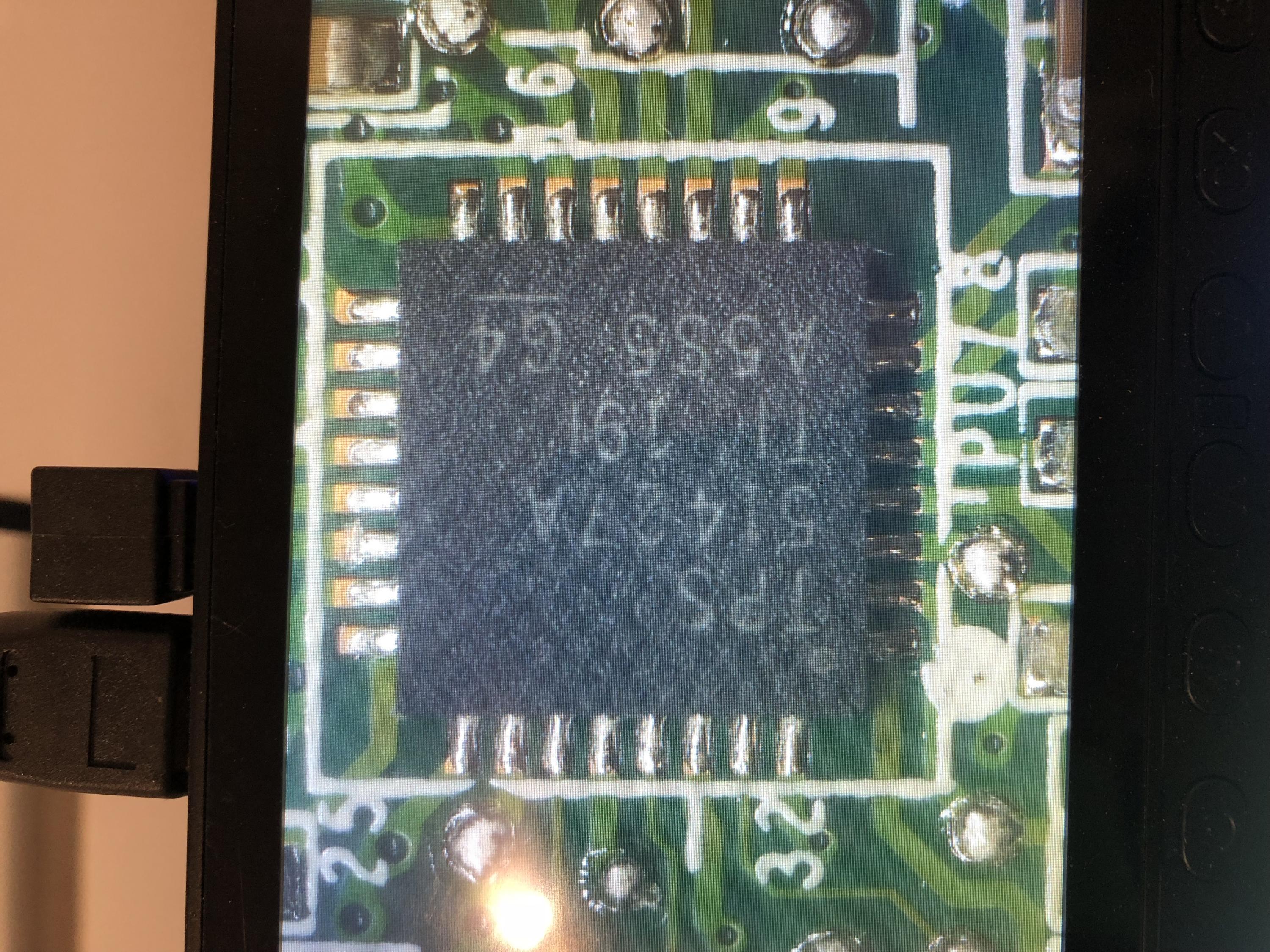

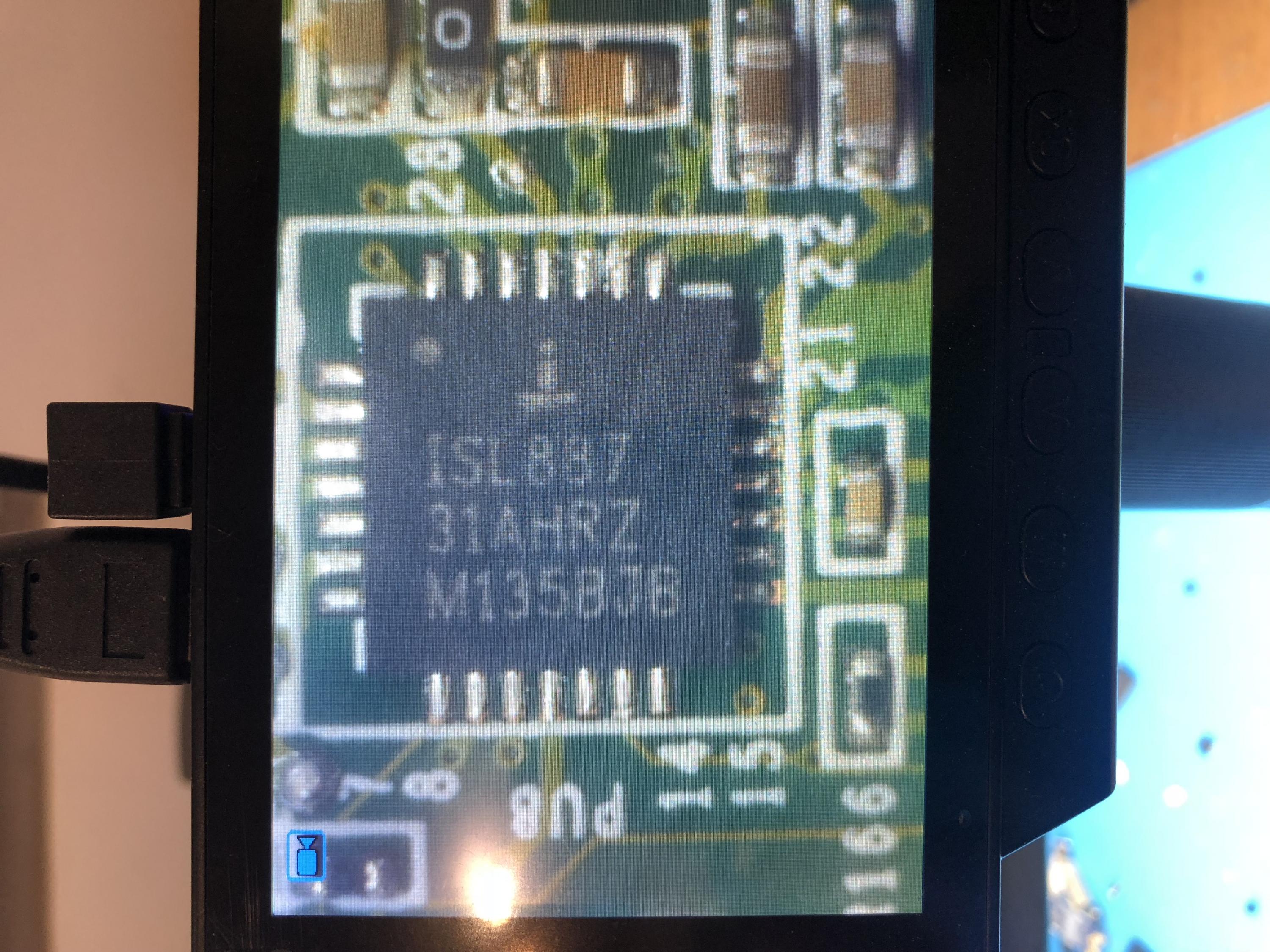

    i have a dell xps 17inch case model : p09e002 which according dell website corresponds to XPS 17 L702X
    i couldn't find a good schematic to match the motherboard.
    for example on schematic pu8 corresponds to RT8207AGQW and on motherboard i have isl88731... on schematic pu7 corresponds to isl99731...
    on schematics i have pu1 as TPS51427A, and on board is pu7 TPS51427A...
    anyone have proper schematics for this board?

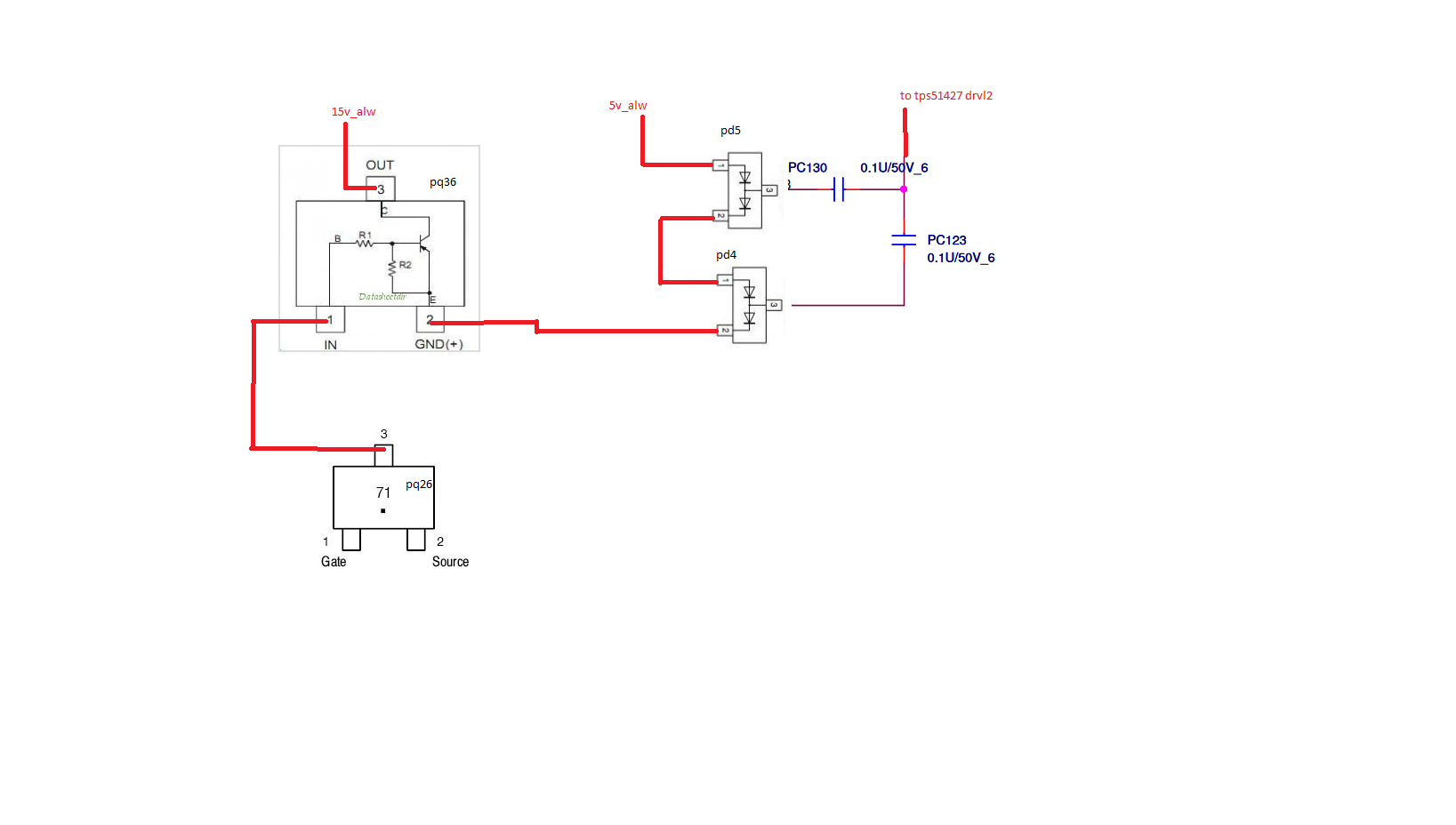

              +15V_ALW is created from +5V_ALW by a voltage multiplier using PD4 and PD5 diodes (and the capacitors around them). Output is on +15V_ALWP, switched on/off to +15V_ALW by PQ36. +3.3V_ALW is required as well since the switching of the gate of low-side MOSFET is what makes the voltage multiplier work.

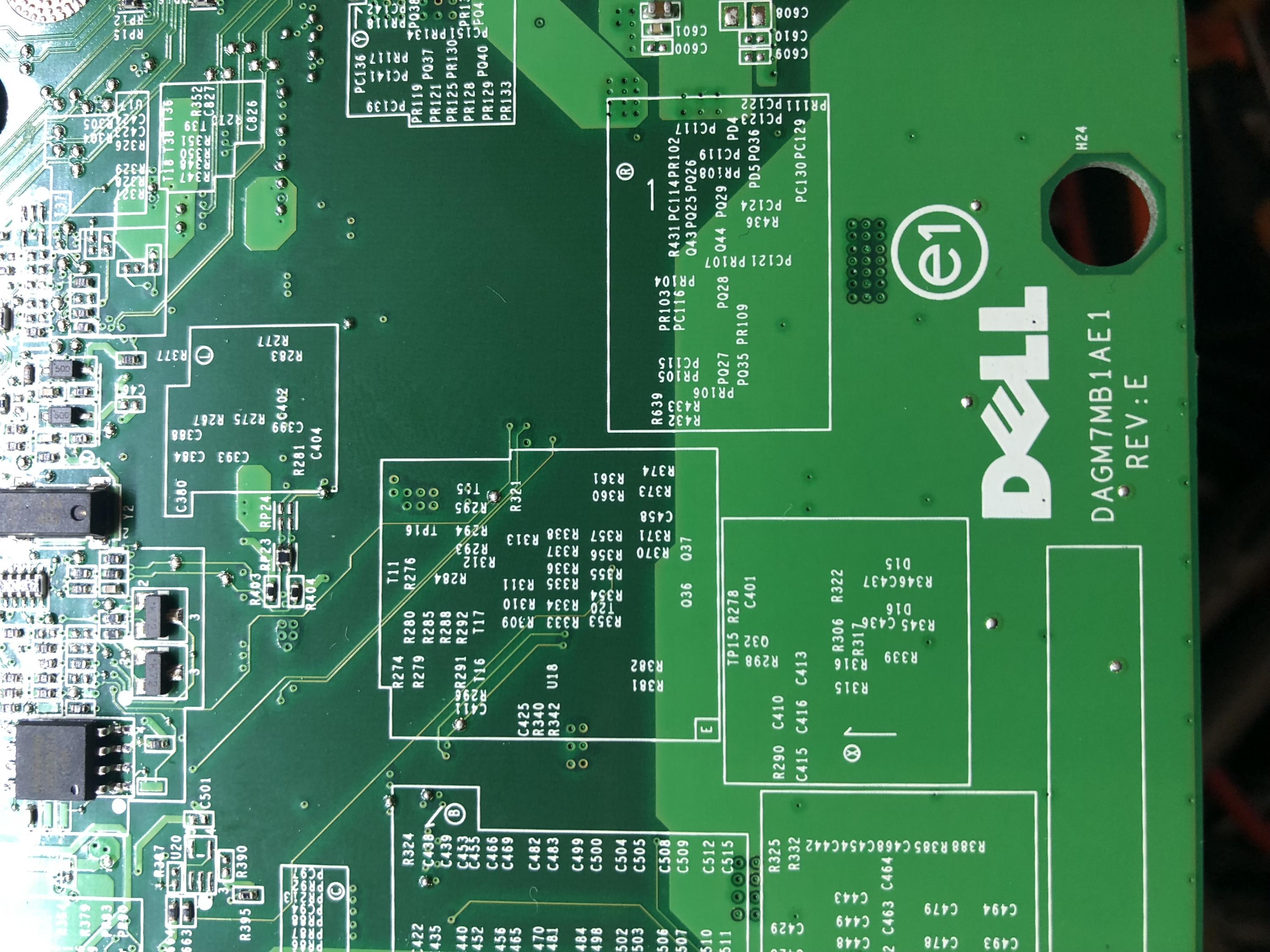

                here are some measurements:
                pd5:
                pin1 - 5.11v
                pin2 - 5.41v
                pin3 - 4.92v
                pd4:
                pin1 - 5.11v
                pin2 - 6.62v
                pin3 - 5.22v
                pq36:
                pin1 - 0v (in OR base)
                pin2 - 6.61v (gnd OR emitor)
                pin3 - 6.60v (out OR colector
                pq36 shouldn't have 15v on pin 1?
                pq26:
                pin1 - 3,3v (gate) which corresponds to alw_on and i do have 3.3v there....
                pin2 - 0v (source)
                pin3 - 0v (drain)
                see attachment for a differences around pq26/36 and pd4/5
