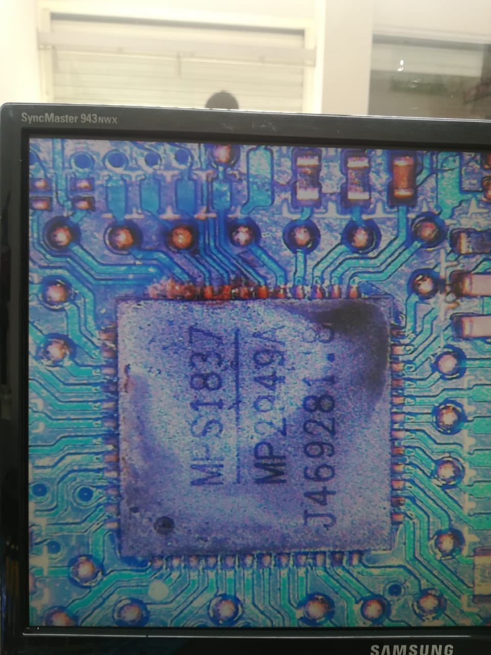

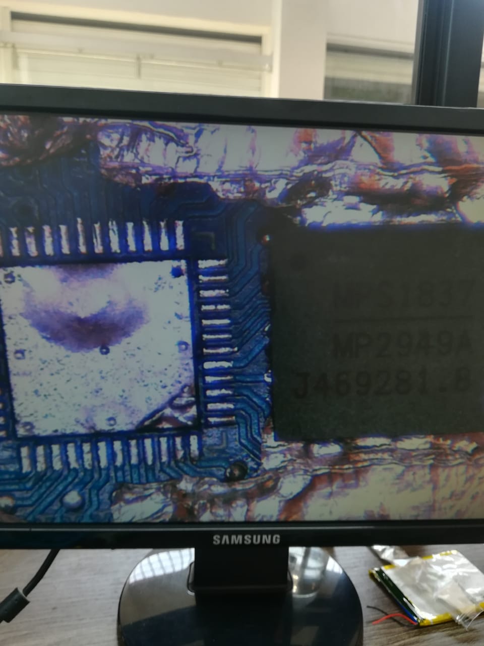

    Hello comunity
    This laptop recived humudity and did not turn on, the component afected was mp2949a it was cleaned removed and solded again, now the laptop turn on but just blink bloq mayus 5 times and 3 times fast, fan is ok and have consum. any idea about what is happening

      Clean the chip again check all the pin if they are not solder to geather
      • maurovalero
        • Sep 2018
        • 69
        • colombia
        Re: Hp pavilion 5 blinks and 3 fast black screem
        The chip is ok, but it not have 3,3alw and 5alw just apear voltaje pushing the power on button, and i dont have schematics, add bios bin

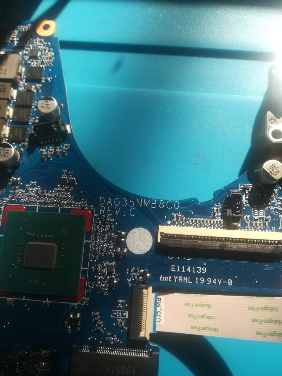

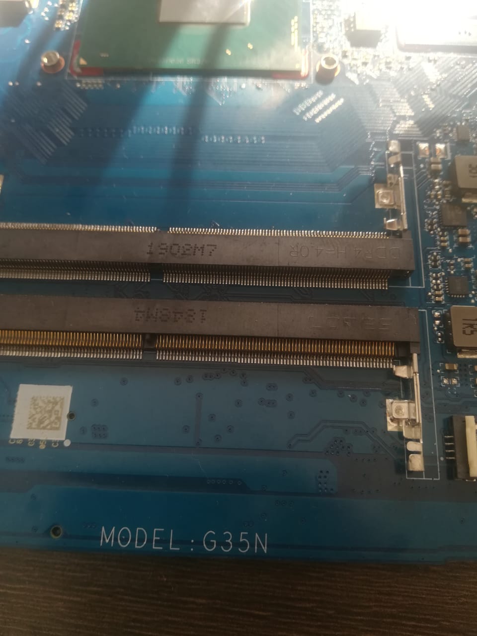

              Originally posted by smdflea
              posting the bios isn`t going to help with no 3,3alw and 5alw. Post the motherboard part number(s) and we can see if a schematic is available or one similar.
              dag35nmb8c0 model g35n
