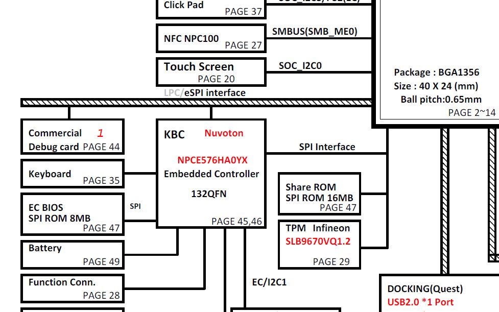

    Hp folio 1040 g3 keyboard problem
    when I press a key two letters appear, not the same letter but the one adjacent to the one I pushed.
    I wanted to change the keyboard but first I wanted an opinion from those who had the same problem
    • 21889
    Re: Hp folio 1040 g3 keyboard problem
    Faulty KBC or keyboard. Does your KBC programmer have a keyboard tester
    • jasko_jacker
      • Oct 2014
      • 1140
      • italy
      Yes, I have a vertyanov that has the keyboard tester function but the flat of this keyboard is very strange (no adapter that I have is useful to me) and I should make the connections one by one, the keyboard it's very affordable but only in china and with the corona virus problem the shipments are very slow , first I would like to try to reprogram the nuvoton NPCE576HA0YX which fortunately has an external memory.
      So it's possible that a keyboard has this type of problem.
        • 21889
        I also have a vertyanov programmer.The keyboard flat is 36 pin 0.8mm pitch, you can buy a keyboard tester with the 36 pins added to the newest v3 version,it isn`t made by sergey vertyanov though,he doesn`t sell a 36 pin adapter board (yet) as far as i know.
        https://www.ebay.com/itm/Universal-a...-/123623459796
        https://gsmservice.od.ua/shop/tester...noutbukov.html
          Yes, it is possible to have such kbd problem. faced this on many occassions. Bad kbd for sure. Try using on-screen kbd to rule out windows issue.
