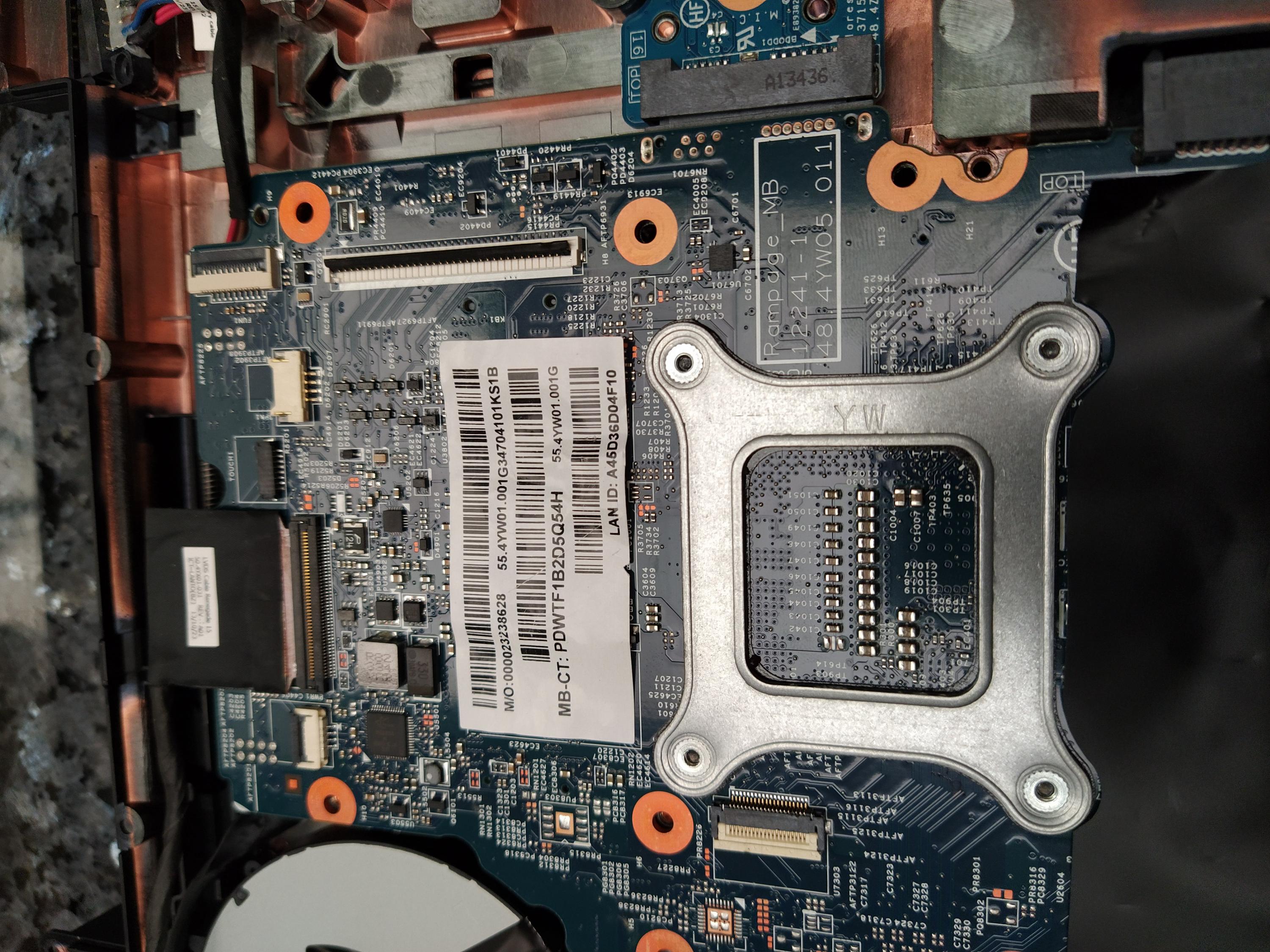

    Hi
    I have a strange fault with this HP probook 450 G1.
    When I plug in the power starts the laptop himseslf , spins the fan fast, no screen and flash the caps lock + numlock 7 times white. , all the power supply's are there.
    I have no schedule.
    Can somebody help me what can be the problem?
    best regards
    Steve

                    5 blinks is general system board failure
                    board is checking charger with middle pin if it is original charger and if it have enough wats. if not it wont let u charge or power on

                        flashing bios is mostly the first to do. next is checking all voltages and power line resistances

                            hi everybody I got finaly my bios programmer, i will like to flash my hp 450g1 , i bought ch341A programmer black edition , but the chip couldn't be recognice. whe i look to the model is not listed.
                            it is MXic mx25l6473E chip. how can i flash this with ch341a programmer
                            this i hp probook 450g1 wit the 5 times caps lock and numlock blinking problem

                              u cannot have problem flash it. if it is not detected just manually select its series
