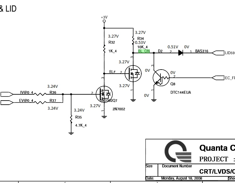

                                  A photo with the voltages.
                                  At this point I am deciding whether to get another motherboard (a ZK2 this time, at least to put one of my T9400s to a good use) or just rig up a bunch of slim 5v LED strips behind the LCD.

                                    Any Other member could help why BL_ON 0.53V?
                                    • ktmmotocross
                                      Boardkiller
                                      • Feb 2014
                                      • 3627
                                      • slovakia
                                      Re: Aspire 6530G - no backlight!

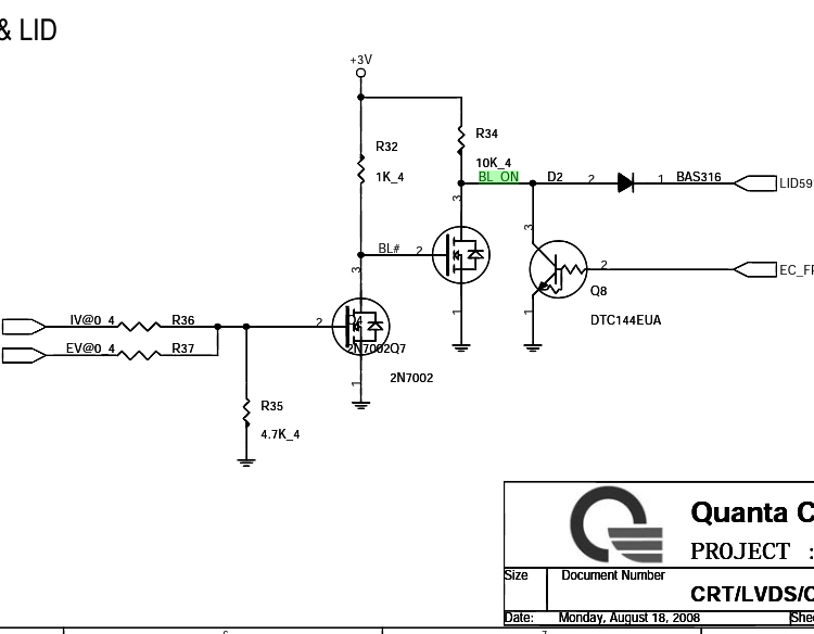

                                      no without detailed resistance measuring. i would check that LID signal
                                      post full schematic
                                      please wrote your reading for every pin of that mosfets in red color to picture.
                                      u must have BL# grounded by Q7/gate is high/ so it not grounded by next mosfet/gate is low/ BL_ON signal.

                                        So if Q7 gate is grounded this enables the BL_ON signal?
