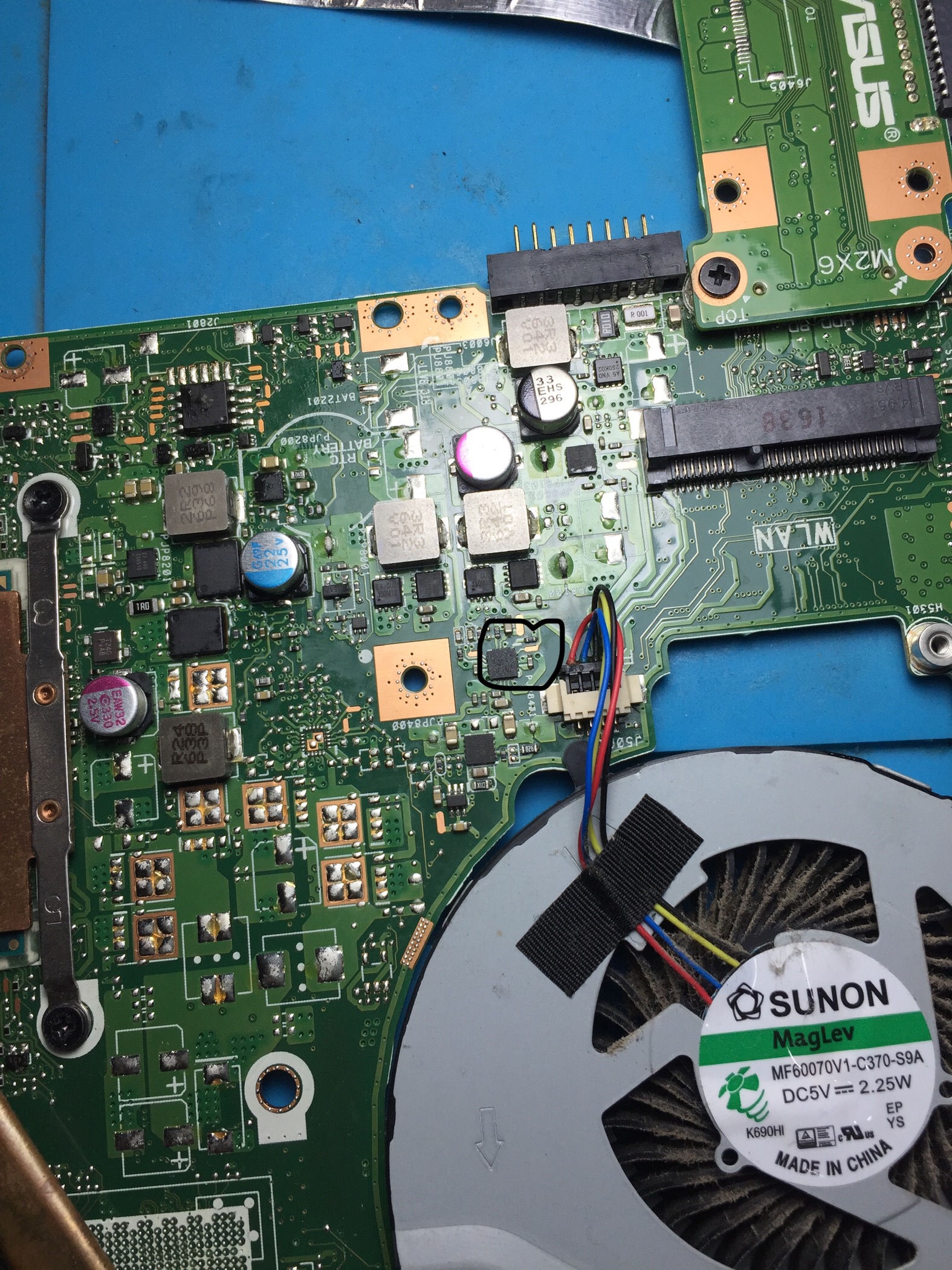

    I need to identify this chip because when i plugged the charger this chip is very hot. The board is X455LJ REV 3.1. I have attached the image of the board and chip can someone identify and help please

    Re: need to identify the chip please help
    From boardview, PU8100 is the 3V/5V regulator. Could be UP1589Q, confirm with markings.
      And what is the marking on the chip?
      Most likely it is 3/5 V controller. If hot - usually means too much current drawn either from ldo or smps output. Measure resistances on outputs pin 3,8,13,14 - search for low values.
        pin 3= 13.58kohms
        pin8= 2.95kohms
        pin13=2.95kohms
        pin14=14.75 then goes to 0kohms
          Look if KBC is shorted, had this problem before on a pretty similar ASUS board and KBC was dead
            Pin 14 - 5V, if i understand you correctly it is shorted.
            You need to find the short on the board. Methods are described - search.
            Boardview attached, might be helpful.
              @conste thanks for the info the kbc is not shorted one ceramic caps near kbc its shorted replaced it short its gone but bios and ec corrupted, Flash main and ec problem solved! thank you

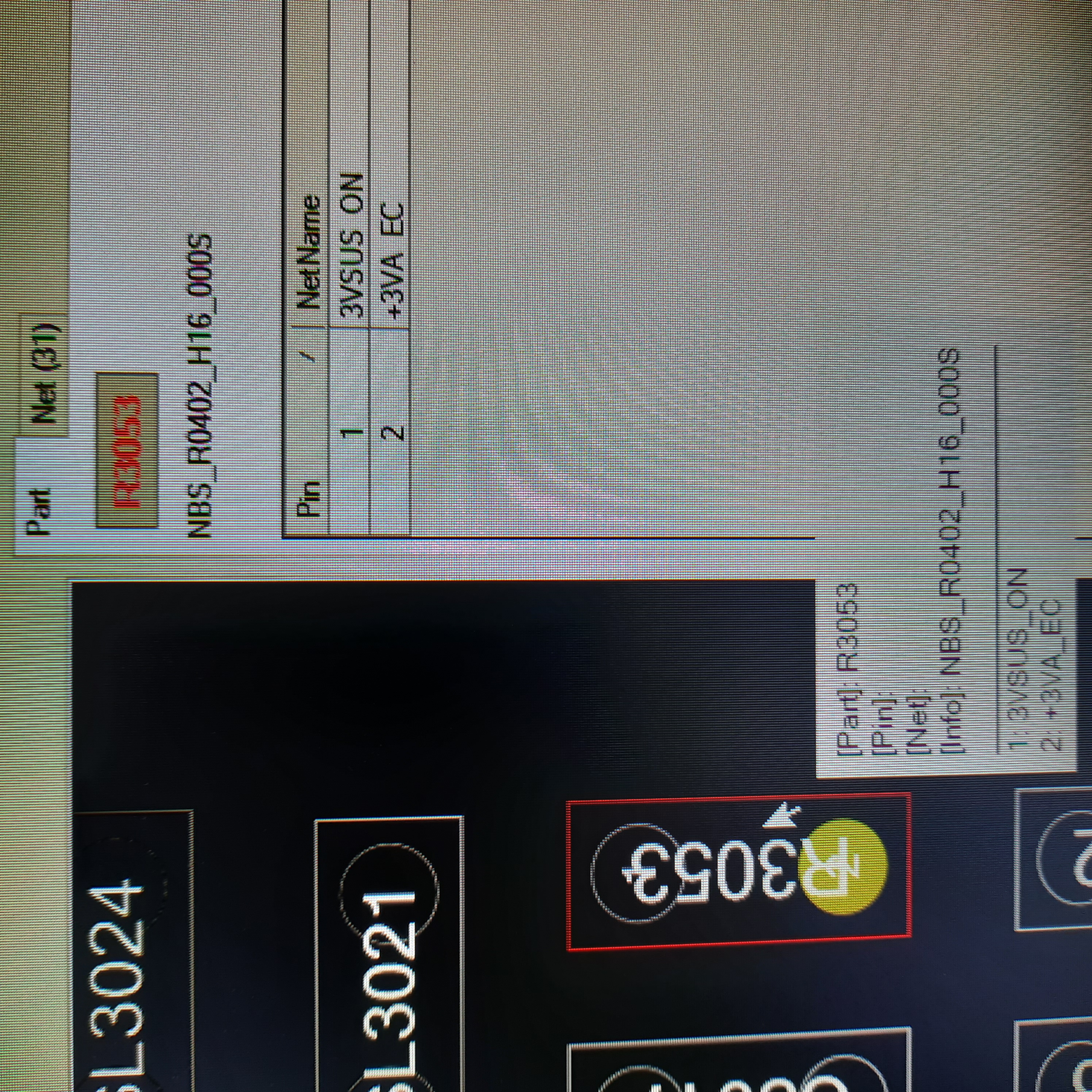

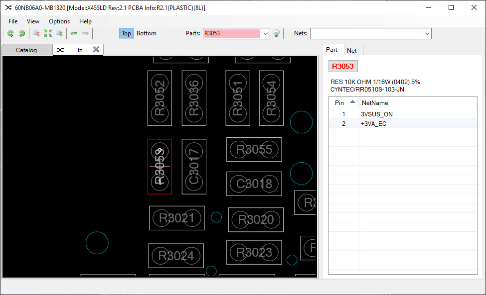

                            Anyone know the value of R3053? Is it a 0 ohm resistor?
                            I have problem, in pin2 i have 3.2V, but in pin1 im not getting 3.2v, its keep changing between 1.6-2.6V up and down (its happen when i just plug the power adapter).
                            When i press power button, it shown 3.2V steady in pin1.

                              Re: Asus X455LJ need to identify the chip please help
                              See attached.
                                Originally posted by mon2
                                See attached.
                                thanks mon2
                                  See attached.
                                  Could you share your boardview file, my boardview file does not show any info of components.
                                    Thank you.
                                    The link to the available boardviews are at post #6 .The picture at post #15 shows at the top left that its a X455LD Rev 2.1 boardview.Use the forum search and see if its been posted.
