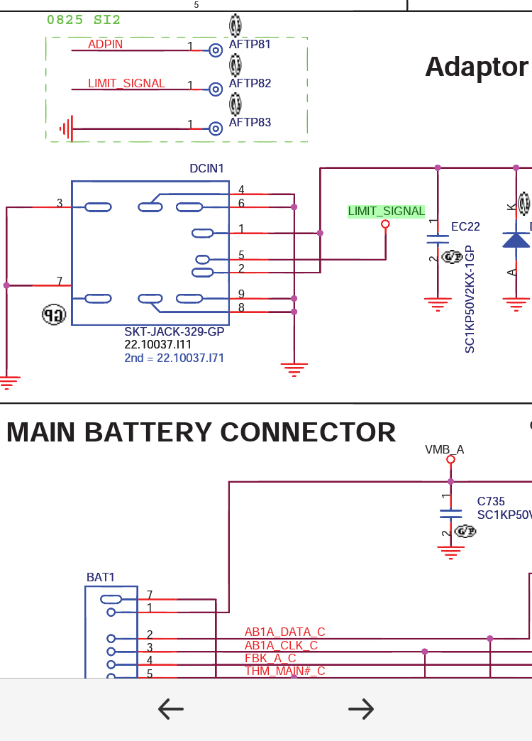

              Dissembled laptop carefully and check the voltage on pin number 5 Limit_signal voltage DC Jack Connector ,adapter connected to motherboard without battery
              • selfrepairing
                • Aug 2019
                • 18
                • serbia
                Re: HP Elitebook 2740p - starts on battery only
                Easy task, heh, disassembled whole thing. Measured 3.4v
                also,
                Pin 1 shows 0v
                Pin 2 shows 20.2v.
                thank you!
