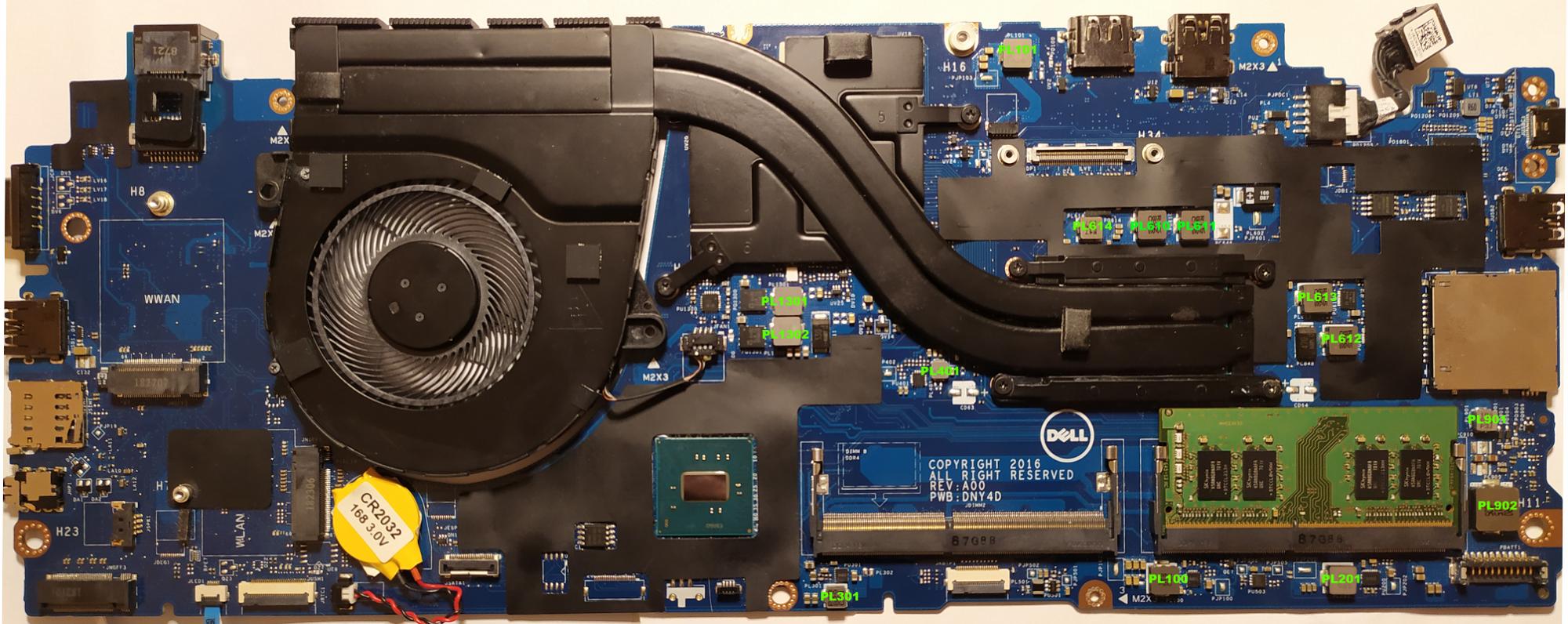

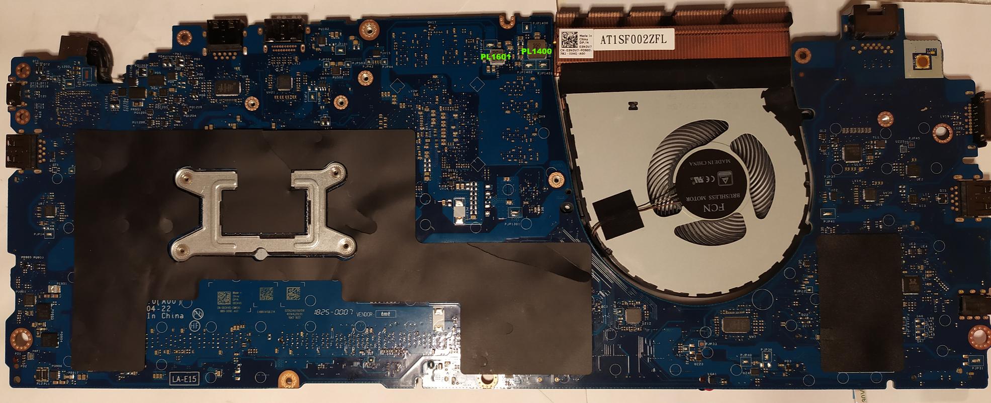

          Ok, Here are some pictures and measurements...
          COIL FUNCTION OFF ON
          PL901 DC-IN 19,50 19,15
          PL902 BATTERY - DC-IN SWITCH 3,06 13,50
          PL201 DDR 1,2V SUPPLY 0,00 1,20
          PL100 3,3V POWER RAIL 3,36 3,37
          PL301 1V-SUPPLY 1,00 1,00
          PL612 CPU GT ??? SUPPLY 0,00 0,00
          PL613 CPU GT ??? SUPPLY 0,00 0,00
          PL610 CPU CORE SUPPLY 0,00 1,08
          PL611 CPU CORE SUPPLY 0,00 1,08
          PL614 CPU SA SUPPLY 0,00 1,06
          PL101 5V POWER RAIL 5,17 5,16
          PL1301 GPU SUPPLY 0,00 0,89
          PL1302 GPU SUPPLY 0,00 0,90
          PL401 1V IO SUPPLY 0,00 0,98
          PL1400 VRAM SUPPLY 0,00 1,34
          PL1601 1,05V SUPPLY 1,05 1,04
          The coil numbers are the same on my board and the attached schematic.
          The measurements are with AC adapter only (no main battery attached). 2 measurements on each rail, the 1st is the OFF state, the 2nd is the (brief) ON state.
          Something is wrong with the "CPU_GT" power rail? It does not change from off to on. (i think CPU_GT stands for the CPU on board graphics supply)...
          Please advise, Thanks...

                        Check the Voltage requirements for PU612 PU613 VIN VDD ect , GXF CORE missing BIOS faulty
                        • Asxetos21
                          • Dec 2019
                          • 8
                          • Greece
                          Re: Dell Precision 3520 Troubleshoot
                          The voltages on the switches are OK. VDD 5.0V VIN 13,50V. But as always no power on the VCC-GT rail.
                          PS. The bin you gave me doesn't work. Same behavior...
                          Thanks...
                                    Originally posted by SMDFlea
                                    Which switches do you mean, PU612 ,PU613 and PU614.
                                    I mean PU612 and PU613 which control the missing VCC_GT. PU614 is for VCC_SA which rises fine.
                                    Do you have IMVP_VR_ON on PU601
                                    It will take some time to trace the signal on the board and measure it, but to me, it must be working.
                                    Per the schematic, PU601 controls ALL CPU voltages (VCC_CORE, VCC_GT and VCC_SA).
                                    If IMVP_VR_ON was missing, none of the 3 voltages would rise. But as measured, VCC_CORE and VCC_SA rise just fine...
                                    Searching, I measured PWM1_VCORE and PWM2_VCORE on PU610-PU611,
                                    and compared it with PWM1_GT PWM2_GT on PU612-PU613
                                    On the working rail (VCORE) it settles to 0.3-0.4V.
                                    On the missing rail (GT) it is A-LOT higher to 1+V.
                                    (sorry i don't have a logic analyzer, just a multimeter)
                                    Probably the controller (PU601) receives no feedback and increases PWM duty-cycle to raise a voltage that never comes-up.
                                    So i am suspecting PU612-PU613. Even though they are powered, they do not switch-on.
