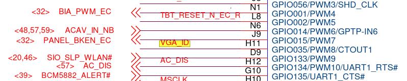

                              Originally posted by Asxetos21
                              OK, after a lot of searching i located the VGA_ID resistor, of-course it was configured for discrete graphics.
                              I moved it to the UMA graphics configuration.
                              I have a Dell Precision 3520 with the same problem.
                              A long search near the superio chip was unsuccessful.
                              Do you have/remember any hints to find that resistor?
                              Thank you.

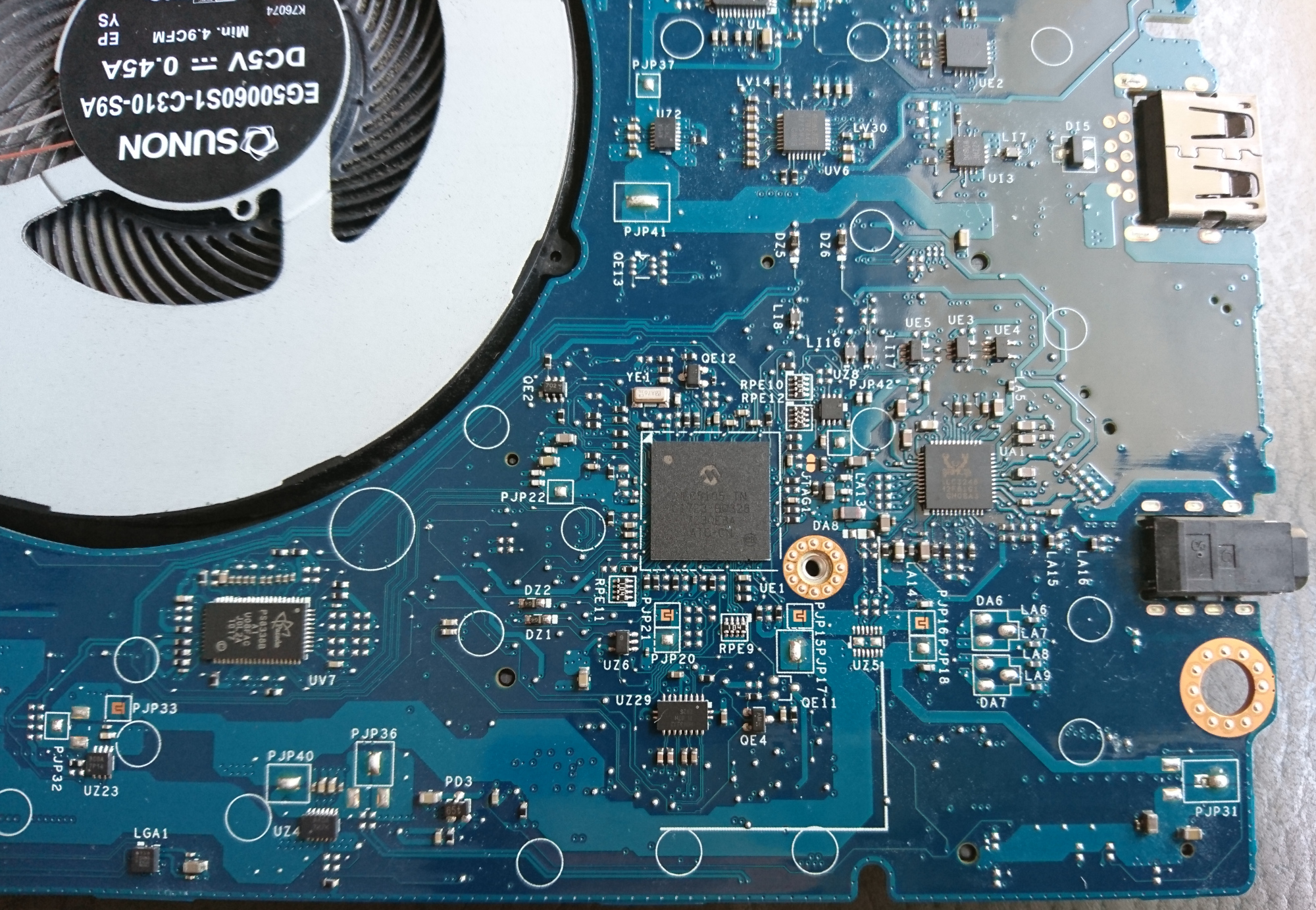

                              • mon2
                                • Dec 2019
                                • 14756
                                #35
                                Re: Dell Precision 3520 Troubleshoot
                                See attached.

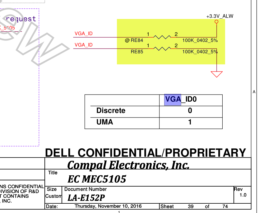

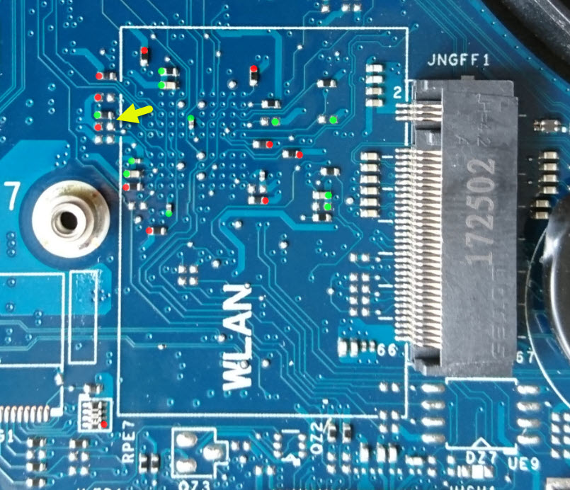

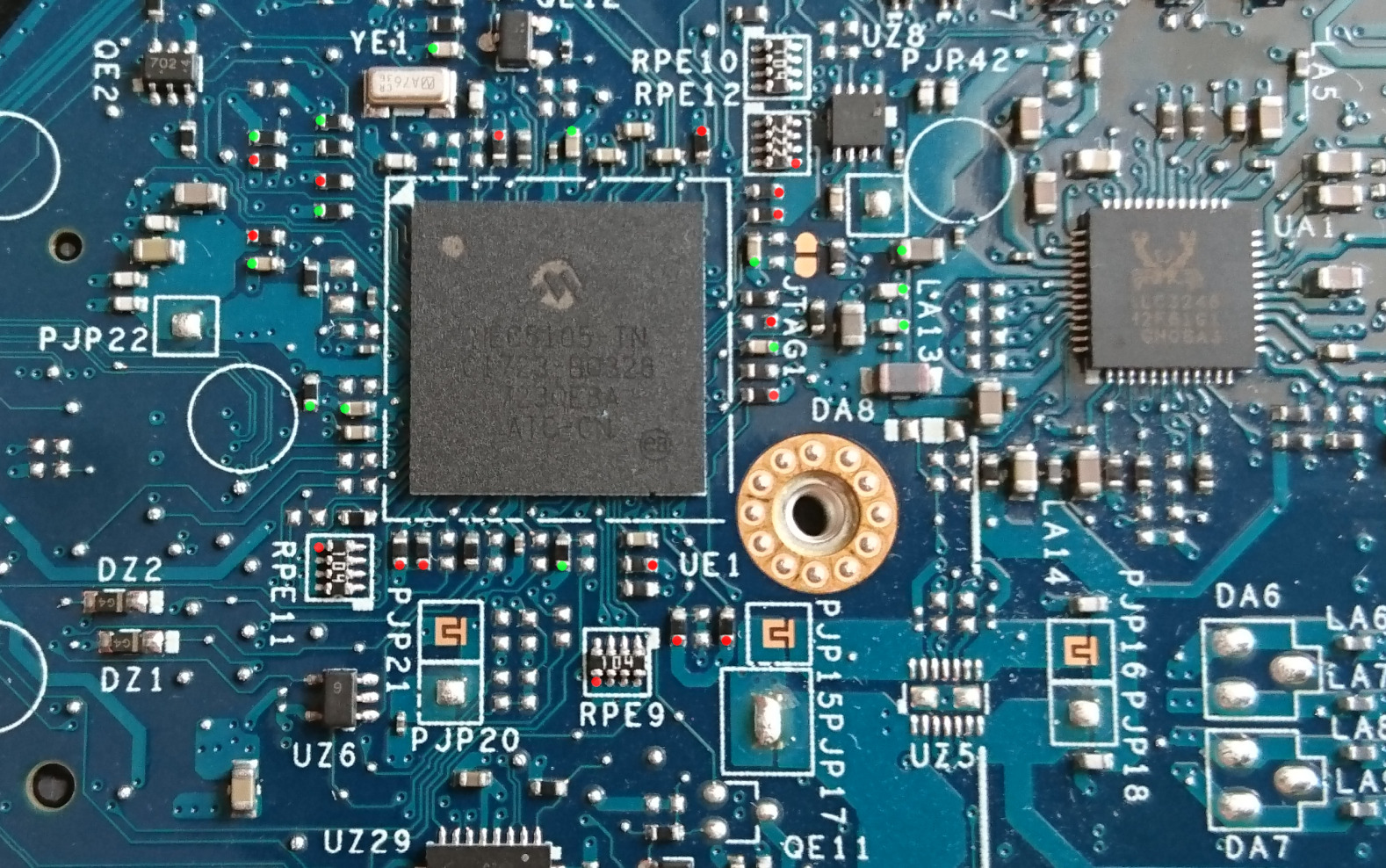

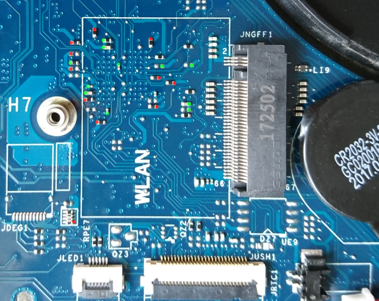

                                    Unfortunately, the board I'm working on, is quite different...
                                    Anyway I've done some measurements (red dot = +3.3V, green dot = GND) on both sides of the motherboard, around and under ME5105, in order to spot potential candidates.
                                    We are looking for RE85, which is connected on one end to the MEC5105 chip, and on the other end to GND.
                                    Once found, we have to move that resistor in RE84 position.
                                    The RE84 position should be an empty spot with one pad @+3.3V, and the other pad at the same potential of one pad of RE85.
                                    Here are some images.

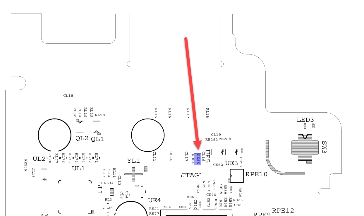

                                      • Dec 2019
                                      • 14756
                                      #38
                                      See attached.
                                      Remove all power. Meter in resistance mode.
                                      Can you check with the red meter on one pad & black meter on the next pad near the yellow arrowhead -> what is the resistance ?
                                      If it is ~0 ohms, then there is a trace across these 2 pads.
                                      One side is GROUND.
                                      Other part is to +3v3.
                                      Perhaps this is the VGA_ID jumper strap ??
                                      Are there any other white silk screen markings on your logic board ?
                                      In my database, believe is the only link to this model.
                                      • numerocentouno
                                        • Apr 2022
                                        • 3
                                        • Italy
                                        #39
                                        My best candidate for RE85 is the resistor on the left side of the second image, the first over the screw hole.
                                        The empty position below the resistor is a perfect candidate for RE84 (one pad in common on the MEC5105 side, and the other on +3.3V).
