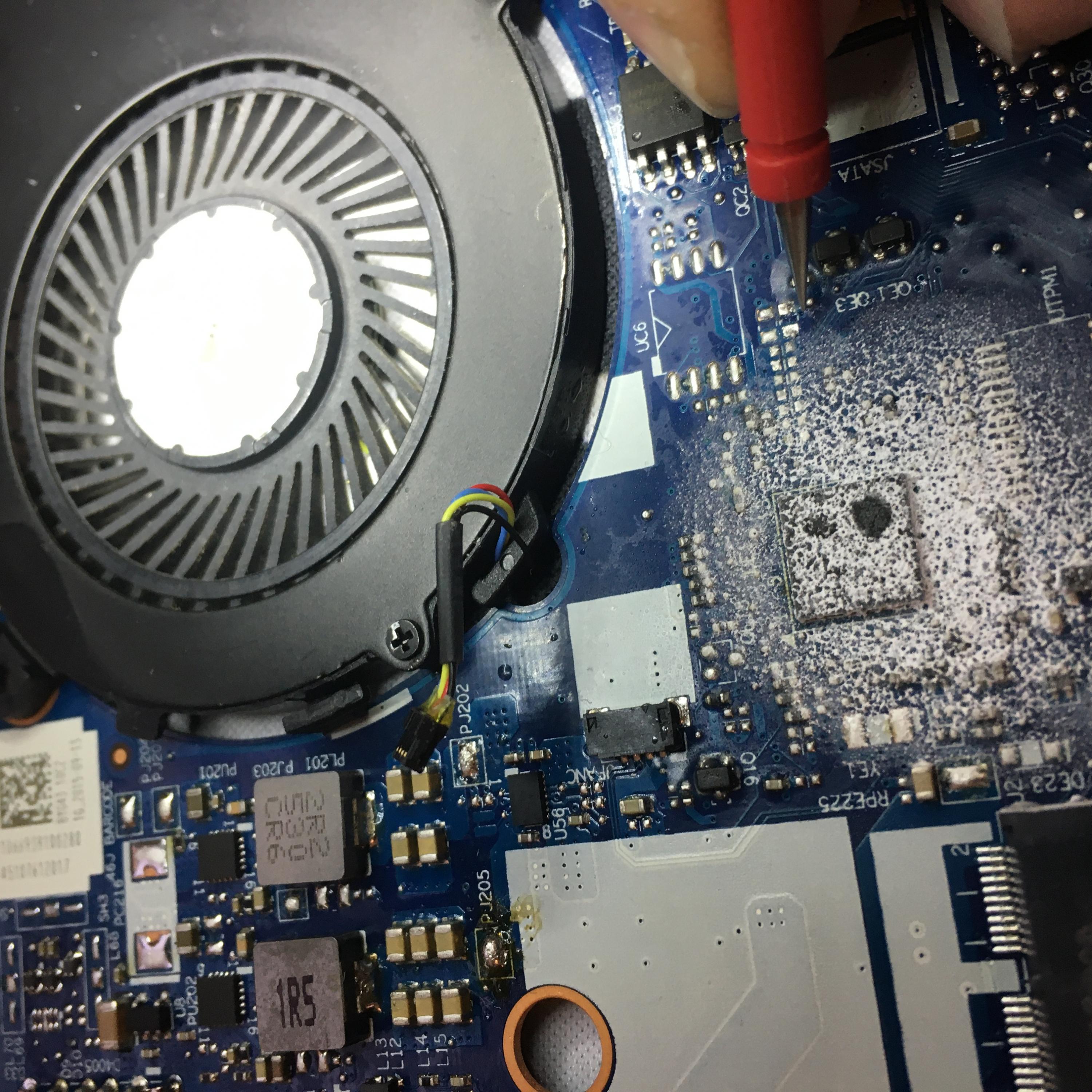

      I tried to remove PJ202 (5V) jumper and inject 5V. The U101 (5AF2F) gets hot.
      What is the purpose of the U101? Maybe switching betwen 5V USB and 19V USB AC adapter?

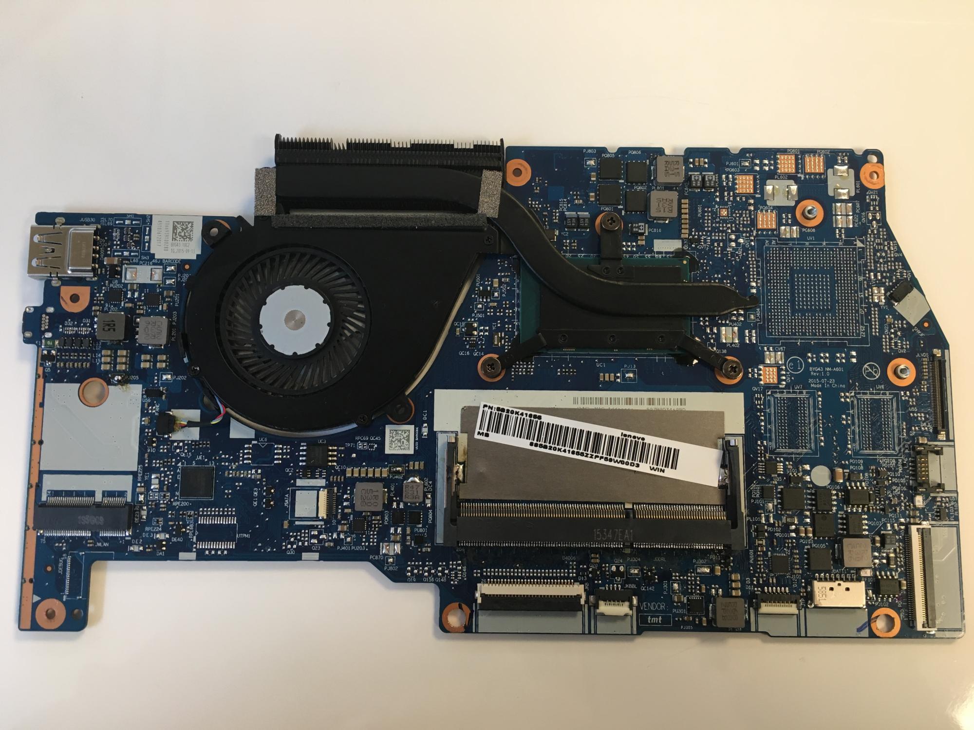

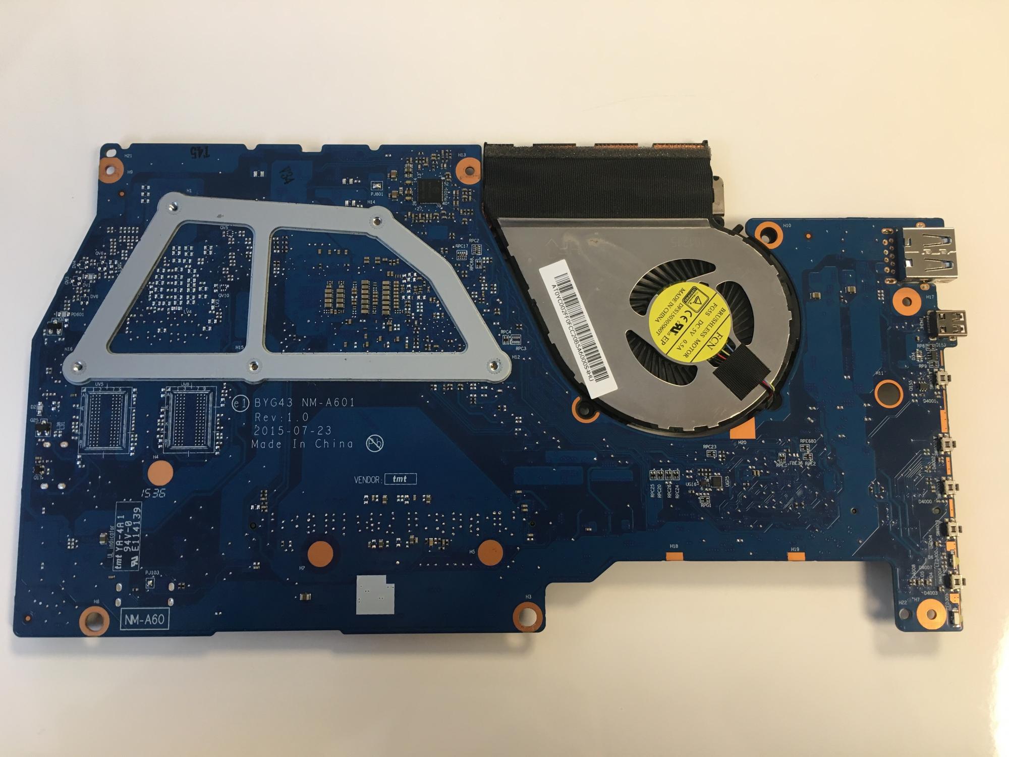

      Attached pictures of the motherboard taken with my iPhone.
      Could it be that the EC is always reset?

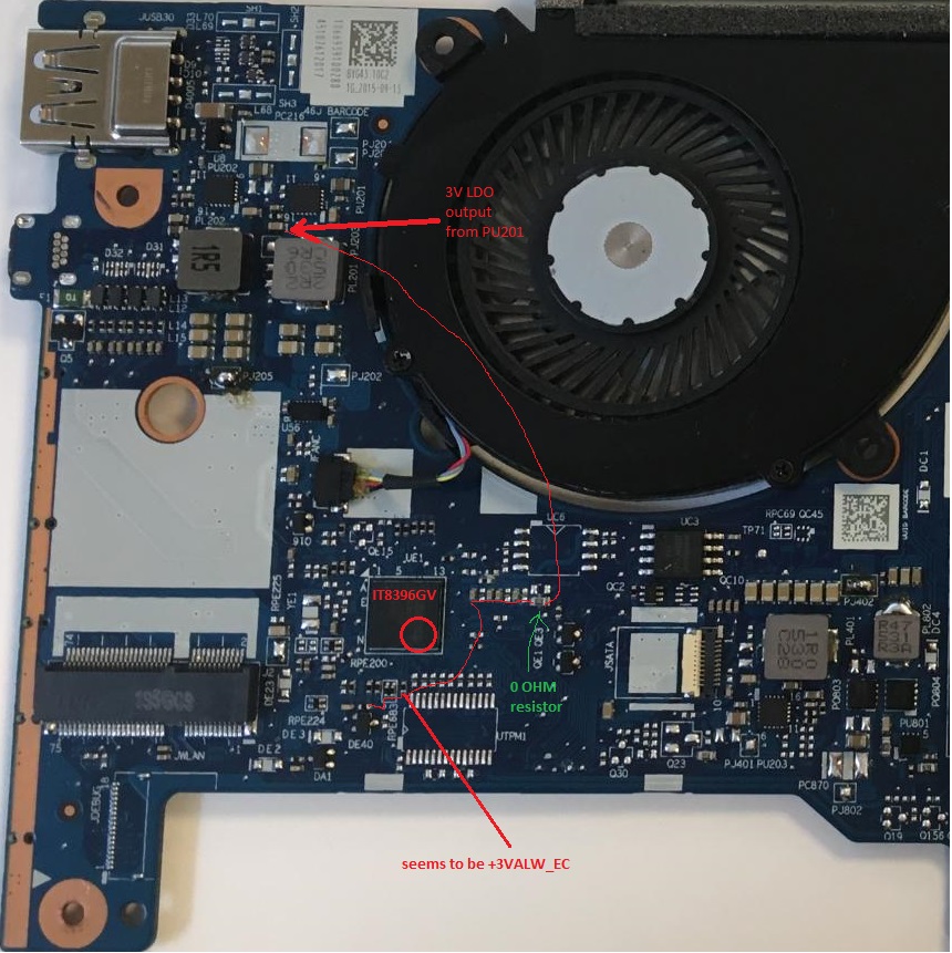

          So, I worked more on this motherboard today. Here what I found:
          The PU201 generates 3.3V internally. This 3.3V is connected to the +3VALW_EC thru the zero ohm resistor shown on attached photo. From the other side of the resistor connected to EC and reset circuit for the EC: diode, resistor and capacitor.
          This 3.3V was shorted to ground by the EC. When I removed the 0 ohm resistor, it was back on. But the 3V output of the PU201 was not available.
          If I inject 3V after the resistor, the EC gets hot where I marked with red circle on the EC (IT8396GV).
          Do you agree with me, that the EC is shorted? maybe dead?
          The problem is this EC is BGA, så we have to get it out to check the short.
          Anybody have the pinout and maybe schematic for this EC?
          Any suggestions? Thanks.

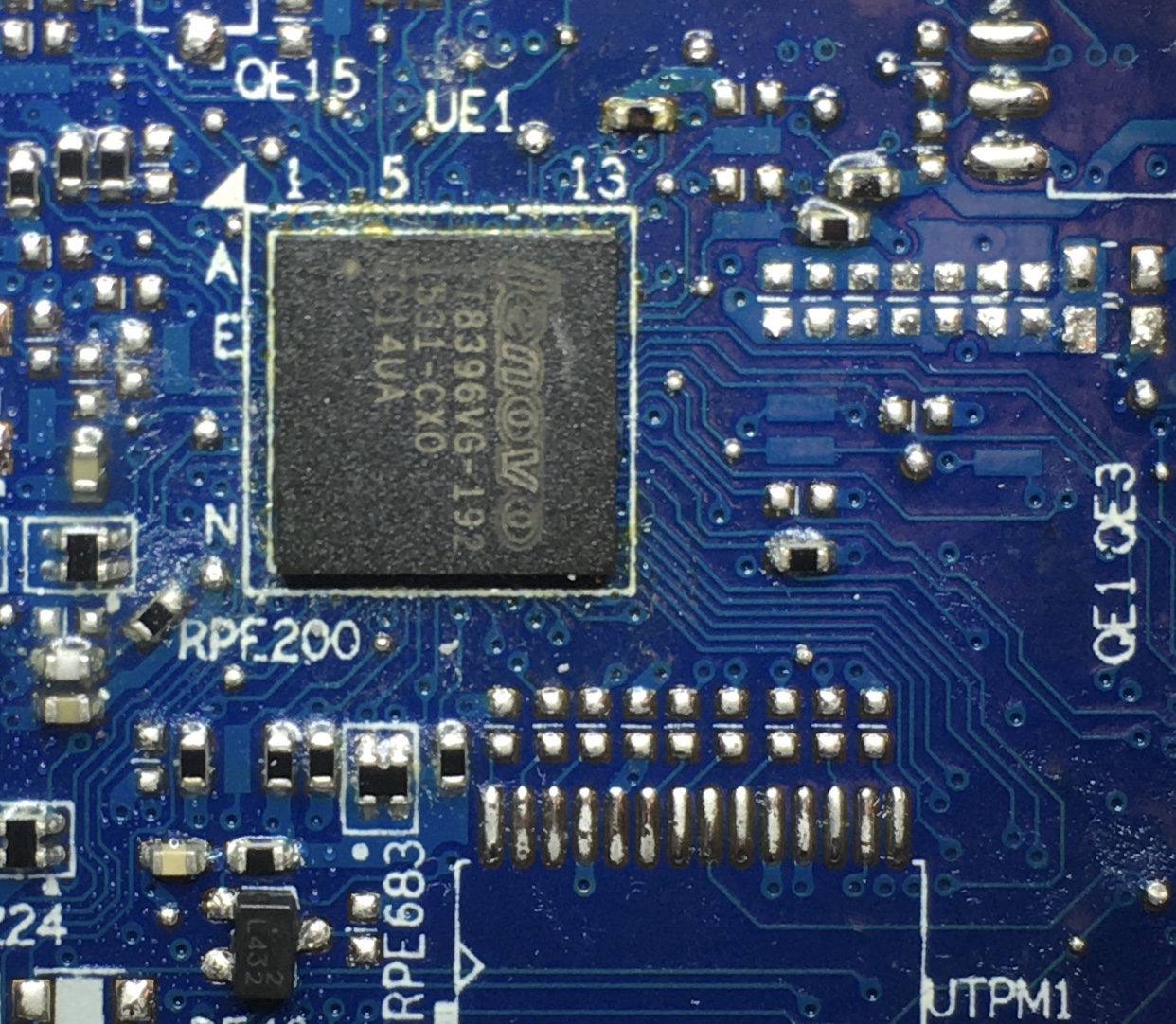

                  Attached photo of the EC getting worm in a specific area about the "v" in Lonovo word on it.
                  The other photo showing type number.

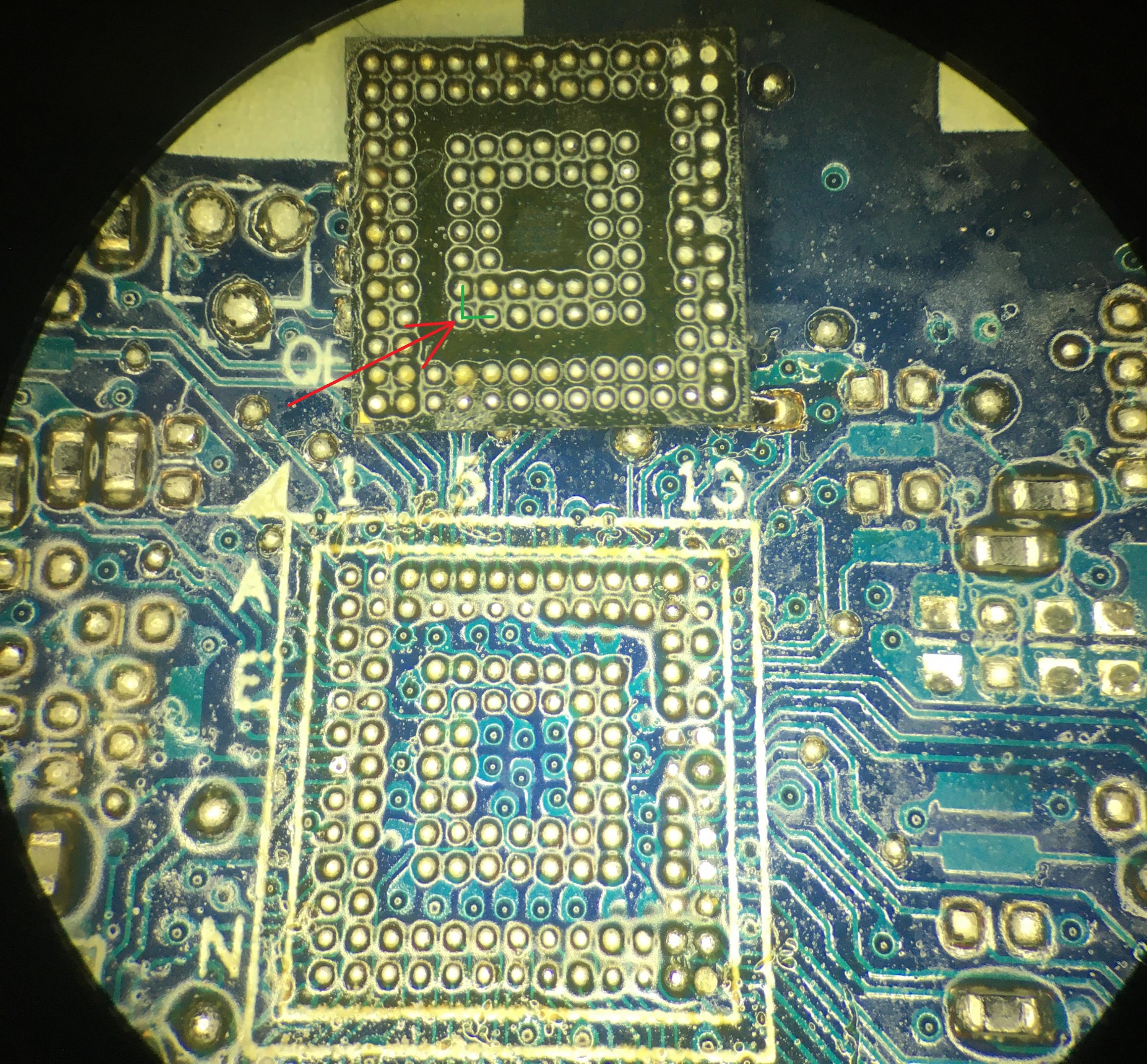

                    Removed the EC and the 4 ohm short is gone.
                    The EC in photo is flipped on its back vertically (up-down). Left-right is correct.
                    • mcplslg123
                      • Jun 2015
                      • 7262
                      • india
                      Re: Yoga 700 14-ISK
                      Going by your pic of lifted ec, it doesnt seems reballed. So the ec is actually shorted. As you are aware, needs to be replaced.

                          On pic, red arrow indicates pin shorted to ground.
                          Green line indicates these three pins are on board connected together to the +3VLP (100 mA) LDO output line from PU201.
                          When one of these pins is shorted on the EC itself, the +3VLP is shorted to ground.
                          Click on picture to see it clearly.
