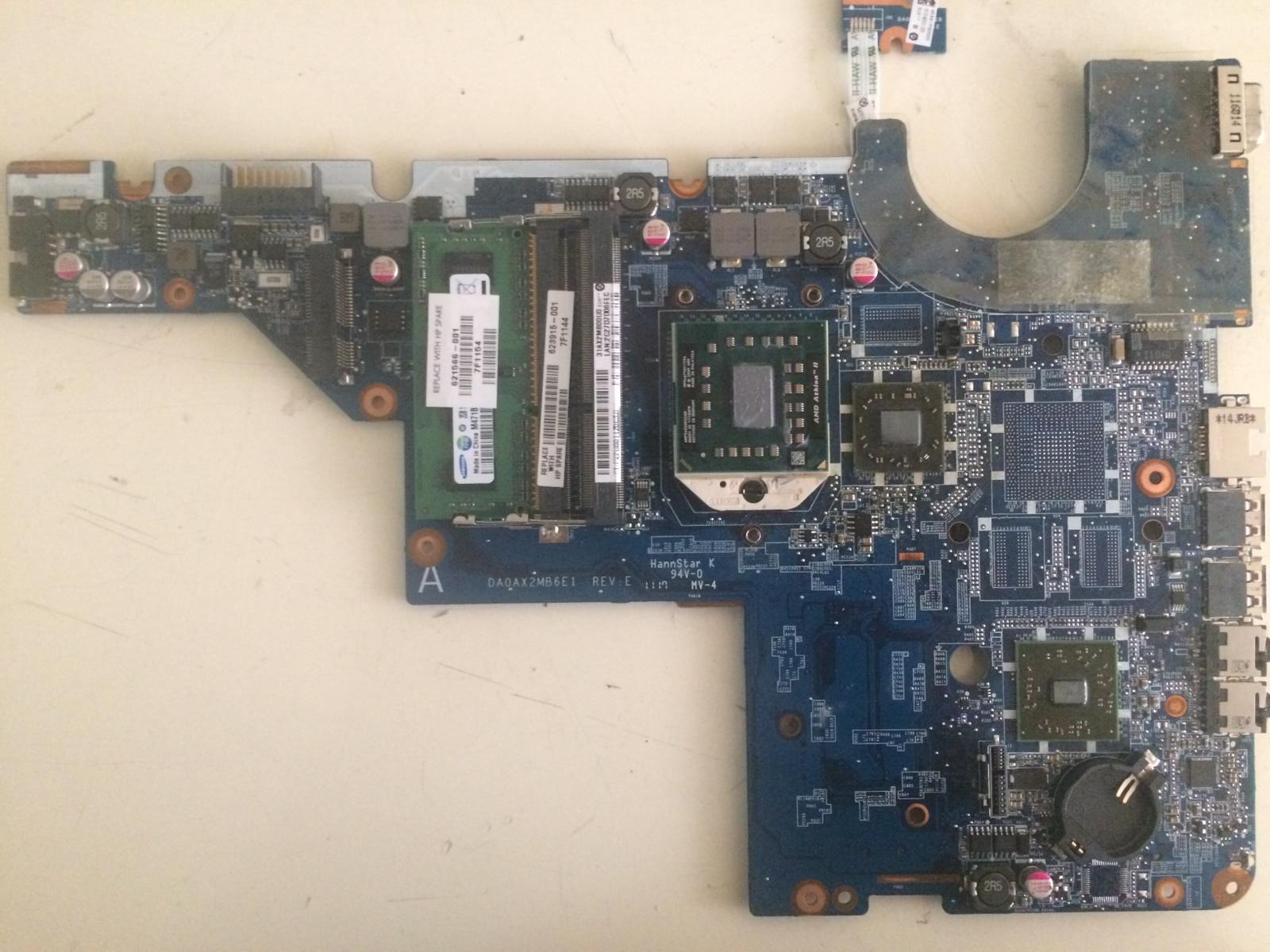

        compaq cq56-240st white screen after uma
        Hello there
        I'm new to the forum, I apologize in advance if a mistake.
        I have a compaq cq56 240st
        i want to make uma for this laptop
        motherboard is da0ax2mb6e1 rev: e
        I did what was described in this video (video is here)
        motherboards are identical.
        I removed the ones marked with "GO"
        I moved the ones marked with "chuyen"
        I did nothing to those marked with "them"
        The resistance values look the same as the values in the video.
        After completing all the operations the laptop only shows white screen.
        can you help me find out where the problem is?

          Re: i have cq56-240st. this can uma?
          Are you sure that your board has a dGPU as piernov already mentioned?
          Take a picture of your board please.
            If the number of amd chip on your board is 3, then its discrete mb. If you have 2 amd chips, then its UMA only.
              My board's pictures
              https://ibb.co/VVdhRz6
              https://ibb.co/YTSP26F
              please help if there is a way to repair this motherboard without bga
                  Please attach pictures to your post directly.
                  As expected, there is no dGPU…
                      Its already UMA bro. Time to troubleshoot signals.
                            Your board DOES NOT have a dedicated GPU and is already running on integrated graphics. It can't be changed to uma because it already is! You'd have to revert all the changes you already made to the board. They were useless and most likely gave you more problems than you had before.
                            As piernov already said your Northbridge is most likely faulty since the integrated graphics is in it.
                            And no there is probably no way to repair the board without bga station.
