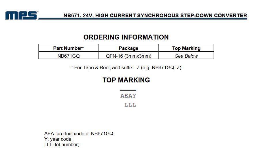

    need advise please NB671GQ-Z
    can i replace chip NB671GQ-Z with NB671ZGQ-Z?Please help. the one shorted has marke aeae and my chip available has marke aead
    • 20643
    Re: need advise please
    NB671ZGQ-Z - no part number. The NB671GQ and NB671GQ-Z are the same,the Z is for tape and reel packaging . AEA is the product code,the fourth digit is the year. AEAE and AEAD are the same, apart from the year they were made.
    • String2016
      • Nov 2015
      • 2229
      • philippines
      Re: need advise please NB671GQ-Z
      thank you, I replaced it and its working fine now.

        NB671GQ-Z (AEA) Equal to RT6223 (9J)
