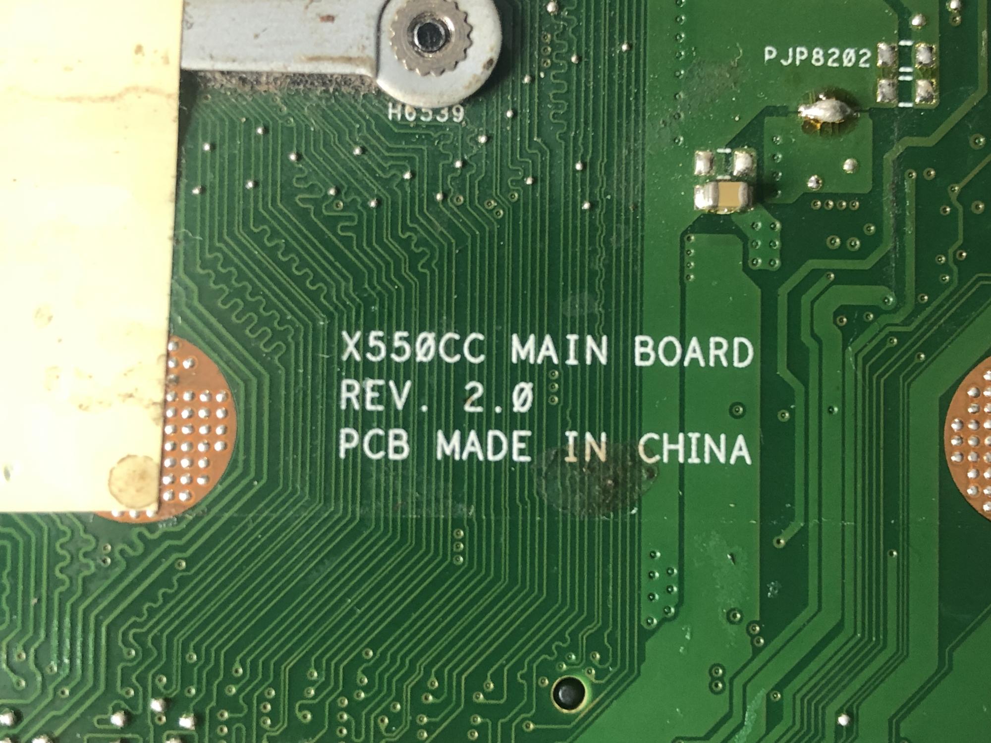

Asus X550C dead
  • DeniS182
    • Jun 2014
    • 328
    • Slovakia
    Asus X550C dead
    I have problem with this laptop. Is completely dead. Power IC was very hot I replaced it with I mean good replacement from other dead board. uP1589q I replaced it with JC (RT8239B). There are 3.3V and 5V ALW rails now. But DC-IN voltage is not stable. After second mosfet I have weird readings and something clicking. There is no short on 19V power rail. Very weird fault for me. Can someone help me with this, or schematic is availible for this motherboard? I have only boardview.
    Thanks for any answer..

    Re: Asus X550C dead
    I tried replace first two mosfets after dc-in connector but nothing changed. After second mosfet on current sensor resistor I have weird voltage readings something like 0V-5V-10V-20V my multimeter switch ranges randomly.

        Re: Asus X550C dead
        check the 2 Fets gate voltage is stable or not PQ8801/2 apply 1V to PR8806 CLR and see is its stable or not

          Re: Asus X550C dead
          gate voltage is not stable. And no short on PR8806

            Re: Asus X550C dead
            Find out Charger IC pin ACDRV Voltage is stable or not and test all components connect to that line

              Re: Asus X550C dead
              I resolder components connected to that line and voltage is now stable. Thanks. But laptop is still dead. Power consumption is 0.01A and after power button is pressed consumption rise up to 0.03A but all LED's stay off.

                Re: Asus X550C dead
                test the voltage PU8802 ACDET ACOK , U3001 pin 14 17 56 57 107 108 85 ,U2801 pin 8 for voltage , PQ9103 PQ9101 PR9104 all pins for +V

                  Re: Asus X550C dead
                  PU8802 - ACDET - 2.6V
                  ACOK - 3V
                  U3001 - 14 - 3.3V
                  17 - 3.3V
                  56 - 0V
                  57 - 0V
                  107 - 0V
                  108 - 0V
                  85 - 0V
                  U2801 pin8 - 3.3V
                  PQ 9103 - not soldered on board
                  PQ9101 - 0V at all pins
                  PR9104 - not soldered on board
                  Do you have schematic please?

                    Re: Asus X550C dead
                    ACOK - 3V
                    U3001 - 14 - 3.3V
                    17 - 3.3V
                    56 - 0V
                    57 - 0V
                    107 - 0V
                    108 - 0V
                    85 - 0V
                    U2801 pin8 - 3.3V
                    no i dont have it, you have to test this voltage when pressing the power button one by one
                    56 - 0V
                    57 - 0V
                    107 - 0V
                    108 - 0V
                    85 - 0V
                    112 ?

                      Re: Asus X550C dead
                      0V on all these pins when power button is pressed. But on pin 125 I have 3.3V and after power button is pressed it going to zero.

                        Re: Asus X550C dead
                        back up old DUMP and flash bios

                          Re: Asus X550C dead
                          I desolder bios chip. Try it with other one with dump from this forum. But nothing changed.
                          When I open it with CH341 software it says dump is too big or something like that.. I try to find another dump

                            Re: Asus X550C dead
                            I flash another dump but still same laptop dead. should I repeat the measurements?

                                  Re: Asus X550C dead
                                  Pin 112 Communication between bios and SIO check again and all pins of BIOS IC for voltage ,check RTCRST RTCVCC R2002for any short

                                    Re: Asus X550C dead
                                    R2002 was missing, pads damaged. I fix it with 22k resistor/Original 20K/. PIN 112 - 3.3V. bios pins: 1) 0.3V
                                    2) 1.2V
                                    3) 3.3V
                                    4) 0V
                                    5) 1.3V
                                    6) 1.68V
                                    7and8) 3.3V

                                      Re: Asus X550C dead
                                      2) 1.2V
                                      3) 3.3V
                                      4) 0V
                                      5) 1.3V
                                      6) 1.68V
                                      7and8) 3.3V
                                      ok thats great now when you press power BTW pin112 will go high low 3.3V to 0V , and check voltage pin

                                        Re: Asus X550C dead
                                        I mean measured bad pin before because now is 112pin all time zero when is pwr button pressed or not. ANd 56,57,107,108,85 still 0V - when is pwr button pressed or not.
