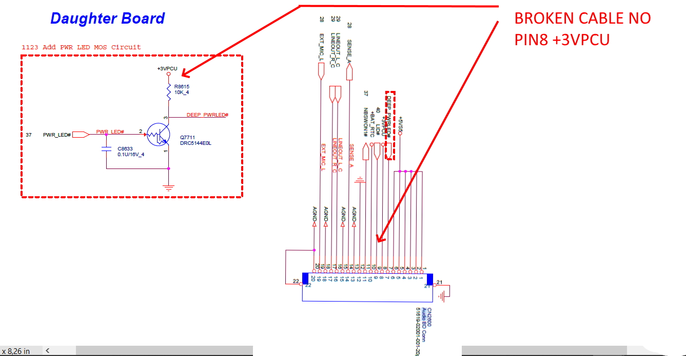

    strange power led behaviour, hp 15-bc014NL DAG35AMB8E0, the original bios was deleted by a repair shop so I tried all three bios skylake H from a badcap thread. only one of them works (but committed state....) but the led next the power button remain on when the system is off and the other way around.

          Apparently solved:
          This notebook has two separate board: one with 2 usb port and audio jack and from this another for the power button and led. The cable to the audio BD conn have a +3VPCU broken line, this line is also for power led. After restoring the connection the power led is normally off when the system is off... I don't know if there is another issue but at lest it work now.
