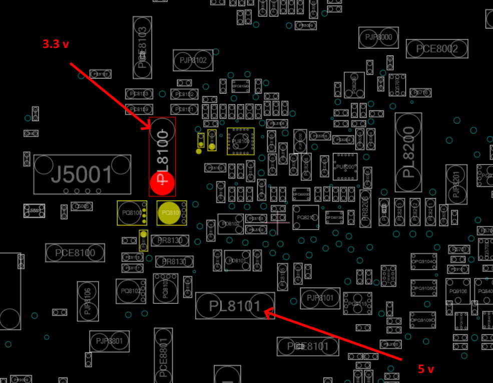

I have an Asus K555L laptop that doesn't show any signs of life.NO lights NO HDD sound NO fan sound. I took it apart and measured the first mosfets and they have power. I also noticed an UP1589Q IC getting very hot and i mean very hot. If someone is willing to help a newbie that would be awesome.Laptop motherboard is K555LD rev 3.3

You need to remove PL8100 and check short is on which side of the coil pads. Apply 1-2Volts on the shorted side with dc lab supply-shorted component will heat. Btw, do you have lab psu??Comment

Not the correct way of doing this but 3v3 from ATX power supply might be the easiest DIY short-finder.

ok sorry for the LONG delay i bought a soldering station with a hot air gun from china and was waiting for it to arrive i did what RethoricalCheese suggested and found that PC8207 was heating up. I removed it and tried booting again BUT again the UP1589Q is getting hot and the laptop is not working.
