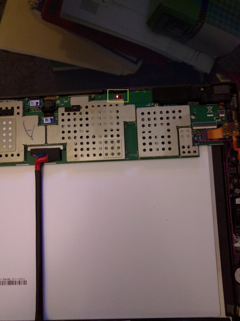

      I noticed a little red light that comes on the mother board when the power button is tapped / pushed and appears to stay on although I haven't sat around watching and waiting on it. The light goes out if the power button is held down for a while ... 5 or more seconds maybe. Almost appears to be some sort of power indicator but it can't be seen from the outside base case (it is blocked by a metal tab of the case) so it is something else.
      Any one know what it indicates?

            I probably should have titled this as "does not boot up / display anything". I think the red light is a "power on indicator"... why they put it in the back and not viewable without taking off the back cover.

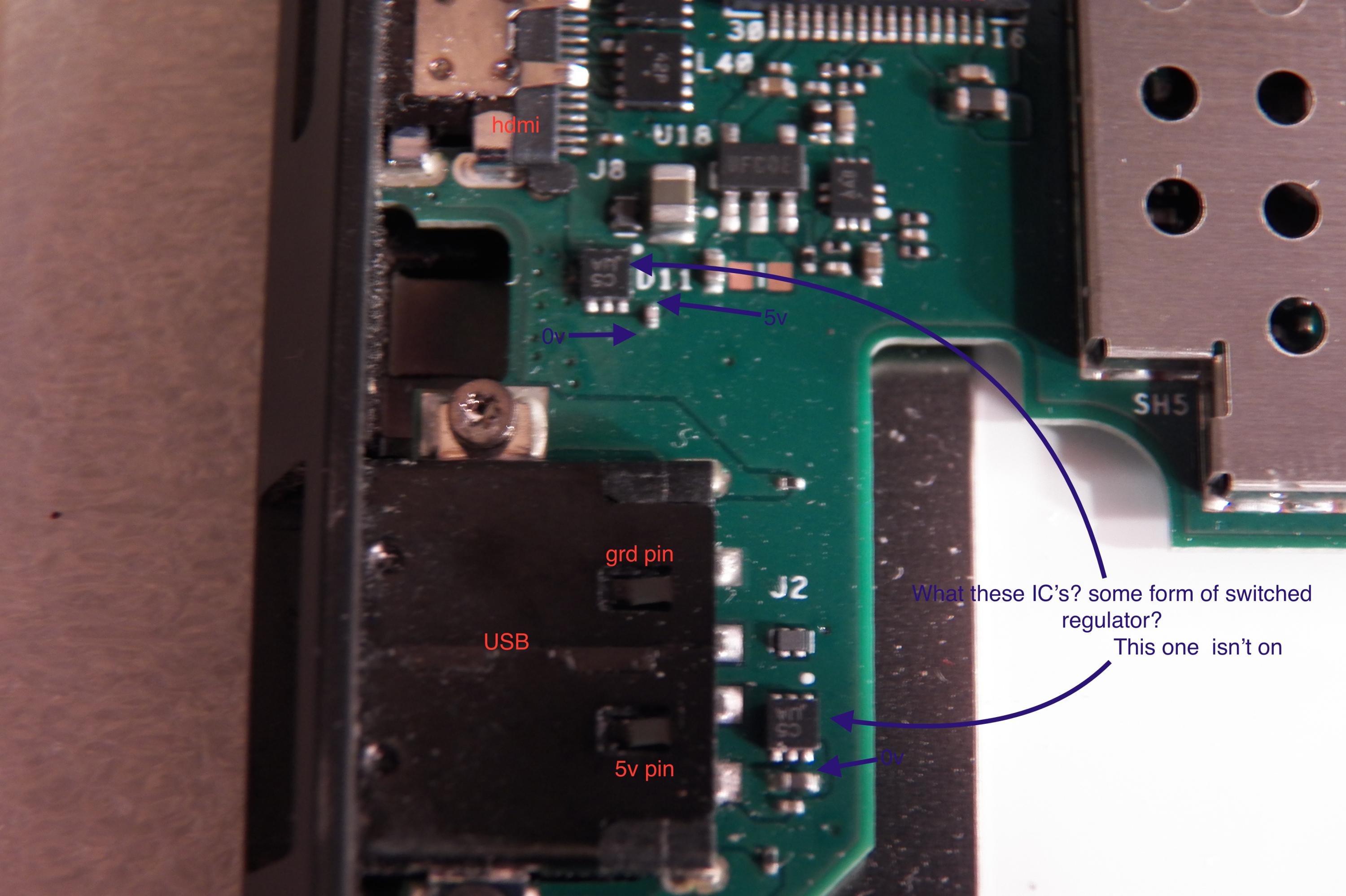

            Anyway, I haven't made much progress. As mentioned, was checking around things in the usb area since the usb isn't getting 5v when the red light is lit on the mother board.
            Attached is a photo of the area. The IC controlling 5v to the hdmi area / connector has 5v out while the one for the usb has 0v. Not sure what the IC C5UA is... some sort of switched power regulator?

              Re: Microsoft Surface RT 32G does not power up
              this is the right way you have chosen to discover the problem: finding the voltage rails which are missing.
              the 5v line probably has a control signal that allows it to flow toward the USB port. So, the missing 5v on the USB port may be due to lack of the control signal. that means C5UA may be healthy but does not receive the correct control signal.
              I guess the problem originates from a big IC in the middle area of the mainboard.

                can't find what the "c5ua" device is to see if I could locate a spec sheet ... :-( However, playing with powering, I observed some "interesting events" with the little red light on the motherboard. Basically, if you "tap" the power button ("one press"), the light comes on immediately and stays on "forever" (a very long time... over night if plugged in). If it is on with just the battery, it stay on for a long time... but eventually runs the battery down to about 7v and turns off sometimes during that time.
                If you hold the power button for 10 seconds ish, it turns off the light which appears to be a "shutdown mode". With the light on, I let the tablet sit for a bit to see if I could detect any heating to indicate something was running... nada, nothing hot anywhere.
                Then while I was pushing on the "cans" (emi covers of the motherboard), I could cause the red light to come on and also turnoff. I could isolate a bit of the "sensitive can area" in a few areas versus areas which did nothing. Maybe a possible poor connection some where or maybe a cracked track. The press was flexing the motherboard a bit also.

                        good news. After some more careful looking and strategic prying, I was able to remove the can covers. the bad / good news is I don't see any obvious issues (marks, components, track damage). No obvious labelled points that would help direct investigation without a schematic. :-(

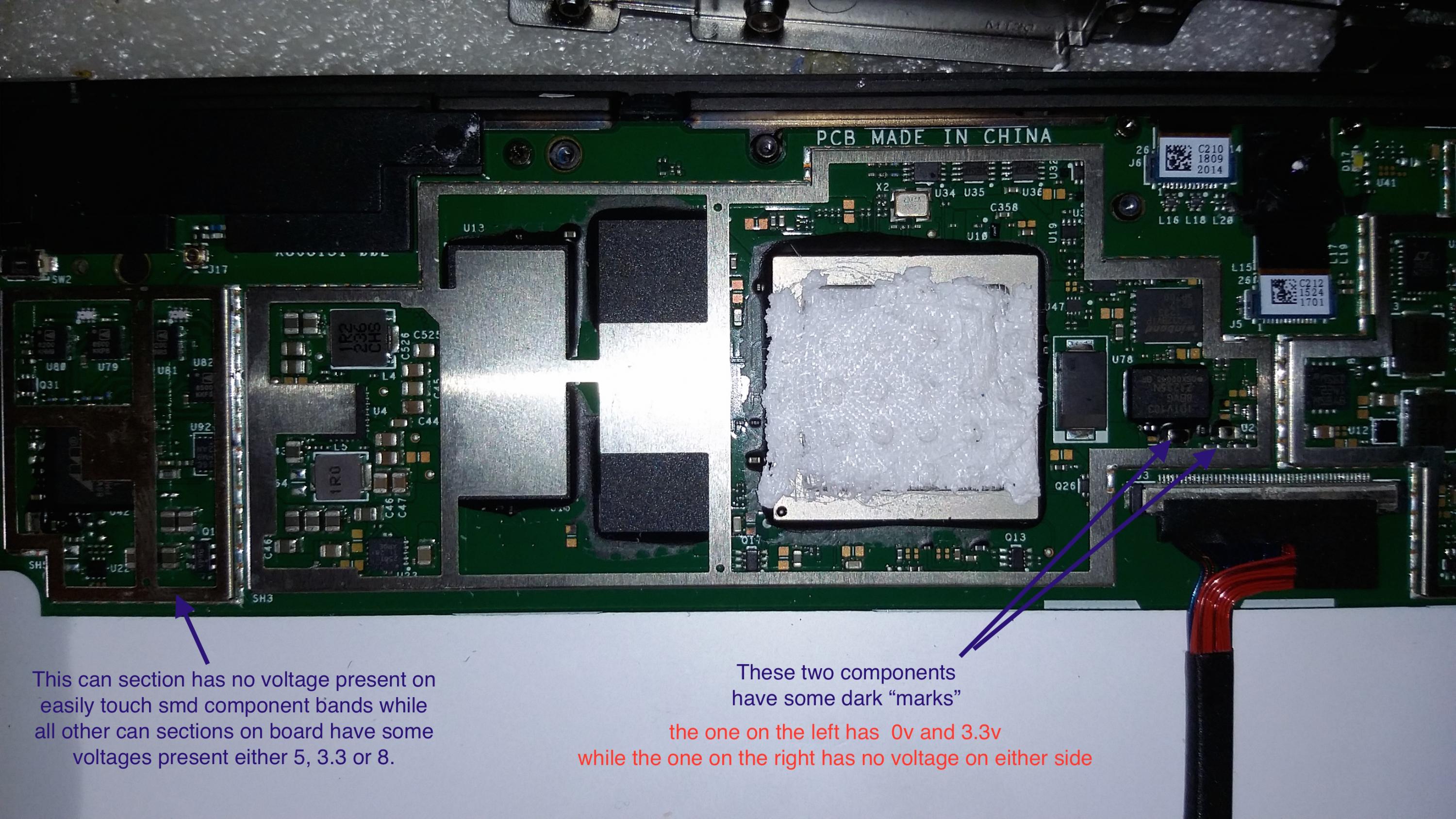

                          attached is a picture of the "left side" of the motherboard (end toward the ethernet and ac adapter connector....both just outside of the picture).
                          closer look appears to show a potential issue with two components associated with the "can section" of the main processor (I think). One of the components in question has no voltage on either side (label could indicate some sort of diode).
                          Further the "can section" on the far left has no voltages present on any "touchable" smd contact points. Without a schematic, not much else come to mind at this point.

                            It appears that the components that I was looking at in the previous post are probably ok as the "markings" are probably some form of "component paint". So I need to look around more.
                            The "can area" that has little / no voltages is the wireless connectivity area. I guess that may be valid if wireless is turnoff.... maybe.

                              I semi "threw in the towel" and picked up a used MB. The replacement powers up fine and the tablet is functional. Overall, it probably isn't worth the "investment" as MS abandoned this product but some learning is better than nothing and saving a compute device from the trash for a "few more days" gives some good feelings.
                              In terms of the little red light on the MB. My findings are the light goes solid with power up, after a few seconds (maybe 4-5), it starts to flash as the operating system boots up, than after another 4-5 seconds the screen lights up and the system begins running. Its too bad that MS didn't see fit to provide some form of light indicate externally so that a user could at least tell the system is trying to start / has some form of powering.... all to save a few pennies.
