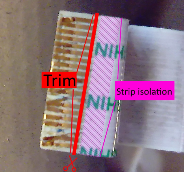

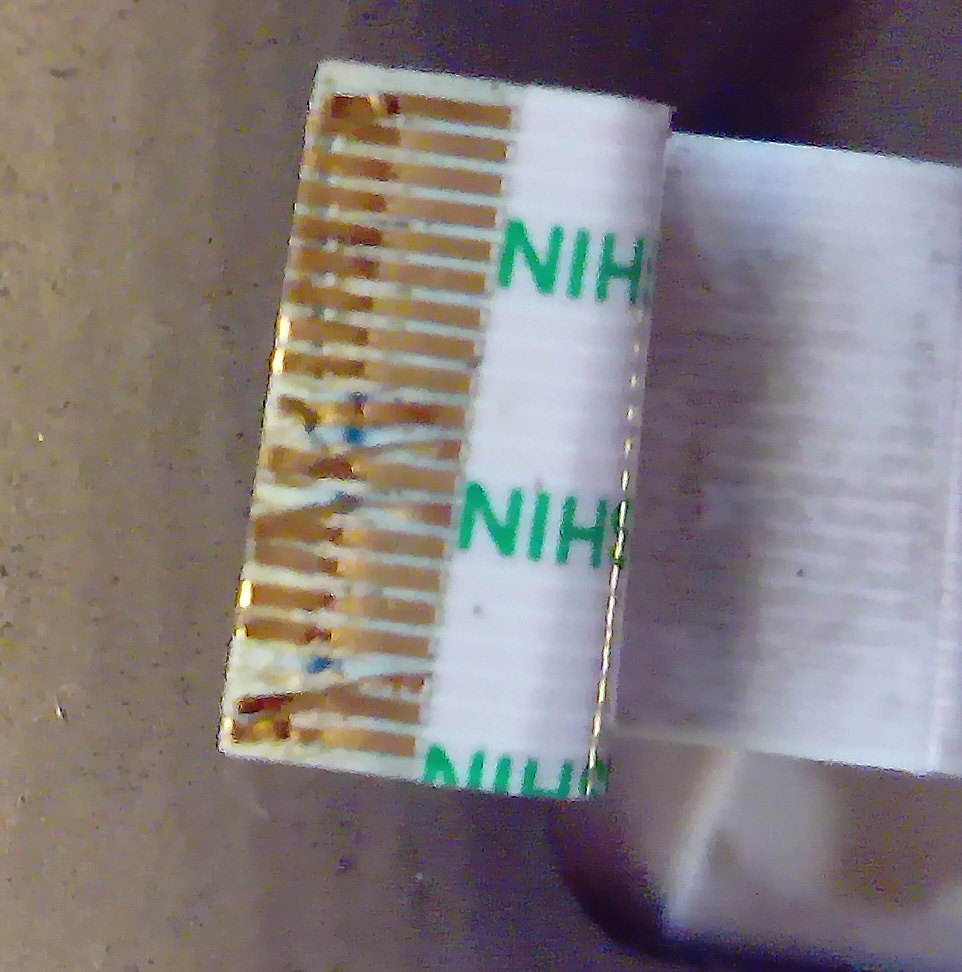

    Hello people, this is my first post. I am completely amateur in this field, but I am trying to fixing this and that.
    I have few old pcs running win xp and this samsung is great little device among them. but, I tried to fix power jack and managed to run it for a few minutes. after that laptop was dead, again. trying to find what the heck is a problem now, disassembling it, i found, also, this additional problem:
    pins on flat cable was "unglued"... strange but, this is what it is. anything I can do with them, or to wait a month for a aliexpress 20pin flat cable to arrive....
    I thought to use microscope and carefully glue them back. also thought to cut end by around 1-2 millimeters after that.
    thank you.

    Re: Samsung Q1 - display flat cable "unglued" pins
    https://www.youtube.com/watch?v=SNOzbpfSpec
        Originally posted by lijs
        i will try lijs because i do not have hot air gun. that was my thought, but as i saw stripping can be very tricky. anyway, nothing to lose. thank you people!
          Digikey also carries these FFC/FPC cables https://www.digikey.ca/products/en/c...per-cables/457
