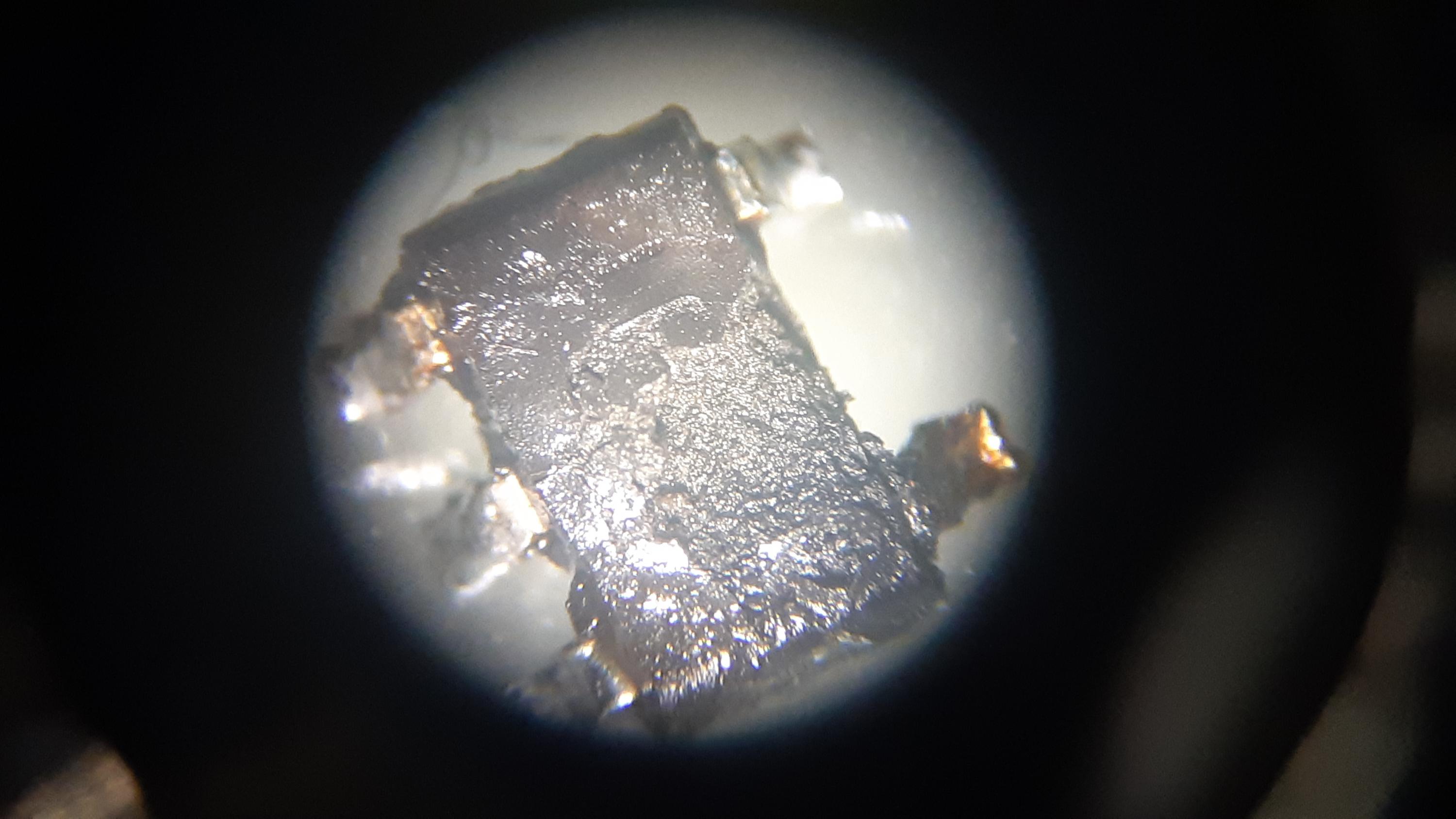

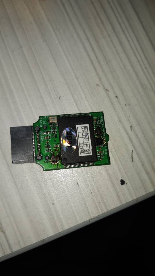

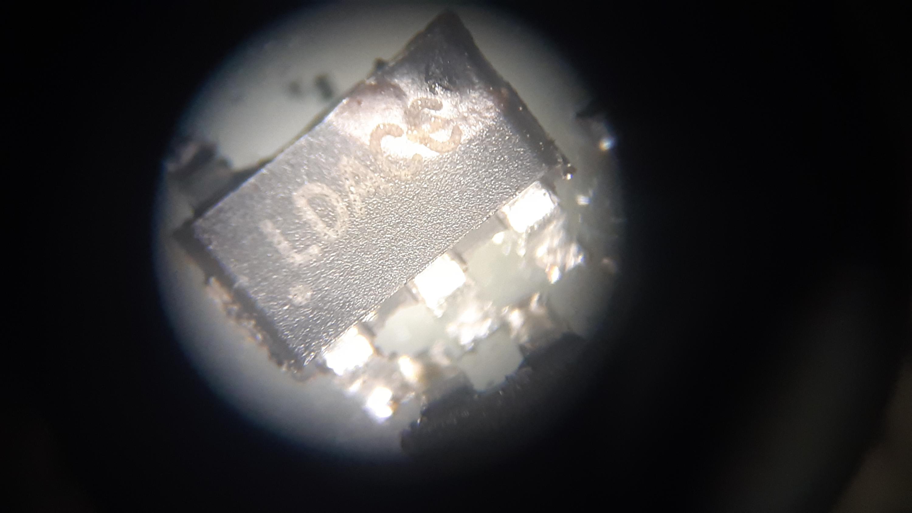

    Hi . I have an ssd kingspec 16gb. It works with 5v but accidentally supplied with 12v. I am looking for a smd part which marking code is LDACC. Can you help me find this one to replace them. They are three burned.

    It could be a silergy SY8088

      I agree, SY8088, LD, A=year,C=week,C=lot code

        oh my god. thank you very much..
