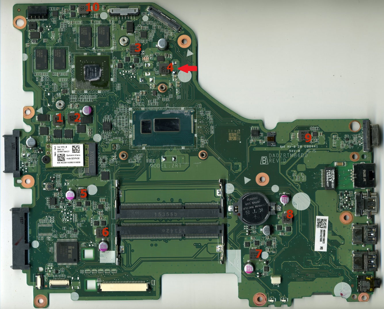

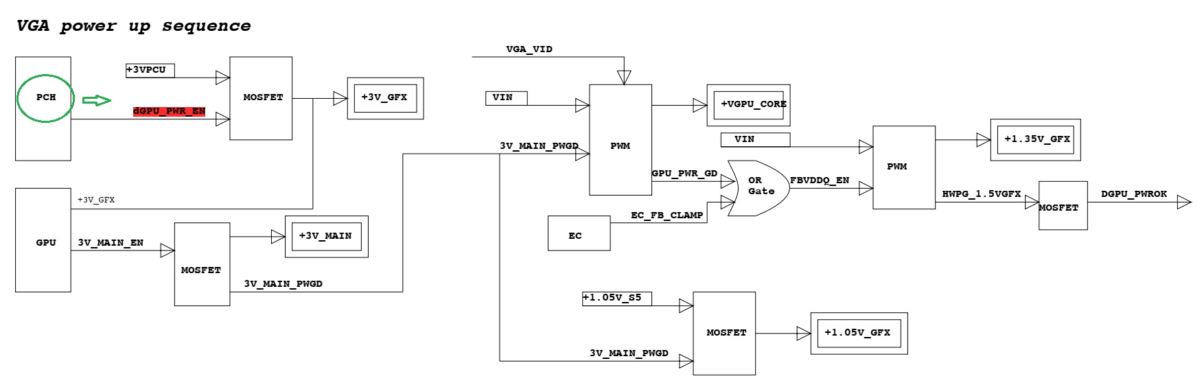

    i working in this board, DA0ZRTMB6D0 REV D
    i checked all voltage, is ok except GFX voltage.
    but i dont have video output, i have a good question,
    i checked VCC_Core , is 1.7v but cpu is cold.
    What does it mean? cpu is dead ?
    1 - 0V
    2 - 0V
    3 - 0V
    4 - 1,7V
    5 - 1.06V
    6 - 1,3V
    7 - 5V
    8 - 3,3V
    9 - 1,5V
    10 - 2,7V
    • 20888

    • mcplslg123
      • Jun 2015
      • 7262
      • india
      Re: acer +vcc_core and No CPU heat
      1 & 2 is for graphics power and 3 is perhaps PCH Power. One thing is for sure, your graphics chip is not initialised and hence no gfx core(as its discrete mb). You can try removing coils 1 & 2 and see if gfx core comes up.

        • kokono
          • Jun 2018
          • 203
          Originally posted by SMDFlea
          Theres another thread with the same problem,maybe it`ll help . https://www.badcaps.net/forum/showthread.php?t=74562
          But this topic finished without result
          NO, 1,2 and 3 all is for GFX
          number 3 is 1.5v_GFX

                " NO, 1,2 and 3 all is for GFX "-What do you mean by that?? i already told you coil 1 & 2 is for gfx power and you need to find out why graphics not getting power without which you wont have gfx core enabled on a discrete platform.

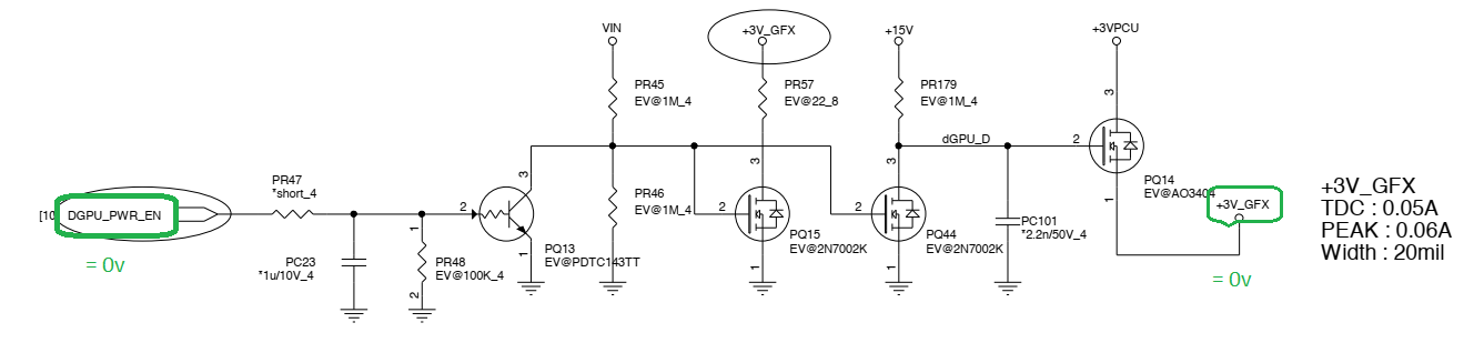

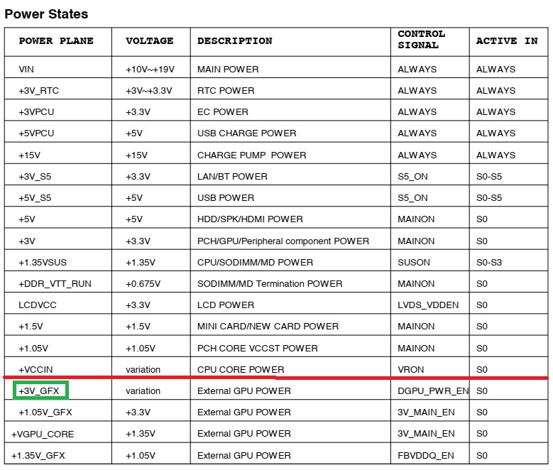

                • kokono
                  • Jun 2018
                  • 203
                  i attached power states, i have all voltage until +VCCIN( cpu core). next level ist +3v_GFX . i checked DGPU_PWR_EN . is null
                  So i think is normal that dont have GFX core voltage.
                  PCH send DGPU_PWR_EN signal . So I have to draw a conclusion, that PCH dont work ???
                  in addition, i read in another forum that ,in first dont need GFX start
                  In this disc you have 2 graphics, only one will be powered -none +VGPU_CORE in this state is correct.
                  Voltage + 1.5V_GFX appears only during the POST procedure
                  • piernov
                    • Jan 2016
                    • 4435
                    • France
                    If BIOS doesn't POST, graphics voltage won't come up. Wrote that in the other thread as well.

                      Anyone say something to measure?
                      • Techtiger
                        • Oct 2014
                        • 1602
                        • france
                        Yes PCH is not responding check SIO pin 78 PCh PWROK ? SYS RESET ? EC PWROK ?

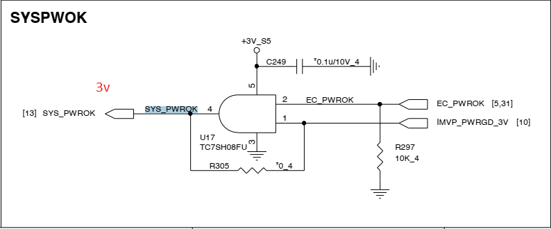

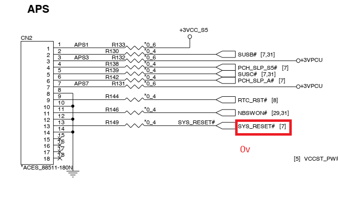

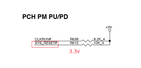

                        • kokono
                          • Jun 2018
                          • 203
                          pin 78=3.3v
                          EC PWROK =3.3v
                          SYS RESET is strange
                          please check attach
                          • Techtiger
                            • Oct 2014
                            • 1602
                            • france
                            pin 78=3.3v
                            what is the resestence to GND on coil 1 2 3 with no voltage did you try to remove one PAD of coil 1 2 to see if voltage is coming back (mcplslg123) have ask you ! may be a BIOS with out Oscilloscope it's hard to say

                                • kokono
                                  • Jun 2018
                                  • 203

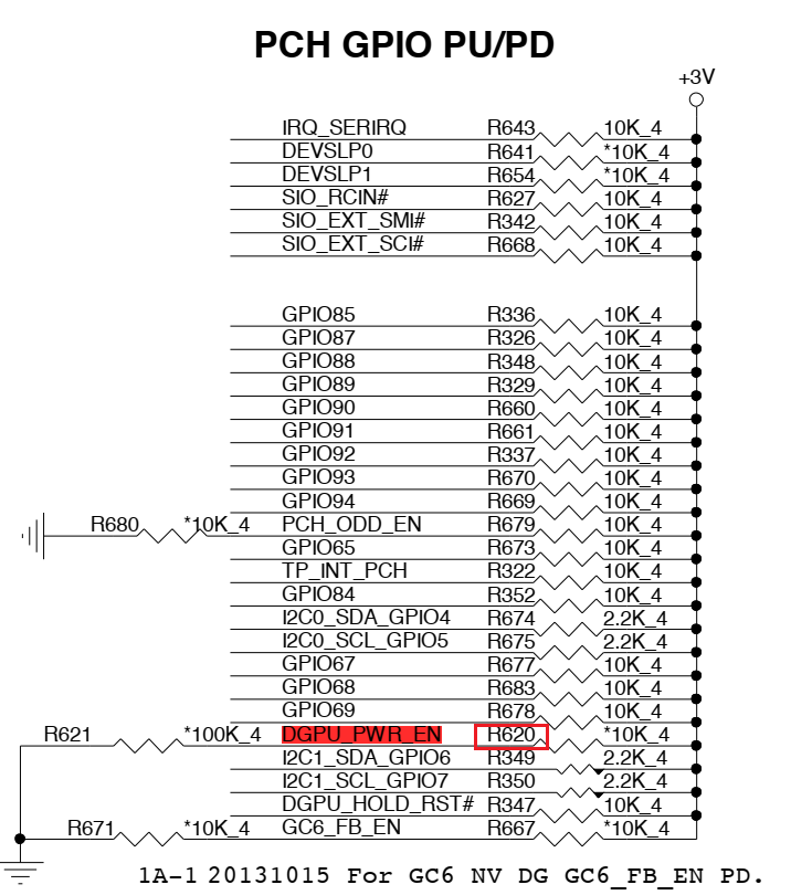

                                  i asked you to remove coil 1 &2 'coz of this very reason that you wont have +3v gfx. It might be so 'coz of bad graphics chip also. Thats why asked you to avoid graphics power circuit by removing those 2 coils and see if anything changes. have seen , that on many-many discrete mobo's. Btw, its your choice.
                                  Thx for suggestion,i tested another things
                                  i pullup "DGPU_PWR_EN" with R620 ,and now i have 1.5v in PL10(Coil 3) and about 0.9v in PL6 and PL7(Coil 1&2) , and Graphic chip Warmed up .So i think chip graphic and all voltage for chip is ok and working.
                                  But this job is for PCH , maybe i have a short smd resistor or PCH integrated dont answer
                                  it is strange, Coil4 have 1.7 volt but cpu not warm(very low)
                                  • kokono
                                    • Jun 2018
                                    • 203
                                    Also i checked SYS_PWROK is 3v
                                    So EC_PWROK and IMVP_PWRGD_3V is 3v
                                    • mcplslg123
                                      • Jun 2015
                                      • 7262
                                      • india
                                      Yes, that proves graphics chip is fine.
