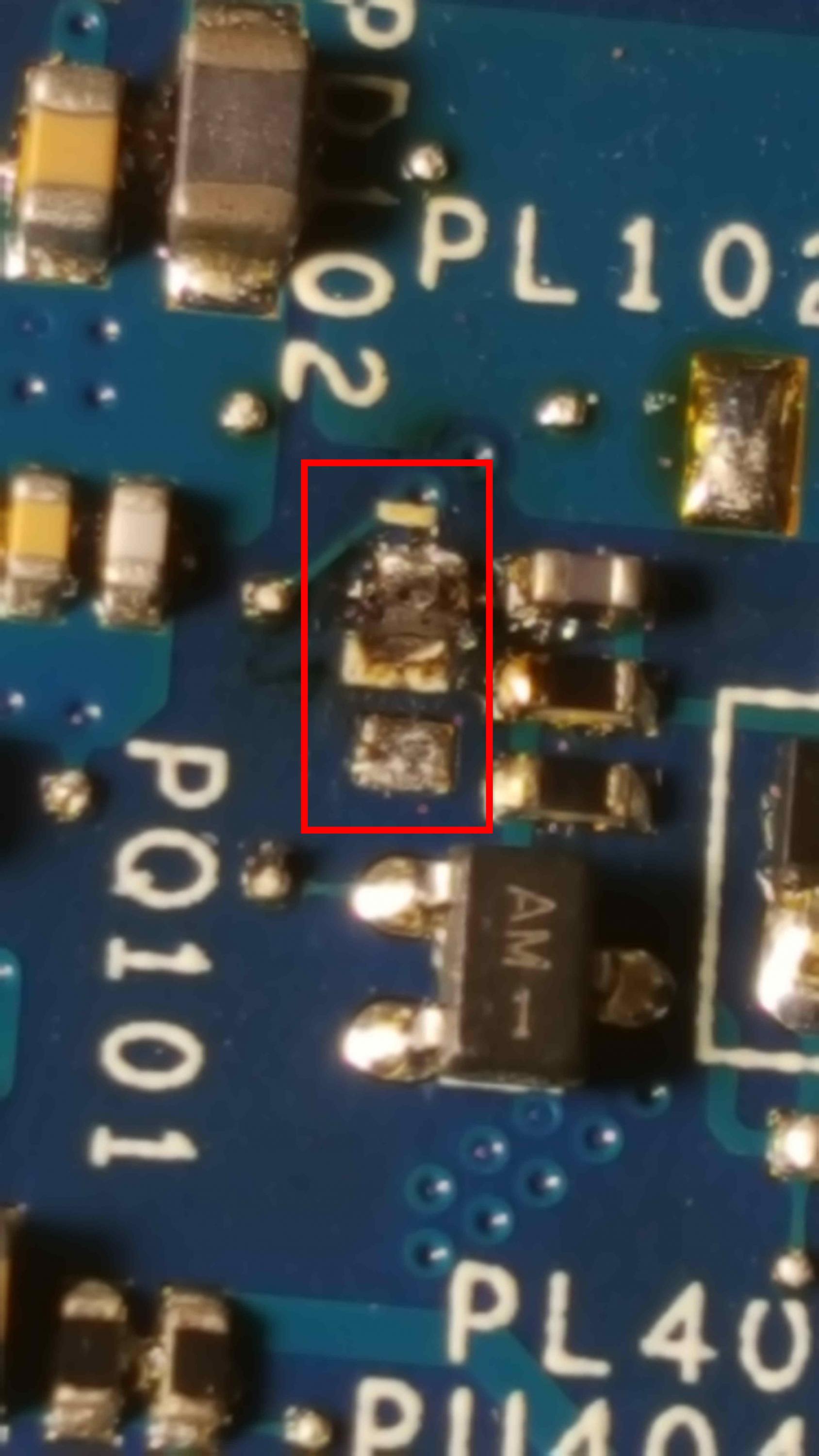

    Battery in IDLE state.

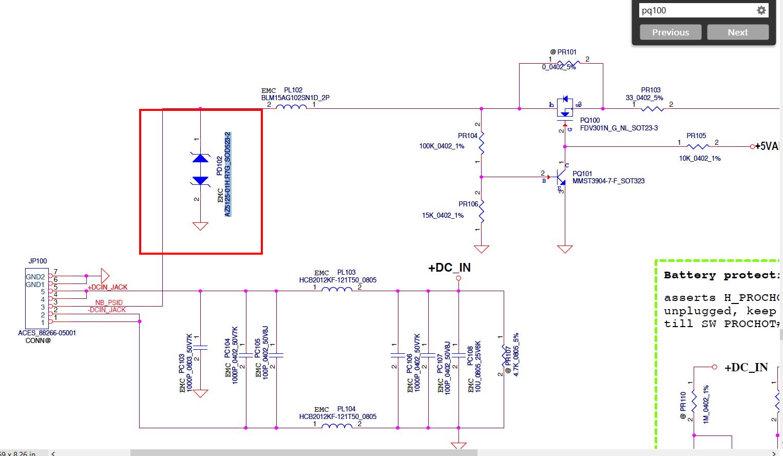

    On startup (f5) : adapter not original or with problems. I found a component, AZ5125-01H totally burned, it's a esd transient protection but I don't have the replacement. On some asus board, this type of component is present on boardview but not in place onboard so I think I can remove it ?
    • 21208
    Re: Dell xps 13 9343 charge in idle esd protection
    It did its job,it blew because PSID ,middle ID pin got shorted with 19V .It will work without it,at your own risk.I`d replace it though
      You confirmed what I thought, thanks
